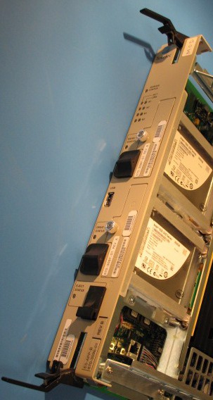

  1. While holding the I/E interlock and lever, pull the levers (2) away from the card until they are parallel to the floor.
    Figure 5-3 illustrates the angle of the interlocks and levers just before inserting E5-APP-B Card into the EAGLE shelf.
    Figure 5-3 E5-APP-B Card UNLOCKED

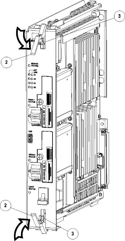

  3. Push in the top and bottom inject/eject clamps (see Figure 5-4).
    Figure 5-4 E5-APP-B Card Inject Levers
    This locks the card in place and ensures a strong connection with the pins on the target shelf backplane.

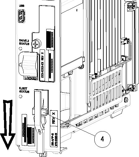

  4. Slide the E5-APP-B Ejector switch (4) down to the LOCKED position (see Figure 5-5).
    When the Ejector switch goes from UNLOCKED to LOCKED, the E5-APP-B Eject Status LED blinks red as the E5-MASP card goes online.
    Figure 5-5 E5-APP-B Card Inject Hardware Switch, LOCKED
  5. WAIT for the E5-APP-B Eject Status LED to go from blinking red to off.
