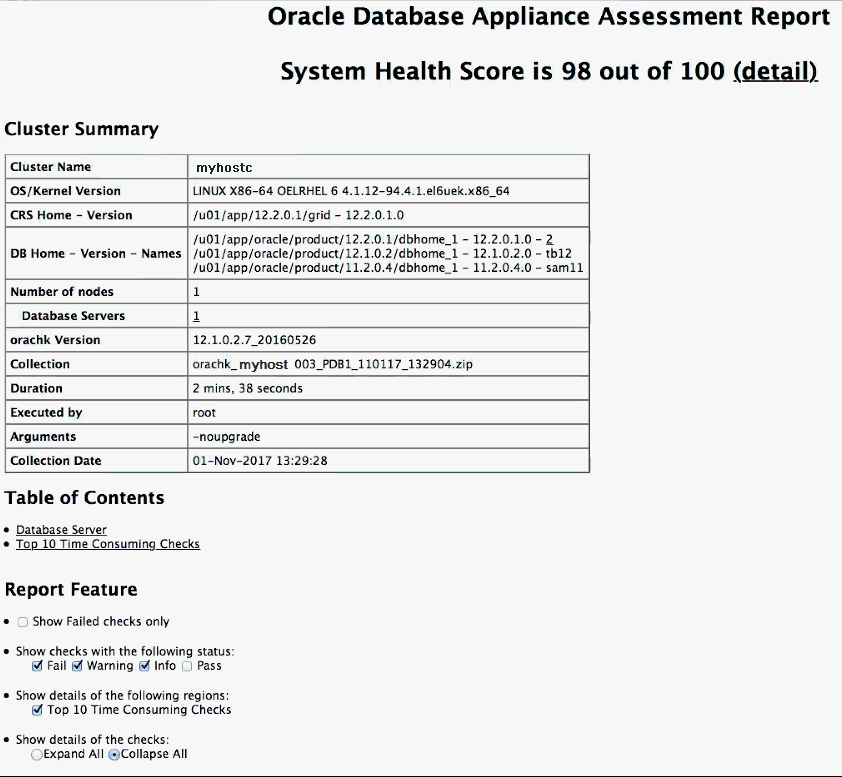

ORAchk Health Check Tool
Use the ORAchk Health Check Tool to audit configuration settings and check system health.
The ORAchk utility performs proactive heath checks for the Oracle software stack and scans for known problems.
The ORAchk Configuration Audit Tool audits important configuration settings for Oracle RAC two-node deployments in the following categories:
  • Operating system kernel parameters and packages
  • RDBMS
  • Database parameters, and other database configuration settings
  • Oracle Grid Infrastructure, which includes Oracle Clusterware and Oracle Automatic Storage Management
ORAchk is aware of the entire system. It checks the configuration to indicate if best practices are being followed.
See Also:
For more information about ORAchk, see My Oracle Support note 1268927.2, "ORAchk Health Checks for the Oracle Stack" at https://support.oracle.com/CSP/main/article?cmd=show&type=NOT&id=1268927.2
  1. Open the command-line interface as root.
  2. Navigate to the ORAchk tool in the /suptools directory.
    /u01/app/12.2.0.1/grid/suptools/orachk
  3. Run the utility.
    ./orachk
    When all checks are finished, a detailed report is available. The output displays the location of the report in an HTML format and the location of a zip file if you want to upload the report.
  4. Review the Oracle Database Appliance Assessment Report and system health and troubleshoot any issues that are identified.
    The report includes a summary and filters that enable you to focus on specific areas. For example, you can choose the filter to show failed checks only, show checks with a Fail, Warning, Info, or Pass status, or any combination.
