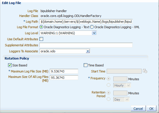

BI Publisher writes diagnostic log files in the Oracle Diagnostic Logging (ODL) format.
Log file naming and the format of the contents of log files conform to an Oracle standard. You can view log files by using the WLST displayLogs command, or you can download log files to your local client and view them using another tool (for example a text editor, or another file viewing utility).
Log files are created and edited using Oracle Fusion Middleware Control. By default, after installation, the bipublisher-handler log is created. You can configure this log file or create a new logger.
Each log file message category is set to a specific default value between 1-32, and only messages with a level less or equal to the log level are logged.

A log file must contain a consistent format.
However, since there can be multiple formats, you can change the format used in a log file. When you change the format used in a log file, and the new format differs from the current log file's format, a new log file is created. For example, a log file that contains ODL-XML, always contains XML, and is never mixed with text.
Configure the log file format in the Edit Log File dialog. See Configuring Log Files. The format can by Text or XML.
Use Oracle Fusion Middleware Control to configure BI Publisher log files.

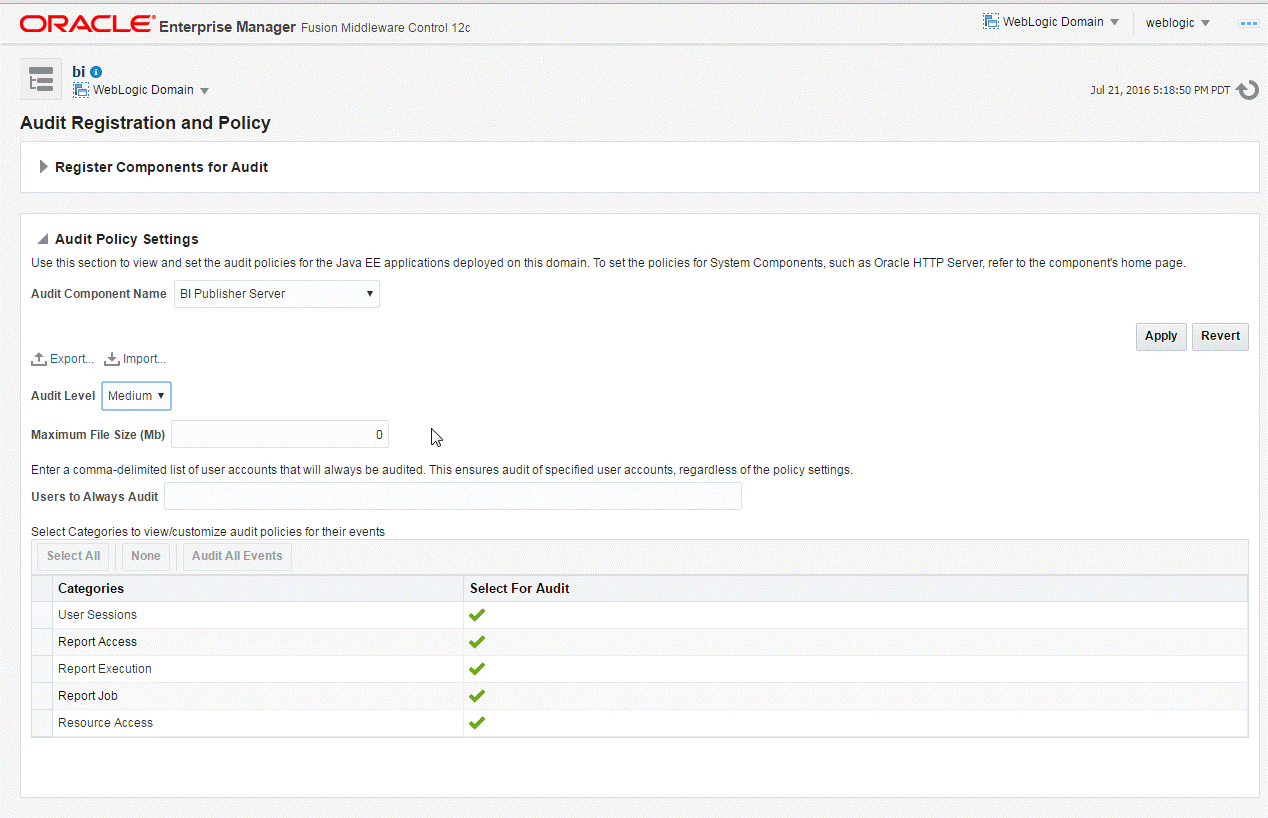

You can turn on monitoring and auditing for the BI Publisher application.
Configure Audit Policy settings in Oracle Fusion Middleware Control.
To configure the audit policy settings
Typically, set the Audit Level to Medium.
To customize the audit level for each event, select Custom from the Audit Level list. This setting enables you to set the audit level for each event and apply filters. Select a category (User Session, Report Access, Report Execution, Report Job, or Report Access) to view the available events.
The events that are audited for the BI Publisher server are:
