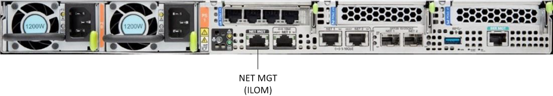

    Figure 1-15 Connecting to ILOM over the Network
    This image displays the rear view of the X7-2 and labels the interfaces, per the image title.
