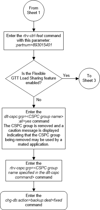

Figure 2-48 Remove a Concerned Signaling Point Code - Sheet 1 of 3

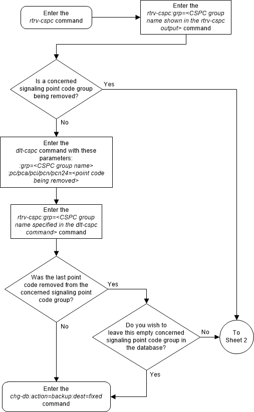

Figure 2-49 Remove a Concerned Signaling Point Code - Sheet 2 of 3

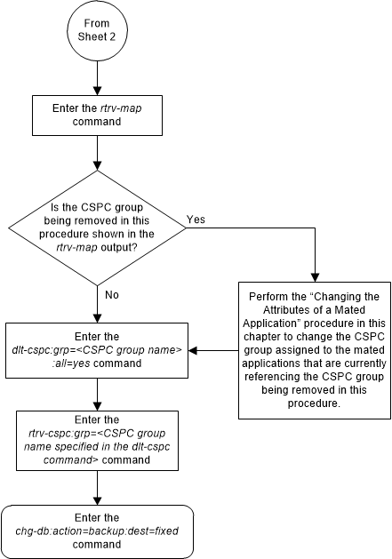

Figure 2-50 Remove a Concerned Signaling Point Code - Sheet 3 of 3
