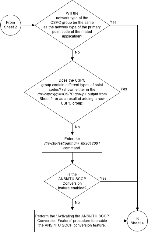

Figure 2-106 Change the Attributes of a Mated Application - Sheet 1 of 6

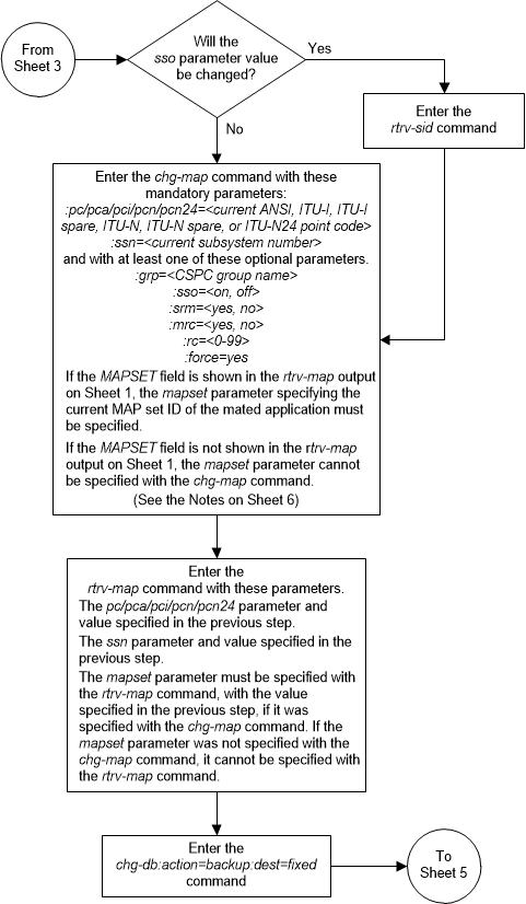

Figure 2-107 Change the Attributes of a Mated Application - Sheet 2 of 6

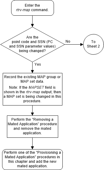

Figure 2-108 Change the Attributes of a Mated Application - Sheet 3 of 6

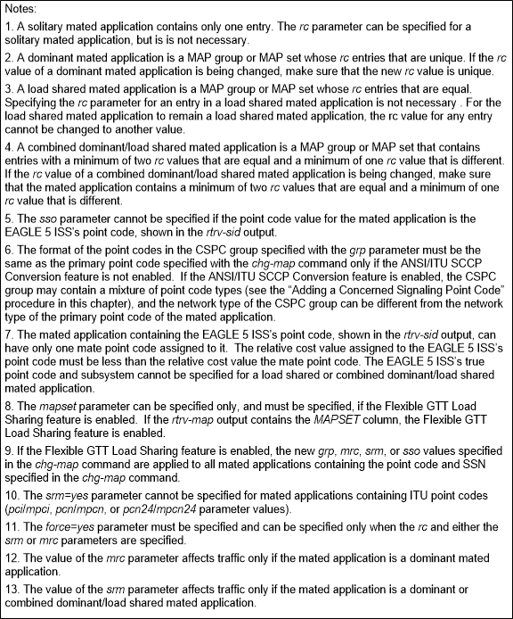

Figure 2-109 Change the Attributes of a Mated Application - Sheet 4 of 6

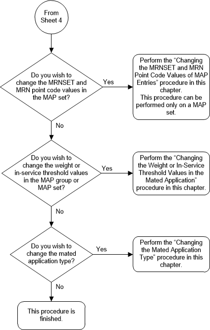

Figure 2-110 Change the Attributes of a Mated Application - Sheet 5 of 6

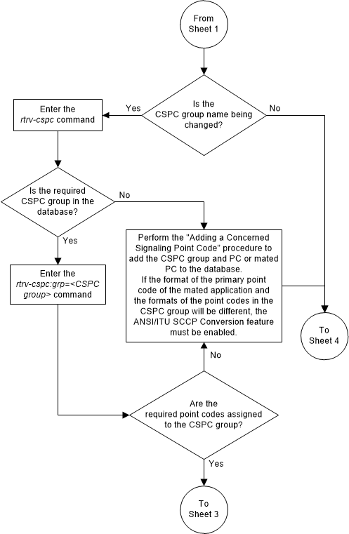

Figure 2-111 Change the Attributes of a Mated Application - Sheet 6 of 6
