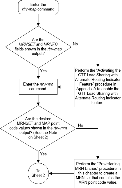

  1. Display the mated applications in the database using the rtrv-map command. This is an example of the possible output.

    If the MRNSET and MRNPC columns are not shown in the rtrv-map output, the GTT Load Sharing with Alternate Routing Indicator feature is not enabled. Perform Activating the GTT Load Sharing with Alternate Routing Indicator Feature to enable the GTT Load Sharing with Alternate Routing Indicator feature. After Activating the GTT Load Sharing with Alternate Routing Indicator Feature has been performed, continue the procedure with 2.
    If the MRNSET and MRNPC columns are shown in the rtrv-map output, the GTT Load Sharing with Alternate Routing Indicator feature is enabled. Continue the procedure with 2.
  2. The MRN point code value must be assigned to an MRN set. The MRN set must be shown in the rtrv-mrn output. Display the MRN sets by entering the rtrv-mrn command. This is an example of the possible output.

    If the MRN set that you wish to use, containing the desired point code and subsystem number, is shown in the rtrv-mrn output, continue the procedure with 3.
    The network type of the pc/pca/pci/pcn/pcn24 and mrnpc/mrnpca/mrnpci/mrnpcn/mrnpcn24 parameter values must be the same, as shown in Table 2-54.
    If the MRN set that you wish to use is not shown in the rtrv-mrn output, add the required MRN set by performing Provisioning MRN Entries.
    After the MRN set has been added, continue the procedure with 3.

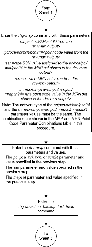

  3. Change the MRNSET and MRN point code values in the MAP set by entering the chg-map command with the mrnset and mrnpc/mrnpca/mrnpci/mrnpcn/mrnpcn24 parameters.
    For this example, enter this command.
    chg-map:mapset=7:pca=002-002-007:ssn=50:mrnset=1:mrnpca=007-007-007
    When the chg-map command has successfully completed, this message should appear.
    rlghncxa03w 09-02-07  11:44:13  GMT  EAGLE5 40.1.0
    CHG-MAP:  MASP A - COMPLTD
  4. Verify the changes using the rtrv-map command with the point code (pca/pci/pcn/pcn24), ssn, and mapset values specified in 3.
    rtrv-map:mapset=7:pca=002-002-007:ssn=50

  5. Backup the new changes using the chg-db:action=backup:dest=fixed command. These messages should appear, the active Maintenance and Administration Subsystem Processor (MASP) appears first.
    BACKUP (FIXED) : MASP A - Backup starts on active MASP.
    BACKUP (FIXED) : MASP A - Backup on active MASP to fixed disk complete.
    BACKUP (FIXED) : MASP A - Backup starts on standby MASP.
    BACKUP (FIXED) : MASP A - Backup on standby MASP to fixed disk complete.

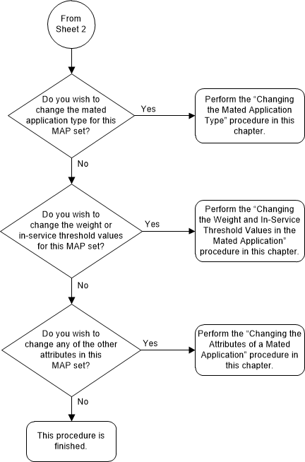

    If you do not wish to change the mated application type, the weights or in-service thresholds of the mated application, or other attributes of the mated application, this procedure is finished.
    If you wish to change the mated application type, the weights or in-service thresholds of the mated application, or other attributes of the mated application, perform these procedures as applicable.
Figure 2-126 Change the MRNSET and MRN Point Code Values of MAP Entries - Sheet 1 of 3
Figure 2-127 Change the MRNSET and MRN Point Code Values of MAP Entries - Sheet 2 of 3
Figure 2-128 Change the MRNSET and MRN Point Code Values of MAP Entries - Sheet 3 of 3
