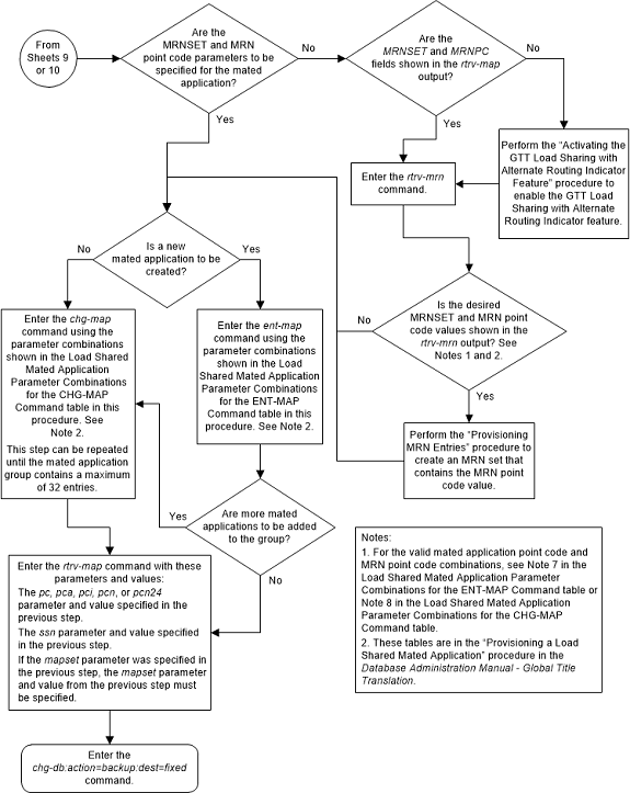

  1. Display the mated applications in the database using the rtrv-map command.
    This is an example of the possible output.

    If any of the following items are not shown in the rtrv-map output, then the feature corresponding to these items is not enabled, or turned on if required.
    • The MAPSET field - the Flexible GTT Load Sharing feature is not enabled.
    • The MRNSET and MRNPC fields - the GTT Load Sharing with Alternate Routing Indicator feature is not enabled.
    • The WT, %WT, THR columns - the Weighted GTT Load Sharing feature is not enabled and turned on.
    If the maximum number of mated applications shown in the rtrv-map output in 1 is 1024, 2000, or 3000, continue the procedure with 3.
  2. If the maximum number of mated applications shown in the rtrv-map output in 1 is 36000, the Flexible GTT Load Sharing feature is enabled.
    Although the rtrv-map output shows there can be 36000 entries, a maximum of 1024, 2000, or 3000 different point codes (depending on whether the XMAP Table Expansion feature is enabled for 2000 or 3000 mated applications) can be provisioned for mated applications. To verify the number of different point codes that can be provisioned for mated applications, enter the rtrv-tbl-capacity command. The following is an example of the possible output.

  8. If the MAPSET column is shown in the rtrv-map output in 1, the Flexible GTT Load Sharing feature is enabled. Continue the procedure with 9.
    If the MAPSET column is not shown in 1 and you do not wish to provision MAP sets in this procedure, continue the procedure with 9.
    If the MAPSET column is not shown in 1 and you wish to provision MAP sets in this procedure, perform the Activating the Flexible GTT Load Sharing Feature procedure to enable the Flexible GTT Load Sharing feature. After the Flexible GTT Load Sharing feature is enabled, continue the procedure with 9.
    If you do not wish to assign weight and in-service threshold values to the MAP entries in the MAP group or MAP set, continue the procedure with 10.
  9. If you wish to assign weight and in-service threshold values to the entries in the MAP group or MAP set, and the WT, %WT, and THR columns are shown in the rtrv-map output in 1, then the Weighted GTT Load Sharing feature is enabled and turned on.
    If the WT, %WT, and THR columns are not shown in the rtrv-map output in 1, perform the Activating the Weighted GTT Load Sharing Feature procedure to enable and turn on the Weighted GTT Load Sharing feature.
    If the Weighted GTT Load Sharing feature is enabled and turned on, or the Activating the Weighted GTT Load Sharing Feature procedure was performed in this step, continue this procedure by performing one of these steps.
    • If only one of the point codes that will be specified for the mated application is assigned to other mated applications, perform 10 for the new point code that is not assigned to other mated applications.
    • If the both point codes that will be specified for the mated application are point codes assigned to other mated applications, continue the procedure by performing one of these steps.
      • If the mrnset and mrnpc parameters will be specified for the mated application, continue the procedure with 13.
      • If the mrnset and mrnpc parameters will not be specified for the mated application, continue the procedure by performing one of these steps.
        • If a new mated application is being added, continue the procedure with 14.
        • If an entry is being added to an existing mated application, continue the procedure with 15.

    After the new point code has been added, skip 11 and 12, and perform one of the Adding a Route procedures in Database Administration - SS7 User's Guide and add the required route to the database. After the route has been added, continue the procedure by performing one of these steps.

    A proxy point code (a point code value is shown in the PPC column) cannot be assigned to the point code. If a proxy point code is shown in this step, choose another point code from the rtrv-dstn output in the previous step and repeat this step.
    After the new point code has been added, skip 12 and perform one of the Adding a Route procedures in Database Administration - SS7 User's Guide and add the required route to the database. After the route has been added, continue the procedure by performing one of these steps.

    If the point code is not shown in the rtrv-rte output, perform one of the Adding a Route procedures in Database Administration - SS7 User's Guide and add the required route to the database.
    Continue the procedure by performing one of these steps.
  13. The MRN point code value must be assigned to an MRN set. The MRN set must be shown in the rtrv-mrn output. Display the MRN sets by entering the rtrv-mrn command. This is an example of the possible output.

    The network type of the pc/pca/pci/pcn/pcn24 and mrnpc/mrnpca/mrnpci/mrnpcn/mrnpcn24 parameter values must be compatible, as shown in Note 7 in Table 2-46 or in Note 8 in Table 2-47.
    If the MRN set that you wish to use, containing the desired point code, is not shown in the rtrv-mrn output, add the required MRN set by performing the Provisioning MRN Entries procedure.
    If the MRN set that you wish to use is shown in the rtrv-mrn output, or the Provisioning MRN Entries procedure was performed in this step, continue the procedure by performing one of these steps.
  14. Add the mated application to the database using the ent-map command. Use Table 2-46 as a guide for the parameters and values that can be specified with the ent-map command.

    Repeat this step for all new entries being added to the existing mated application.
    If the Flexible GTT Load Sharing feature is not enabled, the mated application can contain a maximum of 128 entries.
    If the Flexible GTT Load Sharing feature is enabled, and the MAP set is not the default MAP set, the MAP set can contain a maximum of 128 entries.
    If the Flexible GTT Load Sharing feature is enabled, and the MAP set is the default MAP set, the default MAP set can contain multiple MAP groups. Each group in the default MAP set can contain a maximum of 128 point code and subsystem entries.
  16. Verify the changes using the rtrv-map command with the primary point code and subsystem specified in 14 and 15.
    If a new MAP set was created in 14, the mapset parameter should be specified with the rtrv-map command. The value for the mapset parameter should be the MAP set ID generated in 14.
    If the mated application was added to an existing MAP set in 15, the mapset parameter and value specified in 15 should be specified with the rtrv-map command.

Figure 2-79 Provision a Load Shared Mated Application - Sheet 1 of 11
Figure 2-80 Provision a Load Shared Mated Application - Sheet 2 of 11
Figure 2-81 Provision a Load Shared Mated Application - Sheet 3 of 11
Figure 2-82 Provision a Load Shared Mated Application - Sheet 4 of 11
Figure 2-83 Provision a Load Shared Mated Application - Sheet 5 of 11
Figure 2-84 Provision a Load Shared Mated Application - Sheet 6 of 11
Figure 2-85 Provision a Load Shared Mated Application - Sheet 7 of 11
Figure 2-86 Provision a Load Shared Mated Application - Sheet 8 of 11
Figure 2-87 Provision a Load Shared Mated Application - Sheet 9 of 11
Figure 2-88 Provision a Load Shared Mated Application - Sheet 10 of 11
Figure 2-89 Provision a Load Shared Mated Application - Sheet 11 of 11
