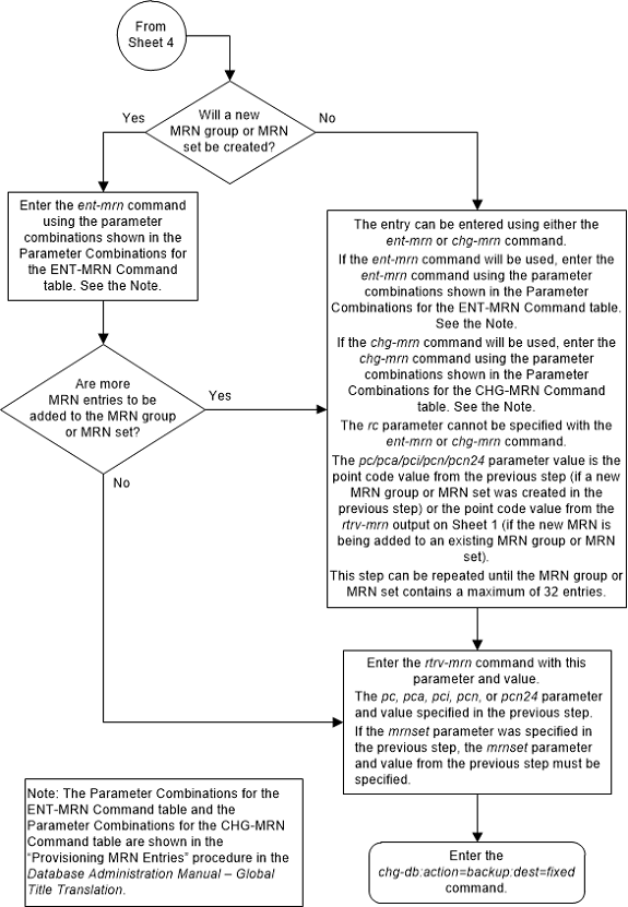

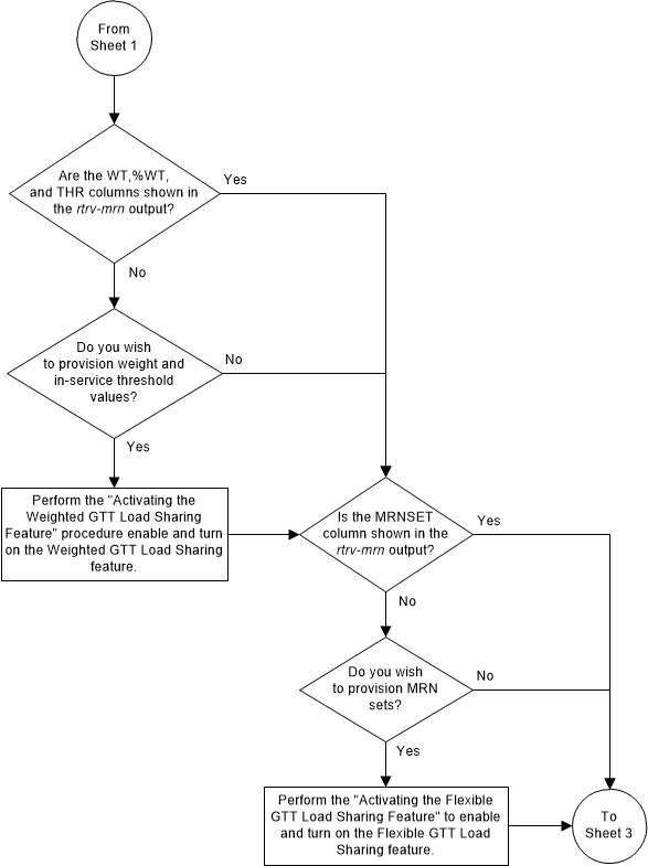

This procedure is used to provision an Mated Relay Node
(MRN) group or MRN set in the database or to add a point code to an existing
MRN group or MRN set for the Intermediate Global Title Load Sharing feature
using the
ent-mrn
and
chg-mrn
commands.
An MRN group or MRN set contains alternate point codes, up to 128, that are used for load sharing between multiple nodes when the EAGLE is performing intermediate global title translation. This load sharing is performed after intermediate global title translation is performed on the message. The point code in the message is changed to the selected point code in the MRN table. If the translated point code is not found in the MRN table, the translated point code in the message is not changed, the message is routed using route for the translated point code.
The
ent-mrn
and
chg-mrn
command uses these parameters.
:pc/pca/pci/pcn/pcn24
The point code in the message after intermediate global title translation has
been performed.
:rc
– The relative cost
value of point code in the message
:pc1/pca1/pci1/pcn1/pcn241
– The first alternate point
code value
:rc1
– The relative
cost value of the first alternate point code
:pc2/pca2/pci2/pcn2pcn242
– The second alternate point
code value
:rc2
– The relative
cost value of the second alternate point code
:pc3/pca3/pci3/pcn3/pcn243
– The third alternate point
code value
:rc3
– The relative
cost value of the third alternate point code
:pc4/pca4/pci4/pcn4/pcn244
– The fourth alternate point
code value
:rc4
– The relative
cost value of the fourth alternate point code
Refer to Chapter 2, Configuring Destination Tables in Database Administration - SS7 User's Guide for a definition of the point code types that are used on the EAGLE and for a definition of the different formats that can be used for ITU national point codes.:mrnset
– The MRN set
ID that the point codes are assigned to. This parameter can be specified only,
and must be specified, if the Flexible GTT Load Sharing feature is enabled. If
the Flexible GTT Load Sharing feature is enabled, the point code specified for
the global title translation must be assigned to the MRN set specified by this
parameter. The status of the Flexible GTT Load Sharing feature is shown in the
rtrv-ctrl-feat
output. To enable the
Flexible GTT Load Sharing feature, perform
Activating the Flexible GTT Load Sharing Feature.
The MRN set ID has one of three values:
dflt
– to assign the
MRN to the default MRN set.
new
– to assign the
MRN to a new MRN set. This value can be specified only with the
ent-mrn
command.
Refer to Provisioning an MRN Set for information on provisioning MRN sets.
:dfltwt
– The default
weight value. When this parameter is specified, the same weight value is
assigned to all entries specified in the
ent-mrn
command. The value of this
parameter is from 1 - 99. This parameter can be specified only with the
ent-mrn
command.
:wt
– The weight value
assigned to the
pc
/pca
/pci
/pcn
/pcn24
parameter
value. The value of this parameter is from 1 - 99.
:wt1
– The weight value
assigned to the
pc1
/pca1
/pci1
/pcn1
/pcn241
parameter
:wt2
– The weight value
assigned to the
pc2
/pca2
/pci2
/pcn2
/pcn242
parameter
:wt3
– The weight value
assigned to the
pc3
/pca3
/pci3
/pcn3
/pcn243
parameter
:wt4
– The weight value
assigned to the
pc4
/pca4
/pci4
/pcn4
/pcn244
parameter
value.
:thr
– The in-service
threshold assigned to the MRN group or MRN set. The in-service threshold is the
minimum percentage (from 1 - 100) of weight that must be available for an RC
group (a group of entries in the MRN group or MRN set that have the same RC
value assigned) to be considered available to carry traffic. If the percentage
of the available weight is less than the in-service threshold, then the entire
RC group is considered unavailable for traffic. If the percentage of the
available weight is equal to or greater than the in-service threshold, then the
RC group is considered available, and traffic can be sent to any available
entity in the RC group. The value of the
thr
parameter is assigned to all
entries in the MRN group or MRN set that have the same RC value that is
specified in the
ent-mrn
command. The
thr
parameter can be used in this
procedure only with the
ent-mrn
command.
Refer to Provisioning Weights and In-Service Thresholds for MRNs for information on provisioning MRN groups or MRN sets with weight and in-service threshold values.
The following parameters of the
chg-mrn
command cannot be used in this
procedure:
thr
grpwt
eswt
, and
force=yes
. These parameters can be
used with the
chg-mrn
command only when changing the
attributes of specific entries in an existing MRN group or MRN set, and not
when adding entries to an existing MRN group or MRN set. If you wish to change
specific entries in an existing MRN group or MRN set, perform either
Changing MRN Entries with the ESWT Parameter
or
Changing the Weight and Threshold Values of MRN Entries.

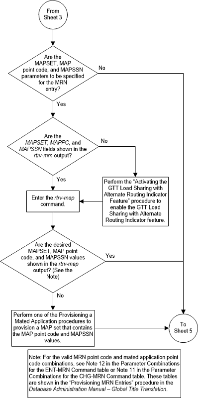

:mapset
– The MAP set
ID that is being assigned to the MRN. This is the MAP set from which alternate
routing indicator searches are performed.
:mappc/mappca/mappci/mappcn/mappcn24
– The point code
assigned to the
mapset
MRN set.
:mapssn
– The subsystem
number assigned to the point code in the MAP set that is being assigned to the
MRN.
The current values of the
mapset
and
mapssn
parameters are shown in the
rtrv-mrn
output only if the Flexible
GTT Load Sharing and the GTT Load Sharing with Alternate Routing Indicator
features are enabled.
The new values for the
mapset
and
mapssn
parameters must be shown in the
rtrv-map
output. If no values are
specified for the
mapset
and
mapssn
parameters when the
ent-mrn
command is entered, then no
values for these parameters are assigned to the MRN set. If no values are
specified for the
mapset
and
mapssn
parameters when the
chg-mrn
command is entered, then the
values for these parameters in the MRN set are not changed.
To add a new MRN group, the group must be provisioned in
the database with the
ent-mrn
command, specifying up to four
alternate point codes. If more point codes are to be added to the MRN group,
either the
ent-mrn
or
chg-mrn
command to add the additional
point codes to the MRN group. A maximum of 128 point codes can be assigned to
an MRN group. If the Flexible GTT Load Sharing feature is enabled, refer to
Provisioning
A point code and
rc
value must be entered as a pair.
For example, the
pc3
and
rc3
parameters must be specified
together in the
ent-mrn
or
chg-mrn
commands if the alternate
point code value is being specified.
The point codes specified with the
ent-mrn
or
chg-mrn
commands can be in only one
Provisioning
an MRN Set for information on provisioning point codes in MRN sets.
The relative cost parameters (rc
/rc1
/rc2
/rc3
/rc4
) determine how the global title translation load is
to be shared among the alternate point codes. There are three types of load
sharing that can be performed: dominant, load shared, or combined dominant/load
shared.
All the point codes in a dominant MRN group or MRN set have different relative cost values. The translated point code in the message is the preferred point code that the message is routed on. The relative cost value assigned to the preferred point code does not have to be the lowest value in the MRN group or MRN set. All traffic is routed to the preferred point code, if it is available. If the preferred point code becomes unavailable, the traffic is routed to highest priority alternate point code that is available. When the preferred point code becomes available again, the traffic is then routed back to the preferred point code. For example, the MRN table contains the following entries.
PC RC 005-005-005 10 006-001-001 20 006-001-002 30 006-001-003 40 006-001-004 50 006-001-005 60 006-001-006 70 006-001-007 80
If the preferred point code is 006-001-001 and it becomes unavailable, the traffic will be routed to point code 006-001-002.
All the point codes in a load shared MRN group or MRN set have the same relative cost value. Traffic is shared equally between the point codes in this MRN group or MRN set.
A combined dominant/load shared MRN group or MRN set is a combination of the dominant and load sharing MRN groups or MRN sets. A combined dominant/load shared MRN group or MRN set must contain a minimum of two entries with the same relative cost value and a minimum of one entry with a different relative cost value. Traffic is routed to the point code or point codes with the lowest relative cost value, where the relative cost value is considered the relative cost associated with the point code of the global title translation and not the actual lowest relative cost in the MRN set. If more than one point code has the lowest relative cost value, the traffic is shared between these point codes. If the point code or point codes with the lowest relative cost value become unavailable, traffic is routed to the point code or point codes with the next higher relative cost value. If more than one point code has this relative cost value, the traffic is shared between these point codes. For example, the MRN table contains the following entries.
PC RC 005-005-005 10 006-001-001 10 006-001-002 10 006-001-003 20 006-001-004 20 006-001-005 20 006-001-006 20 006-001-007 20
If the preferred point code is 006-001-001, the traffic is shared equally between point codes 005-005-005, 006-001-001, and 006-001-002. If point codes 005-005-005, 006-001-001, and 006-001-002 become unavailable, the traffic will be shared equally between point codes, 006-001-003, 006-001-004, 006-001-005, 006-001-006, and 006-001-007.

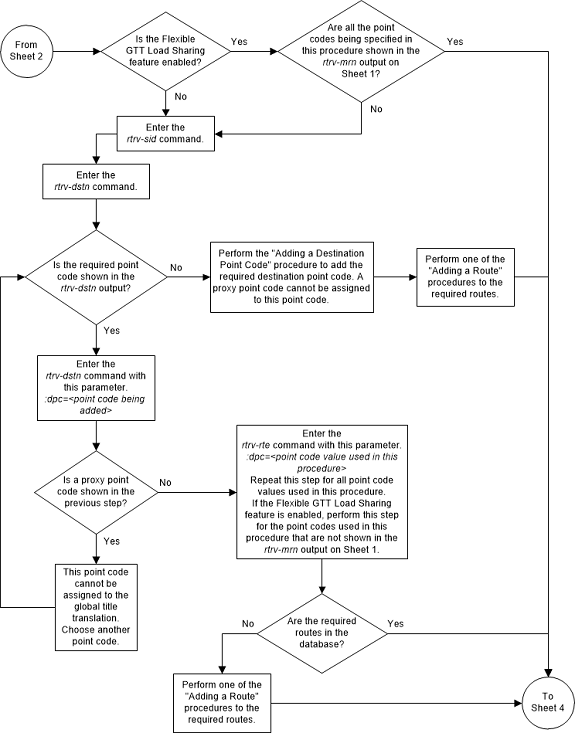

The point codes in the MRN group or MRN set must be a
full point code with a route assigned to it. Cluster point codes, network
routing point codes, or the EAGLE’s true point code cannot be specified in an
rtrv-rte
command can be used to verify
the point codes in the routing table. The point codes in the routing table are
shown in the
DPCA
DPCI
DPCN
, or
DPCN24
fields of the
rtrv-rte
command output. The EAGLE’s
true point code is shown in the
PCA
PCI
PCN
, or
PCN24
fields of the
rtrv-sid
command output.
The Intermediate GTT Load Sharing controlled feature
must be enabled and activated before an MRN group can be provisioned in the
database. This can be verified with the
rtrv-ctrl-feat
command. If this
controlled feature is enabled and activated, the Intermediate GTT Load Sharing
feature is shown as either temporarily or permanently enabled in the
rtrv-ctrl-feat
output, and the entry
on
is shown in the
Status
column for this feature. If
this controlled feature is off, perform
Activating the IGTTLS feature
to enable and turn on this feature.
For MRNs containing ANSI or 24-bit ITU-N point codes,
the format of the point codes specified in the
ent-mrn
command must be the same. For
example, if the primary point code is a 24-bit ITU-N point code (pcn24
), the alternate point code must be a 24-bit ITU-N
point code (mpcn24
). The alternate point codes
of MRNs containing either ITU-I, ITU-I spare, 14-bit ITU-N, or 14-bit ITU-N
spare primary point codes do not have to be the same format as the primary
point code. The alternate point codes of these MRNs can be a mixture of ITU-I,
ITU-I spare, 14-bit ITU-N, or 14-bit ITU-N spare point codes.

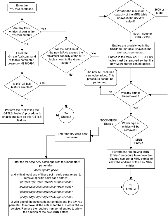

If only the Intermediate GTT Load Sharing feature is
enabled and turned on, the MRN table can contain a maximum of 3000 entries. If
the Flexible GTT Load Sharing feature is enabled, the MRN table can contain a
maximum of 6000 entries. If entries are provisioned in the SCCP-SERV table,
shown by the
rtrv-sccp-serv
command output, the
maximum number of entries that the MRN table can contain is reduced by the
number of entries shown in the
rtrv-sccp-serv
command output.
If adding the new MRN entries will exceed the maximum
capacity of the MRN table, shown in the
rtrv-mrn
command output, entries in
the MRN or SCCP-SERV tables must be removed so that the new MRN entries can be

Figure 2-129 Provision MRN Entries - Sheet 1 of 5
Figure 2-130 Provision MRN Entries - Sheet 2 of 5
Figure 2-131 Provision MRN Entries - Sheet 3 of 5
Figure 2-132 Provision MRN Entries - Sheet 4 of 5
Figure 2-133 Provision MRN Entries - Sheet 5 of 5
