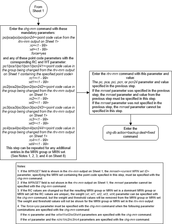

Figure 2-145 Change the Weight and Threshold Values of MRN Entries - Sheet 1 of 4

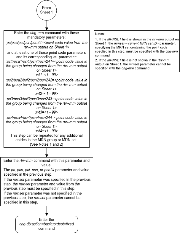

Figure 2-146 Change the Weight and Threshold Values of MRN Entries - Sheet 2 of 4

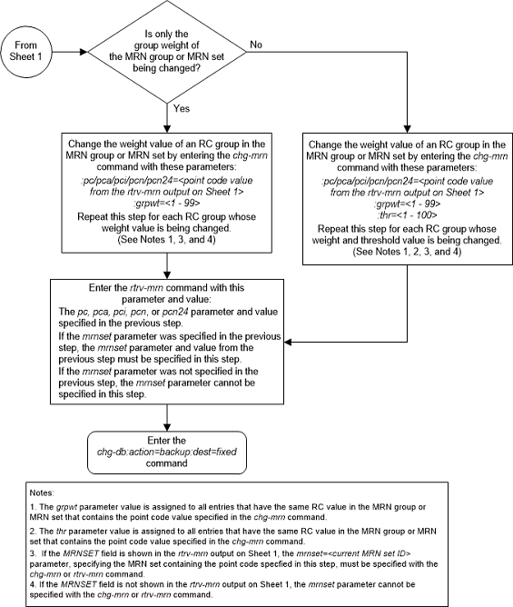

Figure 2-147 Change the Weight and Threshold Values of MRN Entries - Sheet 3 of 4

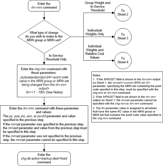

Figure 2-148 Change the Weight and Threshold Values of MRN Entries - Sheet 4 of 4
