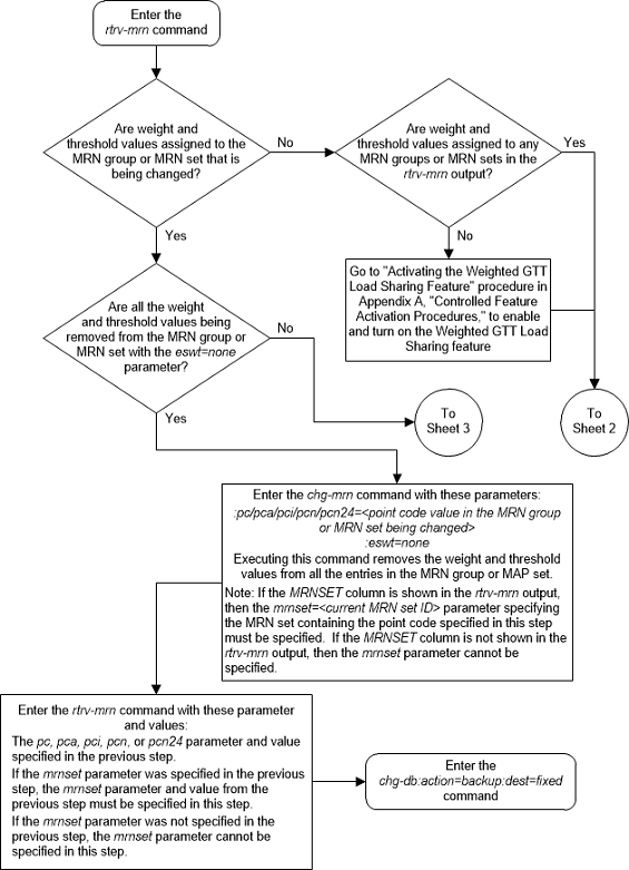

Figure 2-141 Change MRN Entries with the ESWT Parameter - Sheet 1 of 4

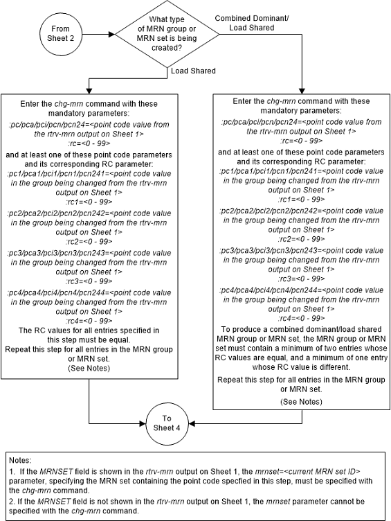

Figure 2-142 Change MRN Entries with the ESWT Parameter - Sheet 2 of 4

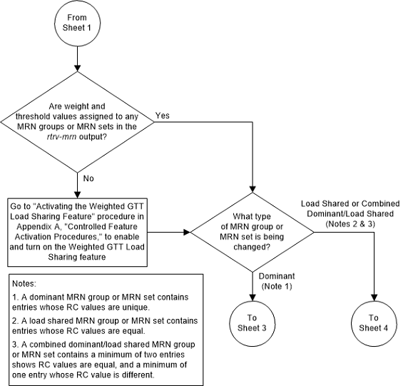

Figure 2-143 Change MRN Entries with the ESWT Parameter - Sheet 3 of 4

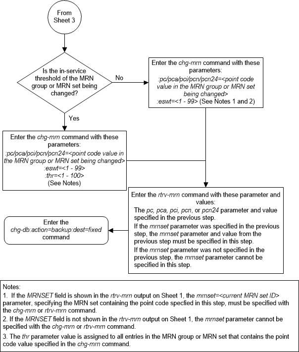

Figure 2-144 Change MRN Entries with the ESWT Parameter - Sheet 4 of 4
