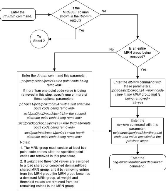

This procedure is used to remove an entry from an mated
relay node (MRN) group or an entire MRN group from the database using the
dlt-mrn command.
The
dlt-mrn command uses these parameters.
:pc/pca/pci/pcn/pcn24 –
The point code in the message after intermediate global title translation has
been performed.
:pc1/pca1/pci1/pcn1/pcn241 – The first alternate point
code value
:pc2/pca2/pci2/pcn2/pcn242 – The second alternate point
code value
:pc3/pca3/pci3/pcn3/pcn243 – The third alternate point
code value
:pc4/pca4/pci4/pcn4/pcn244 – The fourth alternate point
code value
Refer to Chapter 2, "Configuring Destination Tables," in Database Administration - SS7 User's Guide for a definition of the point code types that are used on the EAGLE and for a definition of the different formats that can be used for ITU national point codes.:all – Removes the entire
MRN group or MRN set containing the point code specified by the
pc/pca/pci/pcn/pcn24 parameter.
:mrnset – The MRN set ID
that the MRN is assigned to, shown in the
rtrv-mrn output. MRN set IDs are shown
only if the Flexible GTT Load Sharing feature is enabled. If the Flexible GTT
Load Sharing feature is enabled, the
mrnset parameter must be specified with
the
dlt-mrn command.

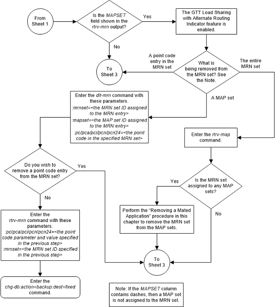

:mapset - The MAP set
ID assigned to the MRN set. This is the MAP set from which alternate routing
indicator searches are performed. The mapset parameter is shown in the
rtrv-mrn output only if the GTT Load
Sharing with Alternate Routing Indicator feature is enabled. An MRN set or a
point code in an MRN set cannot be removed if a MAP set is assigned to the MRN
set.

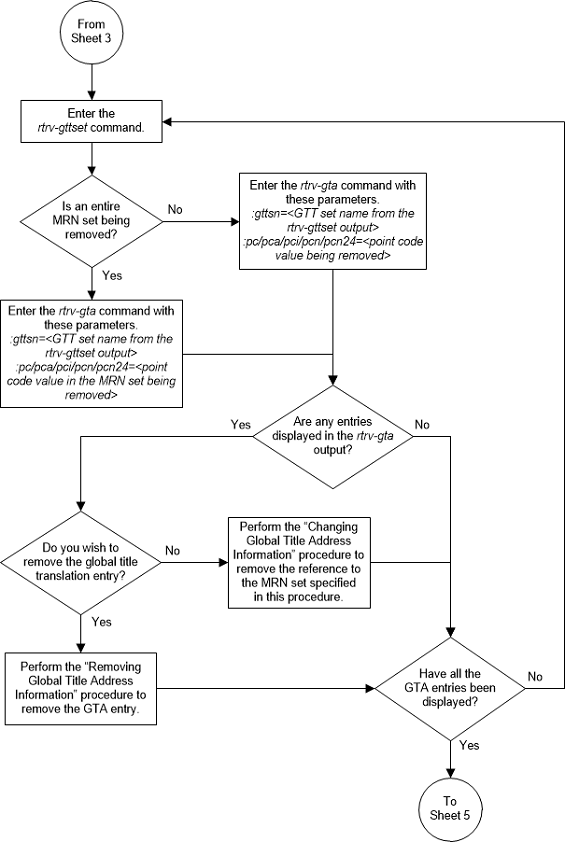

If an entire MRN set is being removed in this procedure
(with the
all=yes parameter), or if a point code
entry in an MRN set is being removed in this procedure, the reference to the
MRN set specified in this procedure must be removed from any GTT or GTA entries
before the point code can be removed from an MRN set, or before an entire MRN
set can be removed.

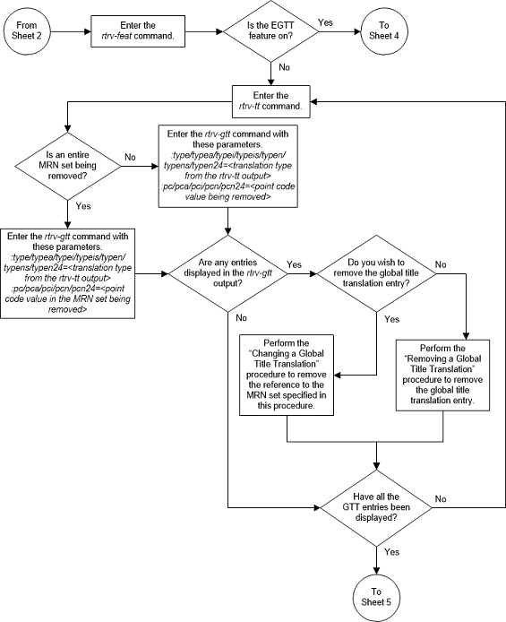

Perform one of these procedures to remove the reference
to the MRN set, depending on whether or not the EGTT feature is on. The status
of the EGTT feature is shown in the
rtrv-feat command output.
rtrv-gtt command to verify the MRN
set ID references. Perform the
Changing a Global Title Translation
procedure to remove the references to the MRN set.
rtrv-gta command to verify the MRN
Changing Global Title Address Information
to remove the references to the MRN set. The MRN set ID is not shown in the
rtrv-ppsopt output.

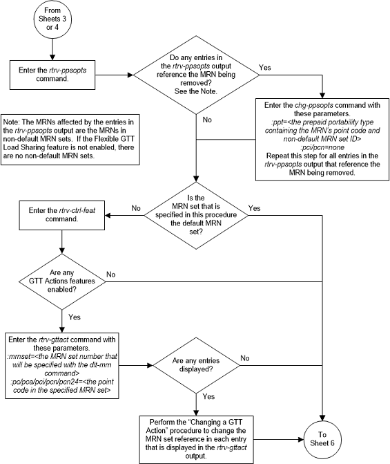

rtrv-gttact output are removed in
10
of this procedure.
If weight and in-service threshold values are assigned to a load shared or combined dominant/load shared MRN group or MRN set, and if by removing entries from this MRN group or MRN set, the MRN group or MRN set becomes a dominant MRN group or MRN set, all weight and threshold values are removed from the remaining entries in the MRN group or MRN set.The mated relay node group being removed, or the point code value being removed from a MRN group must be in the database.
When removing point codes from an MRN group, the MRN
group must contain the
pc parameter value and at least one
alternate point code value.

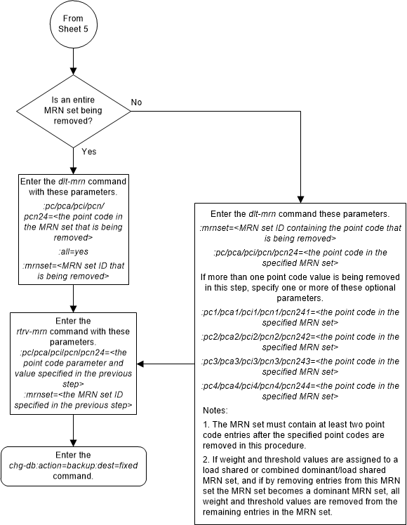

If the
mrnset=dflt and
all=yes parameters are specified with
the
dlt-mrn command, only the MRN group
containing the point code value specified in the
dlt-mrn command is removed from the
default MRN set.

Figure 2-134 Remove MRN Entries - Sheet 1 of 6
Figure 2-135 Remove MRN Entries - Sheet 2 of 6
Figure 2-136 Remove MRN Entries - Sheet 3 of 6
Figure 2-137 Remove MRN Entries - Sheet 4 of 6
Figure 2-138 Remove MRN Entries - Sheet 5 of 6
Figure 2-139 Remove MRN Entries - Sheet 6 of 6
