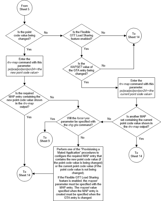

Changing Global Title Address Information
This procedure is used to change existing global title address (GTA) information in the database using the chg-gta command.

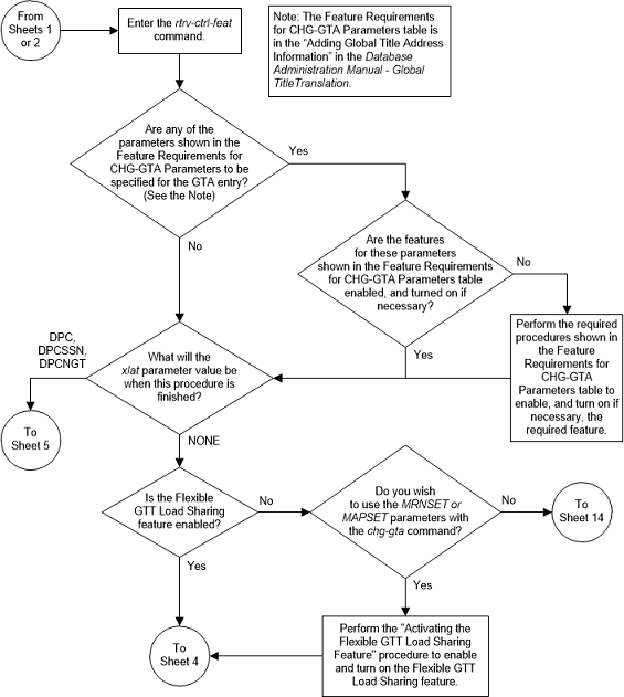

The chg-gta command uses these parameters.

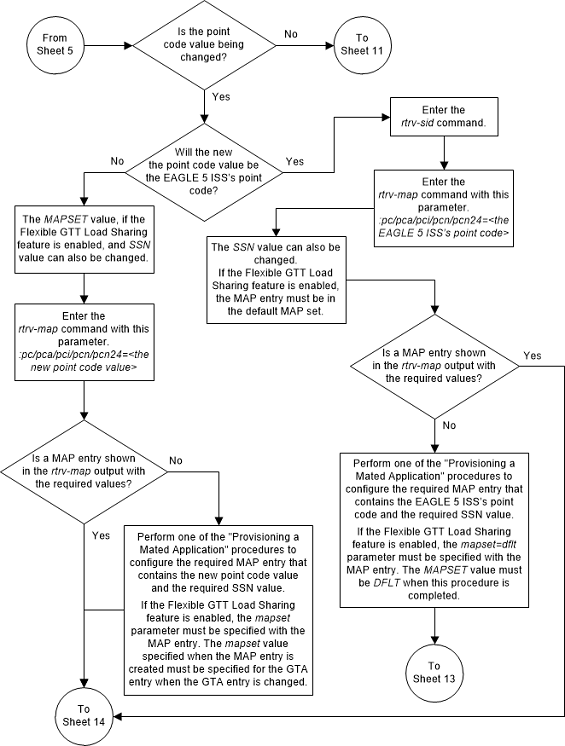

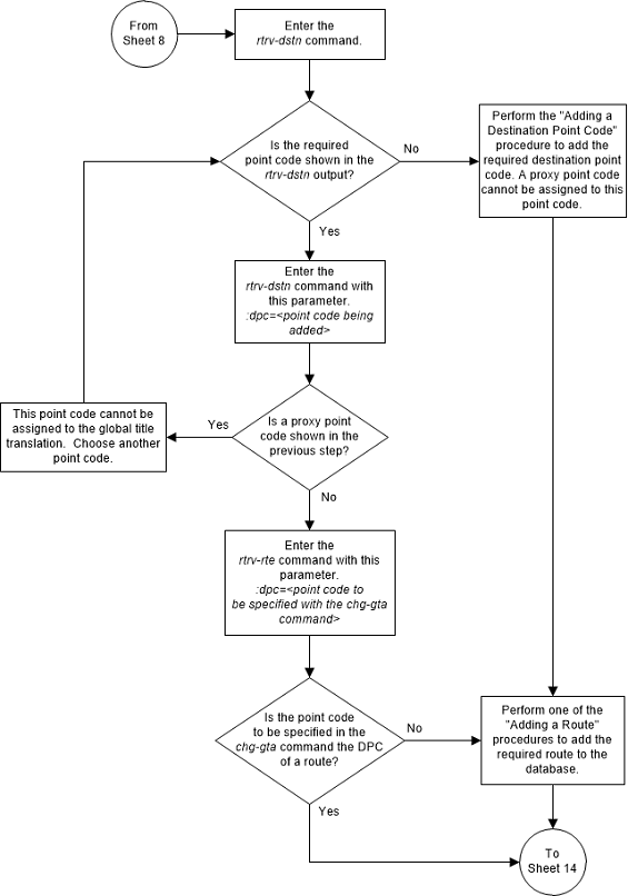

:pc/pca/pci/pcn/pcn24 – The translated point code.

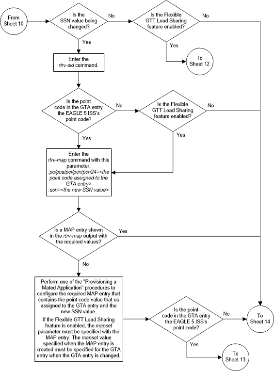

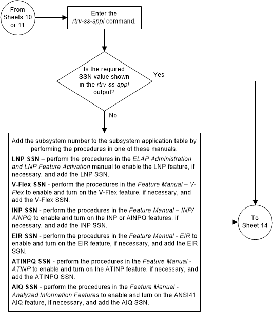

:ssn – The translated subsystem number.

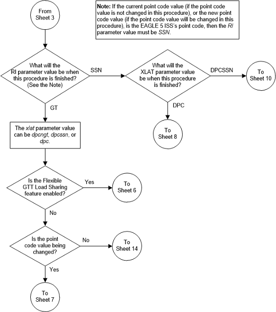

:ri – The routing indicator.
:xlat – The translate indicator.

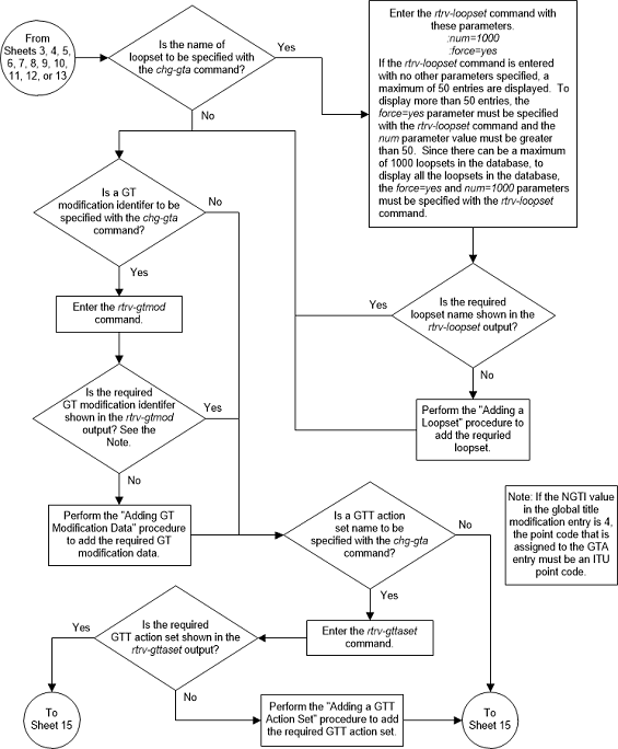

:gtmodid – The name of the GT modification identifier that will be assigned to the GTA entry as shown in the rtrv-gtmod output and provisioned in the Adding Global Title Modification Information procedure. The GT modification identifier contains the information to modify the numbering plan, nature of address indicator, and the prefix or suffix digits in the called party address or calling party address portion of outbound MSUs.

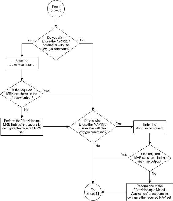

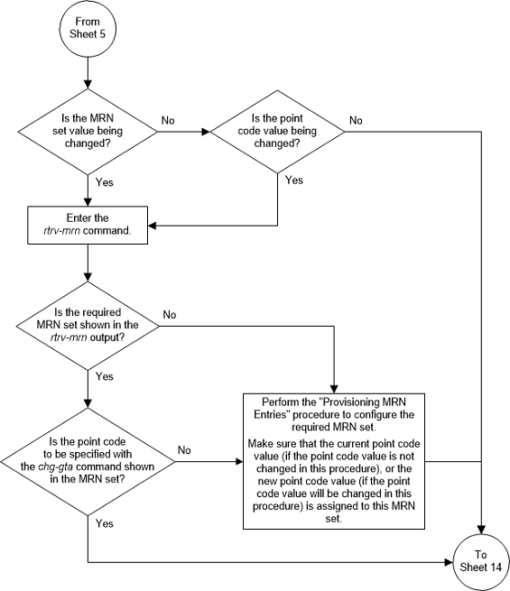

:mrnset – The MRN set ID, shown in the rtrv-mrn command. The mrnset parameter can be specified only if the Flexible GTT Load Sharing feature is enabled. If the Flexible GTT Load Sharing feature is enabled and the ri parameter value will be ri=gt when this procedure is completed, and the original global title translation being changed in this procedure did not have an MRN set ID assigned to it, the mrnset parameter must be specified with the chg-gta command. The MRN set ID assigned to the global title translation in this step must contain the point code value that will be assigned to the global title translation being changed in this step.

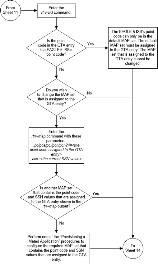

:mapset – The MAP set ID, shown in the rtrv-mrn command. The mapset parameter can be specified only if the Flexible GTT Load Sharing feature is enabled. If the Flexible GTT Load Sharing feature is enabled and the ri parameter value will be ri=ssn when this procedure is completed, and the original global title translation being changed in this procedure did not have a MAP set ID assigned to it, the mapset parameter must be specified with the chg-gta command. The MAP set ID assigned to the global title translation in this step must contain the point code and SSN values that will be assigned to the global title translation being changed in this step.
The status of the Flexible GTT Load Sharing feature is shown in the rtrv-ctrl-feat output. To enable the Flexible GTT Load Sharing feature, perform Activating the Flexible GTT Load Sharing Feature.

:dpc/dpca/dpci/dpcn/dpcn24 – The destination point code

:loopset - The value of this parameter is the name of the loopset that is assigned to the GTA. This parameter can be specified only if the SCCP Loop Detection feature is enabled. Enter the rtrv-loopset command to verify that the SCCP Loop Detection feature is enabled. Perform the Activating the SCCP Loop Detection Feature procedure, if necessary.

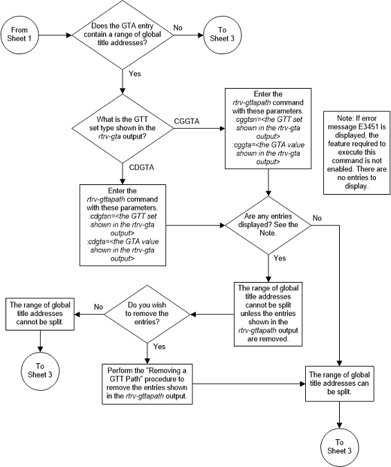

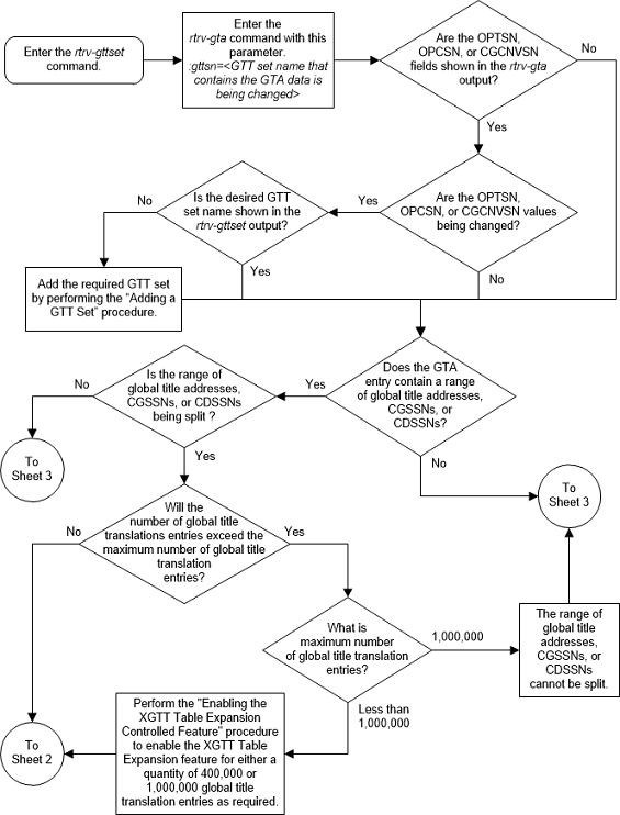

:split – Split or change the range of global title addresses. If the split=yes parameter is specified, the existing range of global title addresses is split based on the values of the gta and egta parameters. New entries are created in the global title translation table for each new range created by the split parameter. The attributes of each new entry, other than the range of global title addresses, are the same as the original global title translation entry, if these values are not changed when the chg-gta command is executed. If other attributes are changed when the chg-gta command is executed, the changed values are in each new entry created by the split parameter.
If the split=no parameter is specified, the range of global title addresses is replaced with the new range of global title addresses specified by the gta and egta parameters.
The default value for the split parameter is yes.
Caution:
Changes to the range of global title addresses occur only if the both the gta and egta parameters are specified and the values for either of these parameters, or both parameters are different from the original values in the global title translation. If the gta and egta parameters are specified for the global title translation being changed, and you do not wish to change either of these values, make sure the gta and egta values shown in the rtrv-gta output for the global title translation being changed are specified in the chg-gta command.
The following examples illustrate how the split parameter works and ranges of global title addresses can be changed.

The range of global title addresses can be changed so long as the new range of global title addresses does not overlap an existing range of global title addresses.
For example, using the range of global title addresses from the previous examples, 5556000 - 5558000, you wish to extend the range of global title addresses to 5556000 - 5559000. The range of global title addresses can be extended to 5559000 by specifying the egta=5559000 and split=no parameters with the chg-gta command. However, if another range of global title addresses begins with the value 5558500, the egta=5559000 parameter cannot be specified with the chg-gta command as the new range created with the egta=5559000 parameter would overlap the range of global title addresses beginning with the value 5558500. In this situation, the maximum value for the egta parameter would be 5558499.

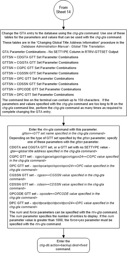

The command line on the terminal can contain up to 150 characters. If the parameters and values specified with the chg-gta command are too long to fit on the chg-gta command line, perform the chg-gta command as many times as necessary to complete the GTA entry.
The GTT set name (gttsn) must be specified and match that of an existing GTT set name. Use the rtrv-gttset command to view the GTT set names. If the specified GTT set is an ANSI set, the pc or pca value must be a valid ANSI point code. If the specified GTT set is an ITU set, the pci, pcn, or pcn24 value must be a valid ITU point code. The point code (PC) must be a full point code and cannot be out of range. If the ANSI/ITU SCCP Conversion feature is enabled, the domain (ANSI or ITU) of the GTT set name and point code do not have to be the same.
See Chapter 2, Configuring Destination Tables in Database Administration - SS7 User's Guide for a definition of the point code types that are used on the EAGLE and for a definition of the different formats that can be used for ITU national point codes.
If the end of the global title address (EGTA) parameter is specified, GTA and EGTA must have the same number of digits, but EGTA must be larger than GTA. The range, as specified by the start and end global title addresses, must be in the database for the specified translation type. Each range may be contained completely within a previously defined range, in which case splitting is performed. However, if the ranges overlap, splitting cannot occur, and the chg-gta command is rejected with this message.
E2401 Cmd Rej:GTA range overlaps a current range
Along with error message 2401, a list of the overlapped global title addresses is displayed as shown in the following example.

Table 4-39 GTA Parameter Combinations - No SETTYPE Column in RTRV-GTTSET Output
Mandatory Parameters
GTTSN – The GTT set name from the GTTSN column of the rtrv-gttset output and from the GTTSN column of the rtrv-gta output.
GTA – The GTA value assigned to the GTTSN value in the rtrv-gta output.
If only the EGTT feature is on, the SETTYPE column is not shown in the rtrv-gttset output.
Optional Parameters
EGTA – 1 - 21 digits or 1 - 21 hexadecimal digits.
Default = same as the GTA value.
Hexadecimal digits (0-9, a-f, A-F) can be specified for the egta parameters only if the Hex Digit support for GTT feature is enabled.
The length of the EGTA value must be the same as the GTA value.
There are other optional parameters that can be used with this entry. Refer to Table 4-48 for these parameters. At least one optional parameter must be specified with the chg-gta command. Unless a default value is shown for a parameter in Table 4-48, the value of any optional parameter that is not specified with the chg-gta command is not changed.
Table 4-40 GTTSN = CDGTA GTT Set Parameter Combinations
XLAT=DPCNGT, DPCSSN, or DPC XLAT=NONE
GTTSN – The GTT set name from the GTTSN column of the rtrv-gttset output containing the value CDGTA in the SETTYPE column and from the GTTSN column of the rtrv-gta output. GTTSN – The GTT set name from the GTTSN column of the rtrv-gttset output containing the value CDGTA in the SETTYPE column and from the GTTSN column of the rtrv-gta output.
GTA – The GTA value assigned to the GTTSN value in the rtrv-gta output. GTA – The GTA value assigned to the GTTSN value in the rtrv-gta output.
Optional Parameters
The length of the EGTA value must be the same as the GTA value. These parameters cannot be specified with the xlat=none parameter.
  • pc/pca/pci/pcn/pcn24
  • ssn
  • ri
  • force=yes
OPTSN – The GTT set name from the GTTSN column of the rtrv-gttset output, or the value none. The value none removes the OPTSN value from the GTA entry. Refer to Table 4-38 for the valid GTT set types that can be specified.
The current value of this parameter must be changed to the value none before the parameter value can be changed to another value that is not none. The new value for this parameter cannot be the gttsn value specified with the chg-gta command.
OPCSN – The GTT set name from the GTTSN column of the rtrv-gttset output containing the value OPC in the SETTYPE column, or the value none. The value none removes the OPCSN value from the GTA entry.
Note: When the xlat parameter value is changed from dpcngt, dpcssn, or dpc, to none, all the optional parameter values that are not specified with the chg-gta command are not changed. However, these changes are made.
  • The PC and SSN values are removed from the GTA entry.
  • The CCGT value is removed from the GTA entry and the CCGT field is not shown in the rtrv-gta output.
  • If the original RI value for the GTA entry was SSN and a MAP set was assigned to the GTA entry, the MAPSET value is not changed and the MRNSET=DFLT entry is assigned to the GTA entry. The MRNSET=DFLT entry is shown in the rtrv-gta output.
  • If the original RI value for the GTA entry was GT and an MRN set was assigned to the GTA entry, the MRNSET value is not changed and the MAPSET=DFLT entry is assigned to the GTA entry. The MAPSET=DFLT entry is shown in the rtrv-gta output.
Table 4-41 GTTSN = CGGTA GTT Set Parameter Combinations
GTTSN – The GTT set name from the GTTSN column of the rtrv-gttset output containing the value CGGTA in the SETTYPE column and from the GTTSN column of the rtrv-gta output. GTTSN – The GTT set name from the GTTSN column of the rtrv-gttset output containing the value CGGTA in the SETTYPE column and from the GTTSN column of the rtrv-gta output.
Optional Parameters
  • ssn
  • ri
  • force=yes
Table 4-42 GTTSN = CGPC GTT Set Parameter Combinations
GTTSN – The GTT set name from the GTTSN column of the rtrv-gttset output containing the value CGPC in the SETTYPE column and from the GTTSN column of the rtrv-gta output. GTTSN – The GTT set name from the GTTSN column of the rtrv-gttset output containing the value CGPC in the SETTYPE column and from the GTTSN column of the rtrv-gta output.
CGPC/CGPCA/CGPCI/CGPCN/CGPCN24 – The CGPC value assigned to the GTTSN value in the rtrv-gta output. (See Note 1) CGPC/CGPCA/CGPCI/CGPCN/CGPCN24 – The CGPC value assigned to the GTTSN value in the rtrv-gta output. (See Note 1)
Optional Parameters
  • ssn
  • ri
  • force=yes
The egta and split parameters cannot be specified with this entry.
  1. The cgpc/cgpca/cgpci/cgpcn/cgpcn24 parameters are used to assign either ANSI, ITU-I, ITU-I spare, 14-bit ITU-N, 14-bit ITU-N spare, or 24-bit ITU-N point codes as the CGPC parameter values.
    • cgpc/cgpca = ANSI point code
    • cgpci = ITU-I or ITU-I spare point code
    • cgpcn = 14-bit ITU-N or 14-bit ITU-N spare point code
    • cgpcn24 = 24-bit ITU-N point code.
  2. When the xlat parameter value is changed from dpcngt, dpcssn, or dpc, to none, all the optional parameter values that are not specified with the chg-gta command are not changed. However, these changes are made.
Table 4-43 GTTSN = CGSSN GTT Set Parameter Combinations
GTTSN – The GTT set name from the GTTSN column of the rtrv-gttset output containing the value CGSSN in the SETTYPE column and from the GTTSN column of the rtrv-gta output. GTTSN – The GTT set name from the GTTSN column of the rtrv-gttset output containing the value CGSSN in the SETTYPE column and from the GTTSN column of the rtrv-gta output.
CGSSN – The CGSSN value assigned to the GTTSN value in the rtrv-gta output. CGSSN – The CGSSN value assigned to the GTTSN value in the rtrv-gta output.
Optional Parameters
ECGSSN – 0 - 255. The ECGSSN value must be greater than the CGSSN value.
ECGSSN – 0 - 255. Default value – no ECGSSN value is specified. The ECGSSN value must be greater than the CGSSN value.
  • ssn
  • ri
  • force=yes
Table 4-44 GTTSN = OPC GTT Set Parameter Combinations
GTTSN – The GTT set name from the GTTSN column of the rtrv-gttset output containing the value OPC in the SETTYPE column and from the GTTSN column of the rtrv-gta output. GTTSN – The GTT set name from the GTTSN column of the rtrv-gttset output containing the value OPC in the SETTYPE column and from the GTTSN column of the rtrv-gta output.
OPC/OPCA/OPCI/OPCN/OPCN24 – The OPC value assigned to the GTTSN value in the rtrv-gta output. (See Note 1) OPC/OPCA/OPCI/OPCN/OPCN24 – The OPC value assigned to the GTTSN value in the rtrv-gta output. (See Note 1)
Optional Parameters
  • ssn
  • ri
  • force=yes
  1. The opc/opca/opci/opcn/opcn24 parameters are used to assign either ANSI, ITU-I, ITU-I spare, 14-bit ITU-N, 14-bit ITU-N spare, or 24-bit ITU-N point codes as the OPC parameter values.
    • opc/opca = ANSI point code
    • opci = ITU-I or ITU-I spare point code
    • opcn = 14-bit ITU-N or 14-bit ITU-N spare point code
    • opcn24 = 24-bit ITU-N point code.
Table 4-45 GTTSN = CDSSN GTT Set Parameter Combinations
GTTSN – The GTT set name from the GTTSN column of the rtrv-gttset output containing the value CDSSN in the SETTYPE column and from the GTTSN column of the rtrv-gta output. GTTSN – The GTT set name from the GTTSN column of the rtrv-gttset output containing the value CDSSN in the SETTYPE column and from the GTTSN column of the rtrv-gta output.
CDSSN – The CDSSN value assigned to the GTTSN value in the rtrv-gta output. CDSSN – The CDSSN value assigned to the GTTSN value in the rtrv-gta output.
Optional Parameters
ECDSSN – 0 - 255. The ECDSSN value must be greater than the CDSSN value.
ECDSSN – 0 - 255. Default value – no ECDSSN value is specified. The ECDSSN value must be greater than the CDSSN value.
  • ssn
  • ri
  • force=yes
Table 4-46 GTTSN = OPCODE GTT Set Parameter Combinations
GTTSN – The GTT set name from the GTTSN column of the rtrv-gttset output containing the value OPCODE in the SETTYPE column and from the GTTSN column of the rtrv-gta output. GTTSN – The GTT set name from the GTTSN column of the rtrv-gttset output containing the value OPCODE in the SETTYPE column and from the GTTSN column of the rtrv-gta output.
OPCODE – The OPCODE value assigned to the GTTSN value in the rtrv-gta output. (See Note 4) OPCODE – The OPCODE value assigned to the GTTSN value in the rtrv-gta output.
ANSI TCAP Translation ITU TCAP Translation ANSI TCAP Translation ITU TCAP Translation
FAMILY – The FAMILY value assigned to the GTTSN and OPCODE values in the rtrv-gta output. ACN – The application context name assigned to the GTTSN and OPCODE values in the rtrv-gta output. FAMILY – The FAMILY value assigned to the GTTSN and OPCODE values in the rtrv-gta output. ACN – The application context name assigned to the GTTSN and OPCODE values in the rtrv-gta output.
PKGTYPE – The PKGTYPE context name assigned to the GTTSN, FAMILY, and OPCODE values in the rtrv-gta output. PKGTYPE – PKGTYPE – The PKGTYPE context name assigned to the GTTSN, ACN, and OPCODE values in the rtrv-gta output. PKGTYPE – The PKGTYPE context name assigned to the GTTSN, FAMILY, and OPCODE values in the rtrv-gta output. PKGTYPE – PKGTYPE – The PKGTYPE context name assigned to the GTTSN, ACN, and OPCODE values in the rtrv-gta output.
Optional Parameters
  • ssn
  • ri
  • force=yes
OPCSN – The GTT set name from the GTTSN column of the rtrv-gttset output containing the value OPC in the SETTYPE column. Default value – no OPC GTT set is specified.

  1. Display the GTT sets in the database using the rtrv-gttset command.
    This is an example of the possible output.
    rlghncxa03w 09-07-07 00:29:31 GMT EAGLE5 41.1.0
    GTTSN      NETDOM  SETTYPE  NDGT
    abcd1234   itu     CGGTA    12
    gttset3    ansi    CGGTA    10
    gttset6    ansi    OPC      -
    gttset7    ansi    CGPC     -
    gttset12   ansi    OPC      -
    imsi       itu     CDGTA    15
    lidb       ansi    CDGTA    10
    t800       ansi    CDGTA    10
    s1000      itu     CDGTA    15
    s2000      itu     CGPC     -
    GTT-SET table is (10 of 2000) 1% full.
  2. Display the global title address (GTA) information for the GTT set that contains the global title address entry that is being changed. Use the rtrv-gta command with the gttsn parameter value shown in the output of 1. If the num parameter is specified with the rtrv-gta command, and the value of the num parameter is greater than 1000, the force=yes parameter must be specified with the rtrv-gta command. For this example, enter this command.
    rtrv-gta:gttsn=lidb
    rlghncxa03w 10-07-07 00:27:31 GMT EAGLE5 42.0.0
    lidb      ansi    CDGTA    10
    GTA TABLE IS   1 % FULL  (17 of 269999)
    START GTA  END GTA    XLAT   RI     PC
    9195554321 9195554321 DPCNGT GT     001-255-253
         SSN=--- CCGT=no CGGTMOD=NO
         GTMODID=modid2     TESTMODE=off
         LOOPSET = none     FALLBACK=sysdflt
         OPTSN=--------- CGSELID=----- OPCSN=---------
         ACTSN=--------- PPMEASREQD= NO
    Command Retrieved 1 Entries
    If any of these conditions are present, this step has been completed.
    • The OPTSN, OPCSN, or CGCNVSN fields are not shown in the rtrv-gta output.
    • The OPTSN, OPCSN, or CGCNVSN fields are shown in the rtrv-gta output and the OPTSN, OPCSN, or CGCNVSN values are not being changed.
    • The OPTSN, OPCSN, or CGCNVSN fields are shown in the rtrv-gta output, the OPTSN, OPCSN, or CGCNVSN values are being changed, and the desired GTT set is shown in the rtrv-gttset output in 1.
    If the OPTSN, OPCSN, or CGCNVSN fields are shown in the rtrv-gta output, the OPTSN, OPCSN, or CGCNVSN values are being changed, and the desired GTT set is not shown in the rtrv-gttset output in 1, perform Adding a GTT Set to add the new GTT set.
    After this step has been completed, continue the procedure by performing one of these steps.
    • If the GTA entry does contains a range of global title addresses, CgPA subsystem numbers, or CdPA subsystem numbers, and this range will be split, continue the procedure with 3.
    • If the GTA entry does contains a range of global title addresses, CgPA subsystem numbers, or CdPA subsystem numbers, and this range will not be split, or if the GTA entry does not contain a range of global title addresses, CgPA subsystem numbers, or CdPA subsystem numbers, continue the procedure with 5.
  3. Splitting a range of global title addresses, CgPA subsystem numbers, or CdPA subsystem numbers creates a new GTA entry.
    If splitting the global title addresses, CgPA subsystem numbers, or CdPA subsystem numbers will increase the number of global title translations in the database beyond the maximum number of global title translations shown in the rtrv-gta output in 2, and the maximum number of global title translations is either 269,999 or 400,000, the maximum number of global title translations must be increased. Perform the Enabling the XGTT Table Expansion Feature procedure to increase the maximum number of global title translations. If the maximum number of global title translations is 1,000,000, the maximum number of global title translations cannot be increased. The range of global title addresses, CgPA subsystem numbers, or CdPA subsystem numbers cannot be split. This new entry cannot be created if the database contains the maximum number of GTA entries.
    Continue the procedure by performing one of these steps.
    • If the GTA entry does not contain a range of global title addresses, or the number of global title translations in the database will not be increased beyond the maximum number of global title translations shown in the rtrv-gta output in 2, continue the procedure with 5.
    • If the GTA entry contains a range of global title addresses that will be split and the number of global title translations in the database will not be increased beyond the maximum number of global title translations shown in the rtrv-gta output in 2, continue the procedure with 4.
  4. Display the GTT path entries by entering the rtrv-gttapath command with these parameters.
    • cdgttsn - the GTTSN value shown in the rtrv-gta output in 2.
    • cdgta - the START GTA value shown in the rtrv-gta output in 2.
    rtrv-gttapath:cdgttsn=lidb:cdgta=9195554321
    rlghncxa03w 10-07-25 09:43:31 GMT  EAGLE5 42.0.0
    GTTPN   OPGTTSN         CGGTTSN         CDGTTSN
    path1   ---------       ---------       lidb
        CDGTA = 9195554321                   ECDGTA = 9195554321
    GTT-PATH table is (5 of 10000) 1% full.
    The range of global title addresses cannot be split if entries containing the GTTSN and the GTA values shown in the rtrv-gttapath output. If entries are displayed in the rtrv-gttapath output, perform the Removing a GTT Action Path Entry procedure to remove the entries shown in the rtrv-gttapath output.
    Continue the procedure with 5 if no entries are shown in this step; error message E3451 is displayed; if the entries in the rtrv-gttapath output will not be removed; or the Removing a GTT Action Path Entry procedure has been performed.

  6. Some parameters of the chg-gta command can be specified only when certain features are enabled, and turned on if necessary. Table 4-49 shows the feature requirements for these parameters.found. Some
    Table 4-49 Feature Requirements for CHG-GTA Parameters
    Required Feature Parameters or Values
    Origin-Based SCCP Routing Enabled GTTSN - specifying CGGTA, CGPC, CGSSN, or OPC GTT sets
    OPTSN - specifying CGGTA, CGPC, or CGSSN GTT sets
    OPCSN
    CGPC
    CGSSN
    ECGSSN
    OPC
    CGSELID
    Flexible GTT Load Sharing Enabled MAPSET
    MRNSET
    Flexible Linkset Optional Based Routing Enabled and Turned On GTTSN - specifying CDSSN or DPC GTT sets
    OPTSN - specifying CDSSN or DPC GTT sets
    FALLBACK
    CDSSN
    ECDSSN
    CDSELID
    DPC
    ANSI/ITU SCCP Conversion Enabled and Flexible Linkset Optional Based Routing Enabled and Turned On CGCNVSN
    TCAP Opcode Based Routing Enabled and Turned On GTTSN - specifying OPCODE GTT sets
    OPTSN - specifying OPCODE GTT sets
    TOBR Quantity Enabled ACN
    FAMILY
    OPCODE
    PKGTYPE
    SCCP Loop Detection Enabled LOOPSET
    Advanced GT Modification or AMGTT CgPA Upgrade Enabled CGGTMOD
    ANSI/ITU SCCP Conversion Enabled The domain (ANSI or ITU) of the point code and the GTT set that will be assigned to the GTA entry will be different.
    Hex Digit Support for GTT Enabled Hexadecimal digits will be specified for the gta or egta parameter values.
    GTT Action - DISCARD, GTT Action - DUPLICATE, GTT Action - FORWARD Enabled ACTSN
    To enable, and turn on if necessary, any of these features, perform these procedures.
    If the required feature is enabled, and turned on if required, shown in the rtrv-ctrl-feat output in 5, the procedure for that feature does not need to be performed.
  7. To use either the mrnset parameter (if the routing indicator value for the global title translation is GT) or mapset parameter (if the routing indicator value for the global title translation is SSN), the Flexible GTT Load Sharing feature must be enabled. See 6. The mrnset and mapset parameters can be specified if the xlat=none parameter is specified for the GTA entry.
    If the Flexible GTT Load Sharing feature is enabled, the GTA entry must contain either an MRNSET or MAPSET value, depending on the routing indicator value for the global title translation being changed.
    If the routing indicator for the GTA entry that is being changed will be GT when this procedure is completed, continue the procedure by performing one of these steps.
    • If the Flexible GTT Load Sharing feature is not enabled and the point code value will not be changed, continue the procedure with 19.
    • If the Flexible GTT Load Sharing feature is not enabled, and the point code value will be changed, continue the procedure with 9.
    • If the Flexible GTT Load Sharing feature is enabled and the point code value will be changed, whether or not the MRNSET value will be changed, continue the procedure with 11.
    • If the Flexible GTT Load Sharing feature is enabled and the point code and MRNSET values will not be changed, continue the procedure with 19.
    If the routing indicator for the GTA entry that is being changed will be SSN when this procedure is completed, continue the procedure by performing one of these steps.
    • If the XLAT parameter value will be DPC when this procedure is completed, continue the procedure by performing one of these steps.
      • If the point code value will not be changed and the Flexible GTT Load Sharing feature is not enabled, continue the procedure with 19.
      • If the point code value will not be changed; the Flexible GTT Load Sharing feature is enabled and the MAPSET value will not be changed, continue the procedure with 19.
      • If the point code value will not be changed; the Flexible GTT Load Sharing feature is enabled and the MAPSET value will be changed, continue the procedure with 13.
      • If the point code value will be changed, continue the procedure with 13.
    • If the XLAT parameter value will be DPCSSN when this procedure is completed, continue the procedure by performing one of these steps.
      • If the point code, SSN, and MAPSET value (if the Flexible GTT Load Sharing feature is enabled) will not be changed, continue the procedure with 19.
      • If the point code will be changed, continue the procedure by performing one of these steps.
        • If the new point code value will not be the EAGLE’s point code, continue the procedure with 13.
        • If the new point code value will be the EAGLE’s point code, continue the procedure with 12.
      • If only the SSN value will be changed, continue the procedure with 12.
      • If the Flexible GTT Load Sharing feature is enabled and only the MAPSET value will be changed, continue the procedure with 12.
    If the xlat=none parameter will be specified and the Flexible GTT Load Sharing feature is not enabled, continue the procedure with 18.
    If the xlat=none parameter will be specified and the Flexible GTT Load Sharing feature is enabled, continue the procedure by performing one of these steps. Both the mrnset and mapset parameters can be specified for the GTA entry.
    • If the mrnset parameter will be specified, continue the procedure with 8.
    • If the mapset parameter will be specified, continue the procedure with 13.

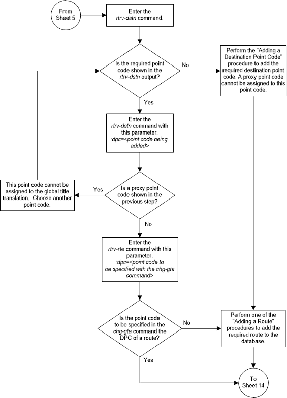

  8. The point code and MRN set ID specified with the chg-gta command must be shown in the rtrv-mrn command output. The point code must be assigned to the MRN set that will be specified with the chg-gta command.
    Enter the rtrv-mrn command to verify that the required MRN set is configured in the database, and that the required point code is assigned to the MRN set. The following is an example of the possible output.

    113      s-1-1-1-0123-aa   1
             s-1-1-1-0235-aa   2
             s-1-1-1-0235-aa   3
    If the Weighted GTT Load Sharing feature is enabled, the WT, %WT, and THR columns are shown in the rtrv-mrn output.
    If the required MRN set is not shown in the rtrv-mrn output, or if the required point code is not assigned to the required MRN set, provision the required MRN set by performing the Provisioning MRN Entries procedure. After provisioning the required MRN set, continue the procedure with 18.
    If the required MRN set is shown in the rtrv-mrn output, or if the required point code is assigned to the required MRN set, continue the procedure with 18.
  9. Display the destination point codes in the database by entering the rtrv-dstn command. This is an example of the possible output.
    rlghncxa03w 10-12-10 11:43:04 GMT EAGLE5 43.0.0
    Extended Processing Time may be Required
       DPCA          CLLI        BEI ELEI   ALIASI           ALIASN/N24    DMN
       001-207-000   ----------- no  --- --------------   --------------   SS7
       001-001-001   ----------- no  --- --------------   --------------   SS7
       001-001-002   ----------- no  --- --------------   --------------   SS7
       001-005-000   ----------- no  --- --------------   --------------   SS7
       001-007-000   ----------- no  --- --------------   --------------   SS7
       008-012-003   ----------- no  --- --------------   --------------   SS7
       003-002-004   ----------- no  --- --------------   --------------   SS7
       009-002-003   ----------- no  --- --------------   --------------   SS7
       010-020-005   ----------- no  --- --------------   --------------   SS7
       DPCI          CLLI        BEI ELEI   ALIASA           ALIASN/N24    DMN
       1-207-0       ----------- no  --- --------------   --------------   SS7
       0-015-0       ----------- no  --- --------------   --------------   SS7
       0-017-0       ----------- no  --- --------------   --------------   SS7
       1-011-1       ----------- no  --- --------------   --------------   SS7
       1-011-2       ----------- no  --- --------------   --------------   SS7
    Destination table is (14 of 2000) 1% full
    Alias table is (0 of 12000) 0% full
    PPC table is (1 of 20) 5% full
    If the required point code is not shown in the rtrv-dstn output, perform the "Adding a Destination Point Code" procedure in Database Administration - SS7 User's Guide to add the required point code. A proxy point code cannot be assigned to the point code.
    After the new point code has been added, perform one of the Adding a Route procedures in Database Administration - SS7 User's Guide and add the required route to the database. After the route has been added, continue the procedure with 18.
    If the required point code is shown in the rtrv-dstn output, continue the procedure with 10.
  10. Display the point code that will be assigned to the mated application by using the rtrv-dstn command and specifying the point code. For this example, enter this command.
    rtrv-dstn:dpca=010-020-005
       PPCA         NCAI PRX     RCAUSE NPRST SPLITIAM HMSMSC HMSCP SCCPMSGCNV
       009-002-003  ---- no      none   off   none     no     no    none
    A proxy point code (a point code value is shown in the PPC column) cannot be assigned to the point code. If a proxy point code is shown in this step, choose another point code from the rtrv-dstn output in the previous step and repeat this step.
    If the point code displayed in this step does not contain a proxy point code, continue the procedure with 11.
  11. The point code specified with the chg-gta command must be the DPC of a route, unless the point code is the EAGLE’s point code.
    Enter the rtrv-rte command with the dpc parameter specifying the point code to be used with the chg-gta command to verify whether or not the point code is the DPC of a route. For this example, enter this command.
    rtrv-rte:dpca=001-255-252
    rlghncxa03w 09-05-07 11:43:04 GMT  EAGLE5 41.0.0
       DPCA           ALIASI     ALIASN/N24    LSN        RC    APCA
       001-255-252 ---------- --------------   ls07       10    001-255-252
                                               ls08       30    025-025-150
                                               lsa5       50    066-030-100
                                                   RTX:No  CLLI=ls07clli
    If the point code is not shown in the rtrv-rte output, perform one of the Adding a Route procedures in Database Administration - SS7 User's Guide and add the required route to the database.
    If the point code is shown in the rtrv-rte output, and a new route was added, continue the procedure with 18.
  12. If the ri=ssn and xlat=dpcssn parameters are specified with the chg-gta command, and you wish to use the EAGLE’s point code for the value of the pc parameter of the chg-gta command, the point code value must be in the EAGLE’s self ID table. Display the EAGLE self-identification, using the rtrv-sid command. This is an example of the possible output.
    rlghncxa03w 09-05-10 11:43:04 GMT EAGLE5 41.0.0
       PCA             PCI          PCN                CLLI              PCTYPE
       010-020-030     1-023-1      12-0-14-1          rlghncxa03w       OTHER
                     s-1-023-1    s-12-0-14-1
       CPCA
       002-002-002       002-002-003       002-002-004      002-002-005
       002-002-006       002-002-007       002-002-008      002-002-009
       004-002-001       004-003-003       050-060-070
       CPCI
       1-001-1           1-001-2           1-001-3          1-001-4
       1-002-1           1-002-2           1-002-3          1-002-4
       2-001-1           7-222-7
       CPCN
       2-0-10-3          2-0-11-0          2-0-11-2          2-0-12-1
       2-2-3-3           2-2-4-0           10-14-10-1
    • If the point code value will be changed to the EAGLE's point code, continue the procedure with 13.
    • If the SSN value will be changed and the current point code value is the EAGLE's point code, continue the procedure with 13.
    • If the MAPSET value will be changed, continue the procedure with 13.
  13. Enter the rtrv-map command with the pc parameter specifying the required point code to verify that the required data is in the mated application table.
    If the Flexible GTT Load Sharing feature is enabled, a MAP set ID must be specified for the final global title translation. The point code and SSN specified for the final global title translation being changed in this procedure must be assigned to the MAP set ID that will be assigned to the final global title translation. Perform this step to verify that the required MAP set is configured in the database.
    If the point code value of the GTA entry is being changed, specify the new point code value of the GTA entry.
    If the point code value of the GTA entry is not being changed, specify the current point code value of the GTA entry.
    If the point code value of the GTA entry will be the EAGLE's point code, specify the EAGLE's point code, shown in 12. The MAP entry that contains the EAGLE's point code must be in the default MAP set.
    If the XLAT value of the GTA entry will be DPCSSN when this procedure is completed, and the SSN or MAPSET value will be changed, specify the new SSN value, if the SSN value will be changed, or the current SSN value, if the SSN value will not be changed, in this step.
    For this example enter this command.
    rtrv-map:pca=001-255-252
    rlghncxa03w 09-07-25 09:42:31  GMT  EAGLE5 41.1.0
    PCA          Mate PCA     SSN RC MULT SRM MRC GRP NAME SSO
    MAPSET ID=DFLT
    001-255-252                55  5  DOM YES YES -------- OFF
                 001-001-002   15 15  DOM YES YES -------- ON
                 001-001-003   25 20  DOM YES YES -------- ON
                 001-001-002   40 35  DOM YES YES -------- OFF
    MAPSET ID=1
    001-255-252               254  5  DOM YES YES -------- OFF
                 001-001-002   10 15  DOM YES YES -------- ON
                 001-001-003   20 20  DOM YES YES -------- ON
    MAPSET ID=2
    001-255-252                 5 10  SOL *Y  *Y  -------- OFF
    MAP TABLE IS    (12 of 36000)   1 % FULL
    If the Weighted GTT Load Sharing feature is enabled, the WT, %WT, and THR columns are shown in the rtrv-map output.
    If the parameter values for the ri and xlat parameters will be ri=ssn and xlat=dpc when this procedure is completed, the point code value must be in the mated application table. If the point code is not in the mated application table when the chg-gta command is executed, the force=yes parameter must be specified with the chg-gta command. If the force=yes parameter will be used with the chg-gta command, continue the procedure with 15.
    If the parameter values for the ri and xlat parameters will be ri=ssn and xlat=dpcssn, and the point code and subsystem number values will be the EAGLE’s true point code and the EAGLE’s subsystem number when this procedure is completed, the EAGLE’s true point code and the EAGLE’s subsystem number must be in the mated application table.
    If the required point code, subsystem number, or MAP set ID is not shown in the rtrv-map output, perform one of these procedures to add the required information to the mated application table.
    If the required MAP entry is shown in this step, or a new MAP entry was added in this step, continue the procedure with 18.
    If the point code value is being changed in this procedure to the EAGLE’s point code, continue the procedure with 12.
  14. Enter the rtrv-ss-appl command to verify that either the LNP, EIR, V-Flex, ATINPQ, AIQ, or INP subsystem number (depending on which feature is on) is in the subsystem application table.
    rlghncxa03w 08-09-28 14:42:38 GMT EAGLE5 41.0.0
    APPL       SSN       STAT
    LNP        254       ONLINE
    SS-APPL table is 20% FULL (1 of 5)
    If no subsystem number is shown in the rtrv-ss-appl output, or if the rtrv-ss-appl command is rejected, go to one of these user's guides, depending on the type of subsystem you wish to use, to enable and turn on the feature as necessary, and add the subsystem to the subsystem application table.
    • EIR subsystem – go to EIR User's Guide.
    • INP subsystem – go to INP/AINPQ User's Guide.
    • LNP subsystem – go to ELAP Administration and LNP Feature Activation Guide.
    • V-Flex subsystem – go to V-Flex User's Guide.
    • ATINPQ subsystem – go to ATINP.
    • AIQ subsystem – go to Analyzed Information Features User's Guide.
    If the subsystem number is shown in the rtrv-ss-appl output, or the subsystem number has been added in this step, continue the procedure with 18.
  15. Display the destination point codes in the database by entering the rtrv-dstn command. This is an example of the possible output.
    After the new point code has been added, perform one of the Adding a Route procedures in Database Administration - SS7 User's Guide to add the required route to the database. After the route has been added, continue the procedure with 18.
    If the required point code is shown in the rtrv-dstn output, continue the procedure with 16.
  16. Display the point code that will be assigned to the mated application by using the rtrv-dstn command and specifying the point code. For this example, enter this command.
    If the point code displayed in this step does not contain a proxy point code, continue the procedure with 17.
  17. The point code specified with the chg-gta command must be the DPC of a route, unless the point code is the EAGLE’s point code.
                                               ls08       30    025-025-150
                                               lsa5       50    066-030-100
  18. Continue the procedure by performing one or more of these steps depending on the parameters that will be specified with the ent-gta command.
    If the loopset parameter will be specified for the GTA entry, and the desired LOOPSET value is not shown in the rtrv-gta output, continue the procedure with 19.
    If the gtmodid parameter will be specified for the GTA entry, and the desired GTMODID value is not shown in the rtrv-gta output, continue the procedure with 20.
    If the actsn parameter will be specified for the GTA entry, and the desired ACTSN value is not shown in the rtrv-gta output, continue the procedure with 21.
    If the loopset. gtmodid, and actsn parameters will not be specified for the GTA entry, continue the procedure with 22.
  19. Display all the loopsets in the database by entering this command. rtrv-loopset:num=1000:force=yes
    LoopSet      Mode       Point Codes
    cary2       notify      005-015-005      007-007-007      (ANSI)
                            033-004-003      033-007-003
                            005-027-005      007-004-007
    cary4       notify      005-012-005      007-026-007      (ANSI)
                            003-049-003      033-002-003
                            005-008-055      007-014-007
    apex3       discard     005-017-008      007-017-009      (ANSI)
                            033-005-043      005-014-005
                            005-017-005      007-014-007
                            033-002-043      005-038-005
                            007-009-027      033-003-043
                            005-012-005      007-002-027
    apex4       discard     005-007-008      027-007-009      (ANSI)
                            033-005-003      005-004-055
                            027-001-007      033-008-003
                            033-007-003      005-003-055
                            027-008-007
    ral5        notify      005-005-005      007-007-007      (ANSI)
                            003-004-003      003-001-003
                            005-007-005      007-004-007
                            003-002-003      005-008-005
                            007-009-007      003-003-003
                            005-002-005      007-002-007
    ral6        notify      005-007-008      007-007-009      (ANSI)
                            003-005-003      003-007-003
                            005-007-005
    dunn1       discard     005-002-055      007-051-007      (ANSI)
                            003-008-033
    rtp9        discard     005-002-005      007-001-007      (ANSI)
                            003-008-003      003-007-003
                            005-003-005      007-008-007
                            005-004-005
    rtp5        discard     005-007-008      007-007-009      (ANSI)
                            003-005-003
    rtp1        discard     005-005-005      007-007-007      (ANSI)
                            003-004-003      003-007-003
                            005-004-005
    rtp2        notify      005-007-008      007-007-009      (ANSI)
                            003-005-003
    rlghncxa03w 07-03-07 08:50:15 GMT Rel 35.6.0
    LOOPSET table is (11 of 1000)       1% full
    RTRV-LOOPSET: MASP A - COMPLTD
    If the rtrv-loopset command is entered with no other parameters specified, a maximum of 50 entries are displayed. To display more than 50 entries, the force=yes parameter must be specified with the rtrv-loopset command and the num parameter value must be greater than 50. Since there can be a maximum of 1000 loopsets in the database, to display all the loopsets in the database, the force=yes and num=1000 parameters must be specified with the rtrv-loopset command.
    If the required loopset is not shown in the rtrv-loopset output, perform Adding a Loopset to add the required loopset.
    if the required loopset is shown in the rtrv-loopset output, or if a new loopset was added, continue the procedure by performing one of these steps.
    • If the gtmodid parameter will be specified for the GTA entry, and the desired GTMODID value is not shown in the rtrv-gta output, continue the procedure with 20.
    • If the actsn parameter will be specified for the GTA entry, and the desired ACTSN value is not shown in the rtrv-gta output, continue the procedure with 21.
    • If the gtmodid and actsn parameters will not be specified for the GTA entry, continue the procedure with 22.
  20. Display the GT modification information in the database using the rtrv-gtmod command.
    rlghncxa03w 10-07-07 00:29:31 GMT EAGLE5 42.0.0
    GTMODID   NTT  NGTI  GT0FILL  NNP  NNAI  NPDD  NSDD  PRECD  CGPASSN
    modid2     --     2       ON   --    --    --    --    PFX       --
          NPDS=                       NSDS=
    modid5     --     2      OFF   --    --    --    --    PFX       --
          NPDS=                       NSDS=
    modid6     --     4       ON    4     5     3     3    SFX       --
          NPDS=123                    NSDS=456
    modid10    --    --      OFF    5     5    --    --    PFX       --
          NPDS=                       NSDS=
    modid11    --    --      OFF    5     5    --    --    PFX       --
          NPDS=                       NSDS=
    GTMOD table is (5 of 100000) 1% full.
    If the desired GT modification entry is not displayed, perform the Adding Global Title Modification Information procedure to add the desired GT modification entry to the database.
    If the desired GT modification entry is displayed or the Adding Global Title Modification Information procedure was performed, continue the procedure by performing one of these steps.
    • If the actsn parameter will not be specified for the GTA entry, continue the procedure with 22.
  21. Display the GTT action sets in the database using the rtrv-gttaset command.
    ACTSN      TEST  ActIds
               MODE
    act1       off   action1   (DUP),action4   (DUP),action25  (FWD),
    act10      on    action20  (DUP),action4   (DUP),action21  (DUP),
                     action25  (FWD),------,------
    act3       off   action2   (DISC),------,------,
    act5       on    action1   (DUP),action3   (DUP),action4   (DUP),
                     action20  (DUP),action21  (DUP),action17  (TCAPERR)
    act11      off   action10  (UDTS),------,------,
    GTT-ASET table is (5 of 20000) 1% full.
    If the desired GTT action set is not displayed, perform the Adding a GTT Action Set procedure to add the desired GT modification entry to the database.
    If the desired GT modification entry is displayed or the Adding a GTT Action Set procedure was performed, continue the procedure with 22.

  24. Back up the new changes using the chg-db:action=backup:dest=fixed command. These messages should appear, the active Maintenance and Administration Subsystem Processor (MASP) appears first.
    BACKUP (FIXED) : MASP A - Backup starts on active MASP.
    BACKUP (FIXED) : MASP A - Backup on active MASP to fixed disk complete.
    BACKUP (FIXED) : MASP A - Backup starts on standby MASP.
    BACKUP (FIXED) : MASP A - Backup on standby MASP to fixed disk complete.
Figure 4-23 Change Global Title Address Information - Sheet 1 of 15
Figure 4-24 Change Global Title Address Information - Sheet 2 of 15
Figure 4-25 Change Global Title Address Information - Sheet 3 of 15
Figure 4-26 Change Global Title Address Information - Sheet 4 of 15
Figure 4-27 Change Global Title Address Information - Sheet 5 of 15
Figure 4-28 Change Global Title Address Information - Sheet 6 of 15
Figure 4-29 Change Global Title Address Information - Sheet 7 of 15
Figure 4-30 Change Global Title Address Information - Sheet 8 of 15
Figure 4-31 Change Global Title Address Information - Sheet 9 of 15
Figure 4-32 Change Global Title Address Information - Sheet 10 of 15
Figure 4-33 Change Global Title Address Information - Sheet 11 of 15
Figure 4-34 Change Global Title Address Information - Sheet 12 of 15
Figure 4-35 Change Global Title Address Information - Sheet 13 of 15
Figure 4-36 Change Global Title Address Information - Sheet 14 of 15
Figure 4-37 Change Global Title Address Information - Sheet 15 of 15
