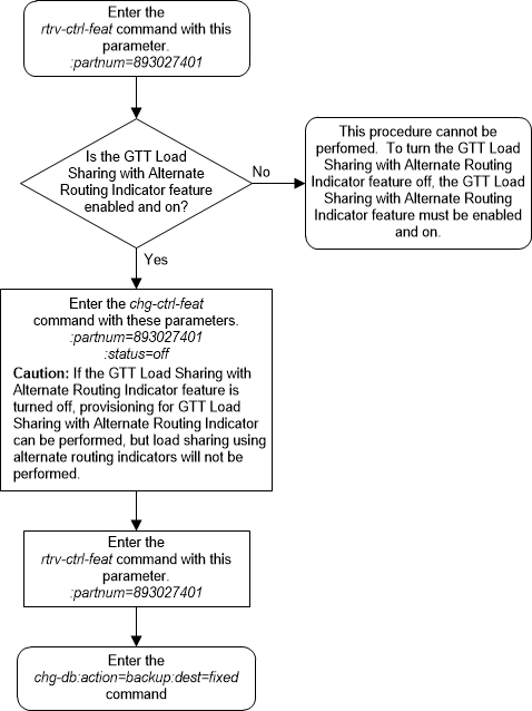

This procedure is used to turn off the GTT Load Sharing
with Alternate Routing Indicator feature, using the
chg-ctrl-feat command.
The
chg-ctrl-feat command uses the
following parameters:
:partnum - The part
number of the GTT Load Sharing with Alternate Routing Indicator feature,
893027401.
:status=off – used to
turn off the GTT Load Sharing with Alternate Routing Indicator feature.
The status of the GTT Load Sharing with Alternate
Routing Indicator feature must be
on and is shown with the
rtrv-ctrl-feat command.
Caution:
If the GTT Load Sharing with Alternate Routing Indicator feature is turned off, provisioning for the GTT Load Sharing with Alternate Routing Indicator feature can be performed, but load sharing using alternate routing indicators will not be performed.Figure 5-57 Turn Off the GTT Load Sharing with Alternate Routing Indicator Feature
