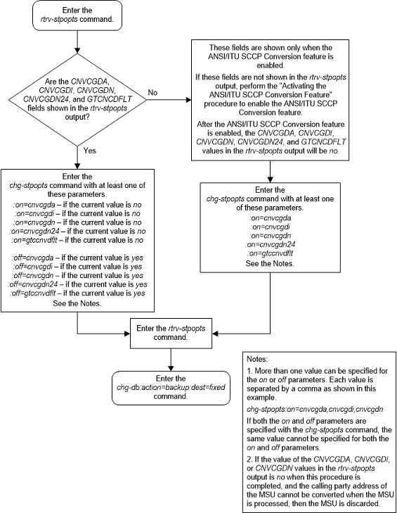

This procedure is used to change the options used for the
ANSI/ITU SCCP Conversion feature using the
chg-stpopts
command. The options are:
:cnvcgda
– The CGPA point
code in ANSI SCCP messages are discarded if the point code or alias point code
of the destination network type is not defined.
:cnvcgdi
– The CGPA point
code in ITU-I SCCP messages are discarded if the point code or alias point code
:cnvcgdn
– The CGPA point
code in ITU-N SCCP messages are discarded if the point code or alias point code
:cnvcgdn24
– The CGPA
point code in ITU-N24 SCCP messages are discarded if the point code or alias
point code of the destination network type is not defined.
:cnvclgitu
– Enables or disables ITU-X
to ITU-Y SCCP CGPA Conversion.
:gtcnvdflt
– SCCP
messages are routed using system defaults when an appropriate entry is not
found in the Default GT Conversion Table.
The values for each of these parameters, shown in the
rtrv-stpopts
output, is either
yes
or
no
. The system default values for these
parameters is
no
These parameters of the
chg-stpopts
command are optional. For
any parameters not specified with the
chg-stpopts
command, the values for
these parameters are not changed.
The current values for these parameters are shown in the
CNVCGDA
CNVCGDI
CNVCGDN
CNVCGDN24
, and
GTCNVDFLT
fields in the output of the
rtrv-stpopts
command.
The ANSI/ITU SCCP Conversion Feature must be enabled to
change these parameter values with the
chg-stpopts
command. The
CNVCGDA
CNVCGDI
CNVCGDN
CNVCGDN24
, and
GTCNVDFLT
rtrv-stpopts
command are shown when the
ANSI/ITU SCCP Conversion feature is enabled. If the
CNVCGDA
CNVCGDI
CNVCGDN
CNVCGDN24
, and
GTCNVDFLT
fields are not shown in the
output of the
rtrv-stpopts
command, perform the
Activating the ANSI/ITU SCCP Conversion Feature
procedure to enabled the ANSI/ITU SCCP Conversion feature.
The ANSI/ITU SCCP Conversion feature can only be permanently enabled.Note:
If the value of theCNVCGDA
CNVCGDI
, or
CNVCGDN
value in the
rtrv-stpopts
output is
no
when this procedure is completed,
and the calling party address of the MSU cannot be converted when the MSU is
processed, then the MSU is discarded.
Figure 2-166 Change the ANSI/ITU SCCP Conversion Options
