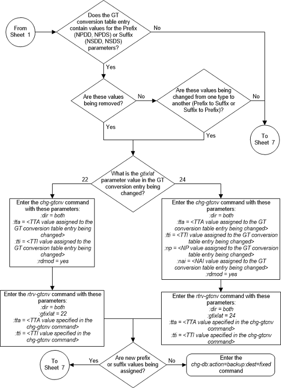

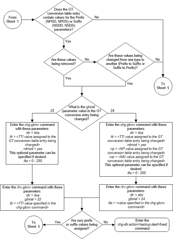

If the rdmod=yes parameter is specified with the chg-gtcnv command, the npdd, npds, nsdd, and nsds parameters cannot be specified.
If the npdd, npds, nsdd, or nsds parameters are specified with the chg-gtcnv command, the rdmod=yes parameter cannot be specified.
The optional prefix (npdd, npds) and suffix parameters (nsdd, nsds) can be specified, but both sets of parameters, or a mixture of the prefix and suffix parameters cannot be specified. For example, if the either the npdd or npds parameters are specified, the nsdd and nsds cannot be specified. If either the nsdd or nsds parameters are specified, the npdd and npds parameters cannot be specified.
The prefix or suffix parameter values assigned to a GT Conversion Table entry can be changed from one type to another type, (prefix parameter values to suffix parameter values or suffix parameter values to prefix parameter values). To change the prefix values to suffix values or suffix values to prefix values, the existing prefix or suffix values must be removed from the GT Conversion Table entry by specifying the rdmod=yes with the chg-gtcnv command. After the existing prefix or suffix values have been removed, the new prefix or suffix values can be assigned to the GT Conversion Table entry with the npdd and npds, or nsdd and nsds parameters.

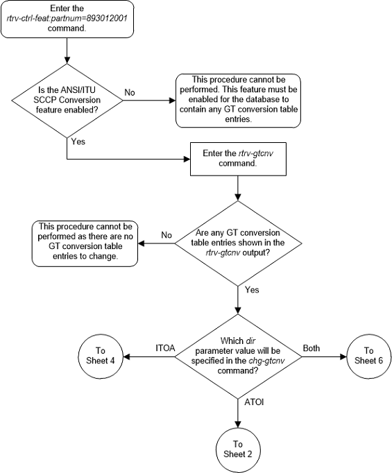

  1. Verify the status of the ANSI/ITU SCCP Conversion feature by entering the rtrv-ctrl-featcommand with the ANSI/ITU SCCP Conversion feature part number.
    Enter this command.
    rtrv-ctrl-feat:partnum=893012001
    The following is an example of the possible output.

    If the ANSI/ITU SCCP Conversion feature has not been enabled or is not on, this procedure cannot be performed.
  2. Display the GT Conversion Table entries by entering the rtrv-gtcnv command.

    If no entries are shown in the rtrv-gtcnv output, this procedure cannot be performed.

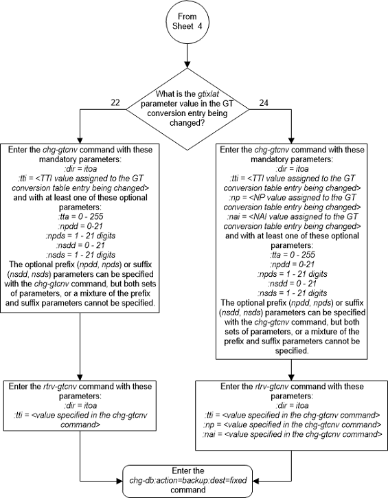

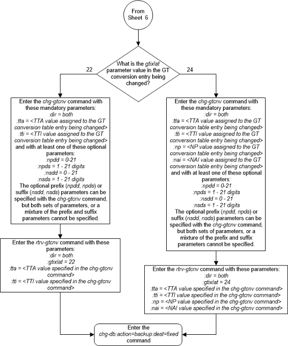

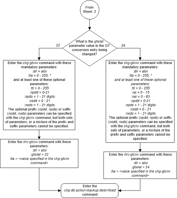

  3. Change the desired GT Conversion Table entry by entering the chg-gtcnv command with the rdmod=yes parameter, and with appropriate parameter combinations shown in the following list and with the values for these parameters shown in the rtrv-gtcnv output in 2.
    • dir=atoi, tta.
      If the gtixlat parameter value is 22, the optional parameter tti=<0-255> can be specified with the chg-gtcnv command. If the gtixlat parameter value is 24, the optional parameters tti=<0-255>, np=<0-15>, nai=<0-63>, can be specified with the chg-gtcnv command.
    • dir-itoa, gtixlat=22, tti.
      The optional parameter tta=<0-255> can be specified with the chg-gtcnv command.
    • dir=itoa, gtixlat=24, tti, np, nai.
    • dir=both, gtixlat=22, tta, tti
    • dir=both, gtixlat=24, tta, tti, np, nai
    The gtixlat parameter cannot be specified with the chg-gtcnv command, but is used to determine the parameter combinations that must be specified with the chg-gtcnv command.

  5. Change the desired GT Conversion Table entry by entering the chg-gtcnv command with appropriate parameter combinations shown in Table 2-59 and with the values for these parameters shown in the rtrv-gtcnv output in 2.
    If 3 and 4 were performed, and no other changes are being made to the GT Conversion entry, do not perform this step. Continue the procedure with 7.

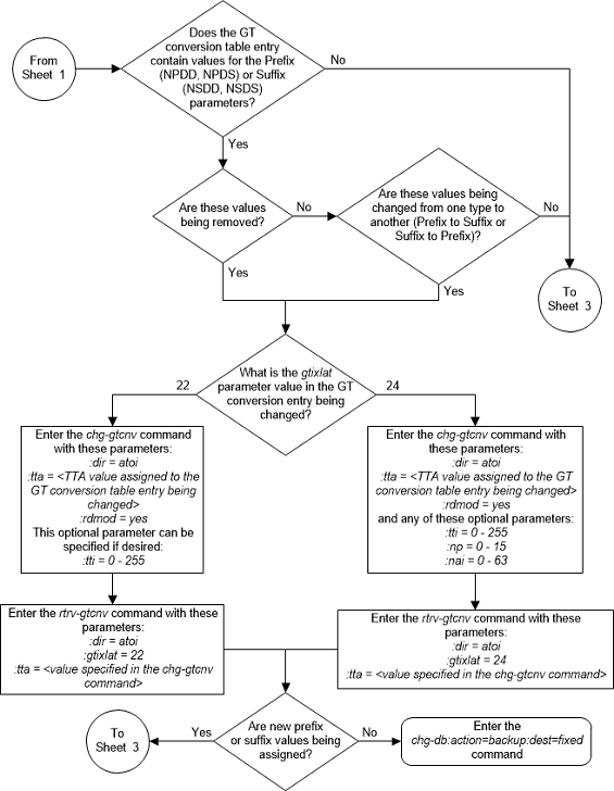

Figure 2-159 Change a GT Conversion Table Entry - Sheet 1 of 7
Figure 2-160 Change a GT Conversion Table Entry - Sheet 2 of 7
Figure 2-161 Change a GT Conversion Table Entry - Sheet 3 of 7
Figure 2-162 Change a GT Conversion Table Entry - Sheet 4 of 7
Figure 2-163 Change a GT Conversion Table Entry - Sheet 5 of 7
Figure 2-164 Change a GT Conversion Table Entry - Sheet 6 of 7
Figure 2-165 Change a GT Conversion Table Entry - Sheet 7 of 7
