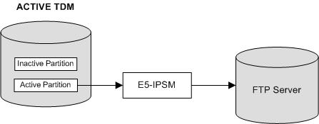

When the database is backed up to the FTP server, the database on the active partition of the active TDM is packed and compressed into a TAR file andsends the file to the FTP server through an E5-IPSM. Figure D-1 illustrates this action.
Figure D-1 Backup of the Database to the FTP Server

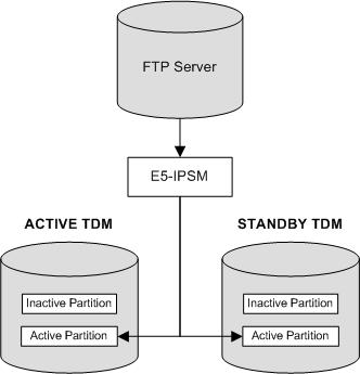

When the database is restored from the FTP server, the TAR that contains the database that is being restored is retrieved by EAGLE through an E5-IPSM. The TAR file is unpacked and uncompressed and the database files are placed on the active partition of both TDMs. Figure D-2 illustrates this action. The EAGLE must be reinitialized to load the restored database to all the cards.
Figure D-2 Restoring the Database from the FTP Server
