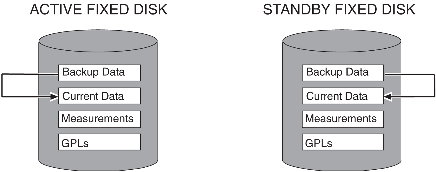

    The action of this command is shown in Figure 2-6.
    Figure 2-6 Restore Action on the Fixed Disk
