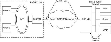

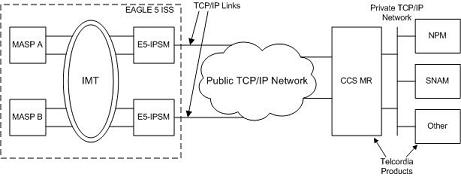

Dual SEAS Terminals with a Single CCS MR SEAS Configuration
The two SEAS terminals are connected to a single CCS MR as shown in Figure 5-1. The two SEAS terminals operate in a redundant fashion allowing a maximum of two active connections to the CCS MR. While the connection to the CCS MR is dedicated to SEAS, the other terminals on the E5-IPSM may still be used for other IP-based operations, such as Telnet and FTP, or their secure counterparts, SSH and SFTP. Different SEAS information can be transmitted and received separately over each connection to the CCS MR.
Figure 5-1 Dual SEAS Terminals with Single CCS MR SEAS Configuration

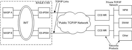

Dual SEAS Terminals with Dual CCS MRs SEAS Configuration
When the two SEAS terminals are connected to two CCS MRs, as shown in Figure 5-2, the operation of the SEAS connections is similar to the "Dual SEAS Terminals with a Single CCS MR SEAS Configuration" section with the following exceptions:
Figure 5-2 Dual SEAS Terminals with Dual CCS MRs SEAS Configuration
