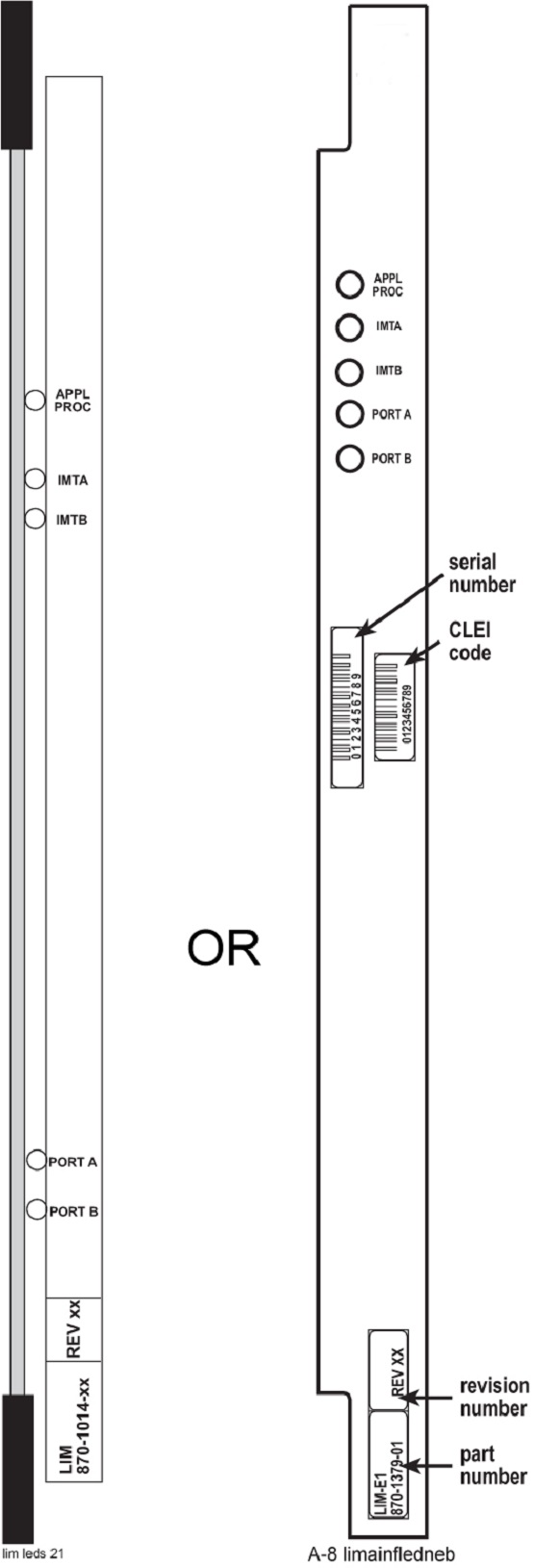

  2. Visually check the IMTLEDS on the front of the cards.
    A red LED or LEDs denotes an IMT fault. If the top LED of the pair is red, there is a fault on IMT A. If the bottom LED is red, there is a fault on IMT B. See Figure 3-3.
    Figure 3-3 Card LEDs
  3. Note the card location or locations for cards with a red LED(s).
