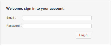

    The Login page displays.
    This screenshot shows the login page.
  3. Enter your email and password, respectively, in the Email and Password fields.

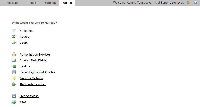

  4. From the Main Menu, click Admin. The following page displays.
    This screenshot shows the Admin page.
  5. Click Sites.

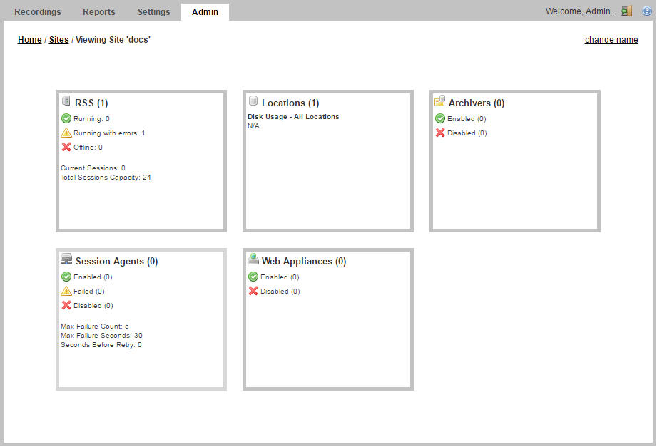

  6. Click the Details icon (This image shows the Details icon.) associated with a site that you want to edit. The following pages displays.
    This screenshot shows the Sites page.

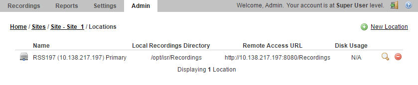

  7. Click on the Locations component. The following page displays.
    This screenshot shows the Locations page.

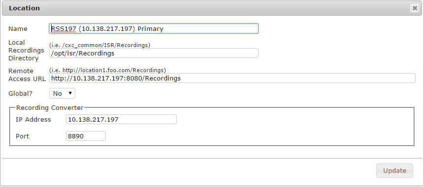

  8. Click the to edit the configuration of that location. The following dialog box displays.
    This screenshot shows the Location configuration page.
  9. In the "Recording Converter" section, in the Converter IP Address field, specify the RMC IP address.
  10. If the RMC is listening to XML-RPC requests on a port other than the default (Port 8890), specify the correct converter port number in the Converter Port field.
  11. Click Update to update the location with the RMC information.
