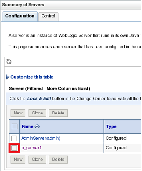

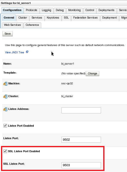

Enable HTTPS on the WebLogic Server
To encrypt the communication between BIP and SDM, first enable HTTPS on the WebLogic server.
In a cluster setup, repeat this task for each BIP server.
