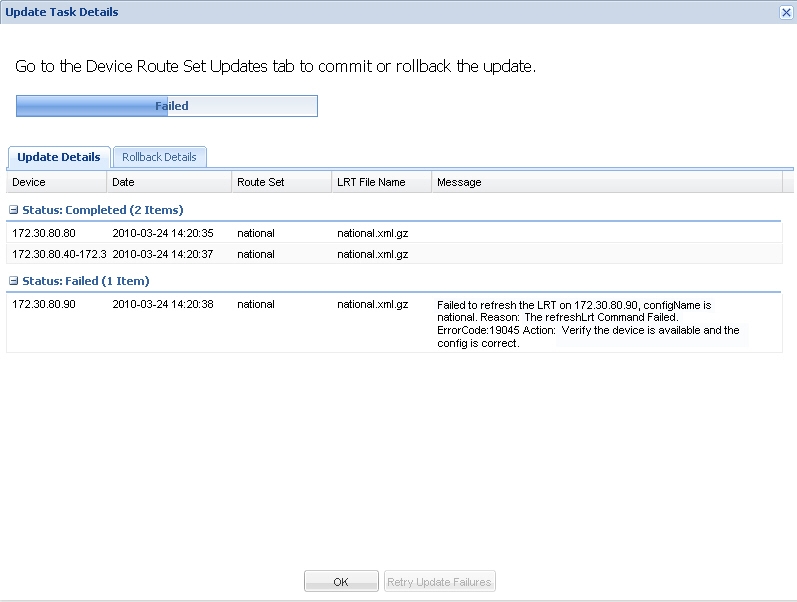

If the update task fails, the progress bar reflects
the failed status and a message appears in the
Update
Details table. For example:

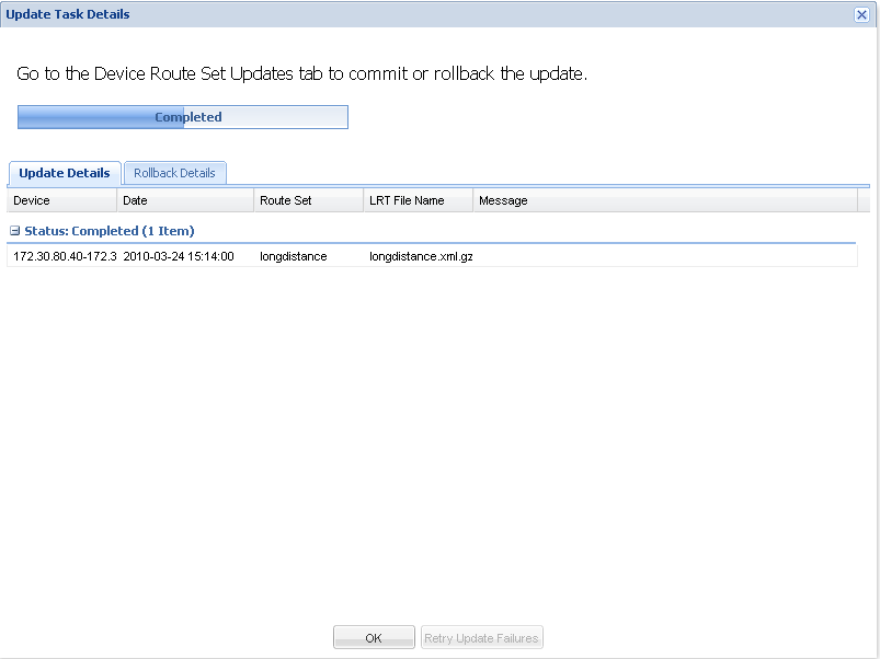

If the update task succeeds, the progress bar
reflects the completed status and the devices appear under the
Status:Completed
section of the table. For example:
