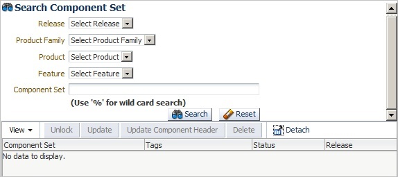

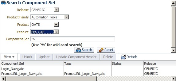

The Search pane of the Component Set page lets you search for specific component sets:
You can select the Release, Product Family, Product, Feature, and Component Set to narrow the search criteria. You can also use the % wildcard character in the Component Set field to narrow the search:
Figure 4-6 Search Component Set Options with Search Criteria

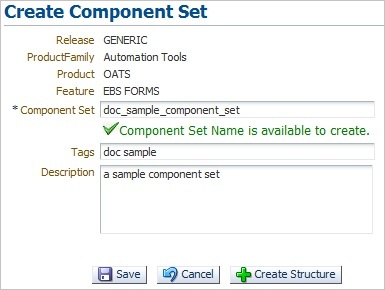

In the Create Component Set pane, enter a Component Set name, Tags and Description.
The component set name should be between 5 and 30 characters. The Component Set Name is available to create check mark appears if the name does not currently exist in the database.

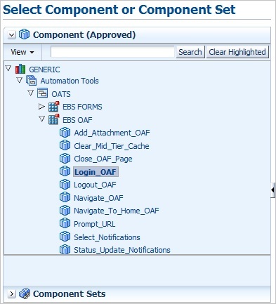

Click Create Structure. The Select Component or Components Set and the New Component Set pane opens for specifying the components or component sets to add to the new component set.
Expand the Component or Components Sets tree to view the available components or component sets.
Figure 4-10 Select Component Set Pane with Expanded Components Tree
Right-click the component or component set to add to the New Component Set and click Move. You can also click-and-drag components to the New Component Set tree.
Repeat step 6 to add additional components or component sets to the New Component Set as needed.

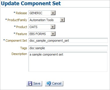

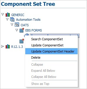

To update component set header:
Expand the Component Set Tree to the component set you want to update.
Right-click the Component Set name and select Update Component Set Header from the shortcut menu.
Figure 4-12 Update Component Set Header Option of the Shortcut Menu
In the Update Component Set pane, edit the Component Set name, Tags and Description.
Click Save when finished to save and exit the Update Component Set pane. The Search pane indicates Updated Component Set <set name> Successfully.

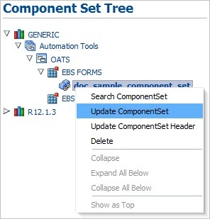

To add a component or component set to an existing component set:
Right-click the Component Set name and select Update Component Set from the shortcut menu.
Figure 4-14 Update Component Set Option of the Shortcut Menu
Figure 4-16 Select Component Set Pane with Expanded Components Tree

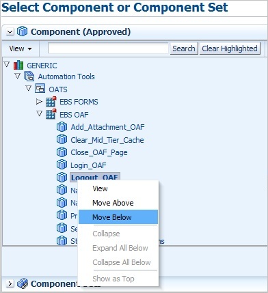

Select a component or component set in the New Component Set tree where you want to add the new component or component set.
Right-click the component or component set in the Select Component or Component Set tree that you want to add to the New Component Set and click Move Above or Move Below.
Figure 4-18 Move Options of the Shortcut Menu

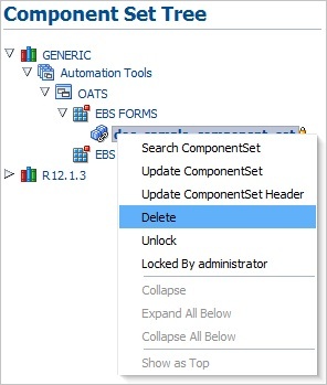

To delete component sets from the Component Set tree:
Expand the Component Set Tree to the component set you want to remove from the component set tree.
Right-click the Component Set name and select Delete from the shortcut menu.
Figure 4-22 Delete Component Set Option of the Shortcut Menu
Click Yes to confirm.
Click OK.

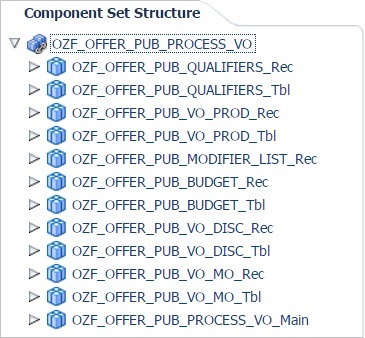

Component Sets for PLSQL or Open Interface have specific component sequences that should be used when creating Component Sets. This section provides guidelines for creating these Component Sets.
A PLSQL procedure is a combination of multiple components such as:
PLSQL Procedure component
PLSQL Record Component
PLSQL Table Component
PLSQL Object Component
A PLSQL Component Set is a set of components which are required to execute a specific procedure.
PLSQL procedure component should come as a the last component in the Component Set.
All the other components, such as record, table, etc., should be above the procedure component in the sequence.
All the components should be added into the Component Set based on the parameter sequence.
If there is a table component and this table is defined for records or objects, then components should be added as follows:
Record or Object Component
Table Component
Sequence of Components in the component set should be a follows:
All the Record, Table or Object Components which are to be passed as input to the procedure.
All the Record, Table or Object Components which are returned as output from the procedure.
Procedure Component.
The following figure shows an example PLSQL Component Set with a sequence of components:

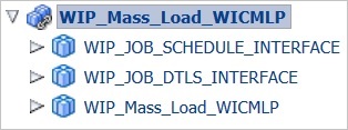

An Open Interface Component Set is a set of components which are required to execute a specific concurrent request after insertion of data into temporary tables.
An Open interface Component Set is a created in the following sequence:
Inset Table components
PLSQL Procedure Component
The following figure shows an example Open Interface Component Set with a sequence of components:

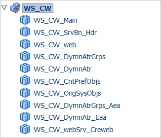

A WebService Component Set is a set of components required to execute a Webservice payload. Webservice payload has multiple components such as Webservice Structure and Webservice node components.
A WebService Component Set is a created in the following sequence:
Webservice Structure Component
Webservice Node Component
