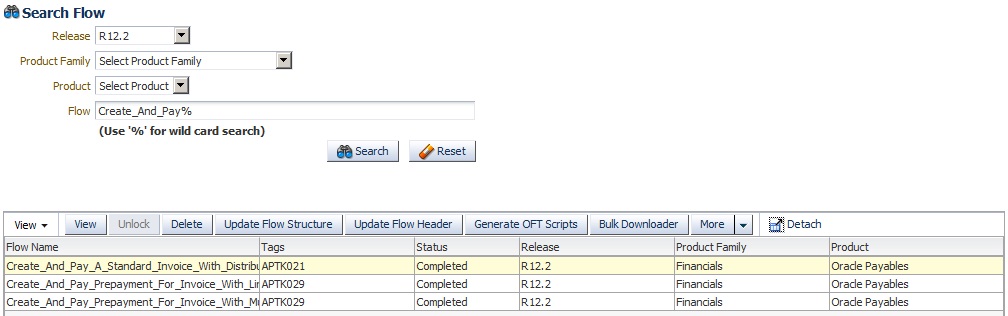

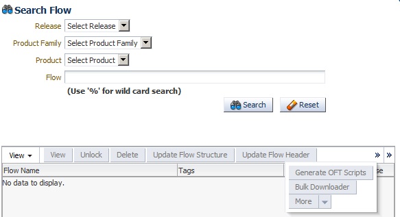

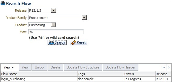

The Search pane of the Flow page lets you search for specific flows:
You can select the Release, Product Family, Product, and Flow to narrow the search criteria. You can also use the % wildcard character in the Flow field to narrow the search:
Figure 5-6 Search Flow Options with Search Criteria

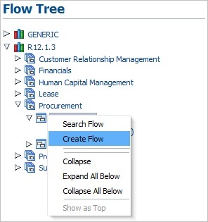

Expand the Flow Tree to the product feature where you want to add the flow.
Right-click the Feature name and select Create Flow from the shortcut menu
Figure 5-7 Create Flow Option of the Shortcut Menu

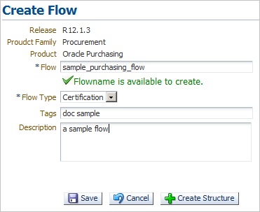

In the Create Flow pane, enter a Flow name, Flow Type, Tags and Description.
The flow name should be between 5 and 30 characters. The Flow name is available to create check mark appears if the name does not currently exist in the database.

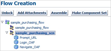

Click Create Structure. The Select Component or Components Set and the Flow Creation pane opens for specifying the components or component sets to add to the new flow and a new scenario is added to the flow tree. A scenario defines a specific OpenScript child script name within the overall flow. See Section 5.2.1, "Adding Scenarios to a Flow" for additional information about adding scenarios to a flow.

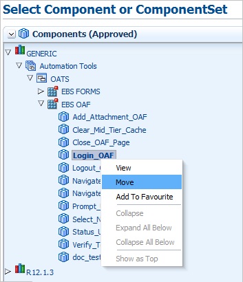

Expand the Flow tree and select the scenario where you want to add components or component sets.

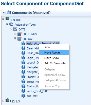

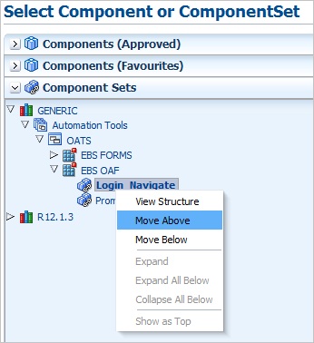

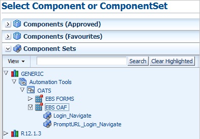

Expand the Components (Approved), Components (Favourites), or Components Sets tree to view the available components or component sets.
Figure 5-11 Select Component Set Pane Shortcut Menu
Right-click the component or component set to add to the Flow Creation tree and click Move (or click and drag the component or component set to the flow tree).

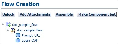

Figure 5-12 Flow Creation Pane with Components Added
Repeat steps 5-7 to add additional components or component sets to the Flow Creation tree as needed. Select Move Above or Move Below to add the component or component set above or below the currently selected component or component set in the Flow Creation tree.

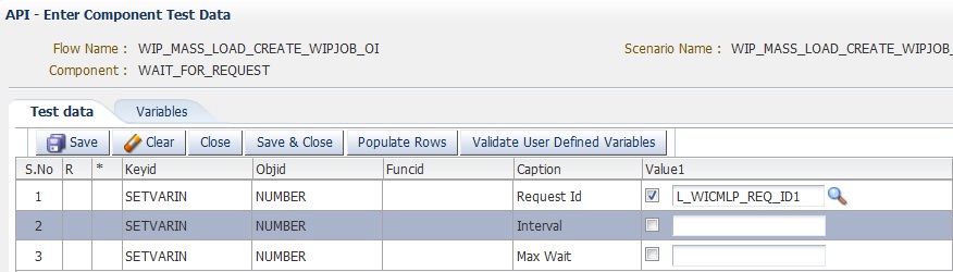

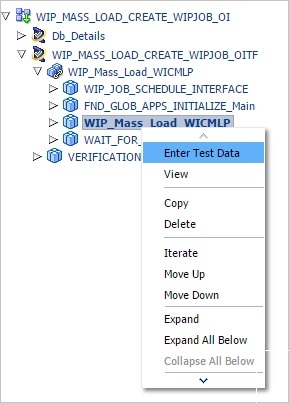

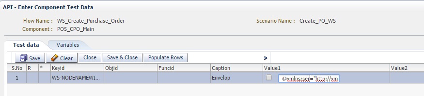

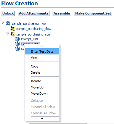

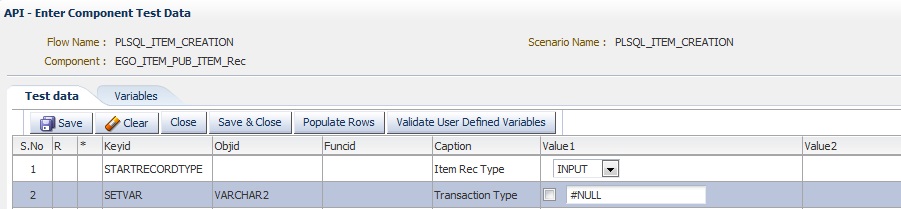

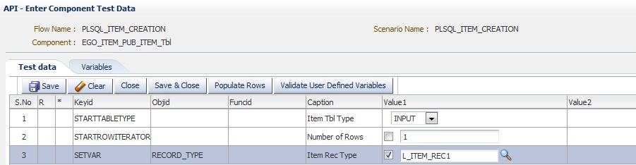

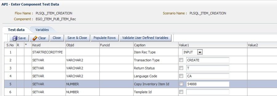

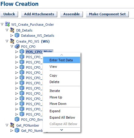

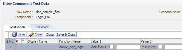

Right-click a component in the Flow and select Enter Test Data from the shortcut menu. You can also download a Test Data Excel file for the flow, enter the Test Data for the flow into the Excel file, then upload the Excel file. See Section 5.2.2, "Entering Test Data Using an Excel File" for additional information about entering Test Data using an Excel file.
Figure 5-14 Flow Creation Pane Enter Test Data Shortcut Menu Option

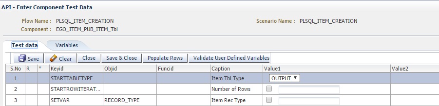

Enter the Test Data required for the component.
Figure 5-15 Enter Component Test Data Window

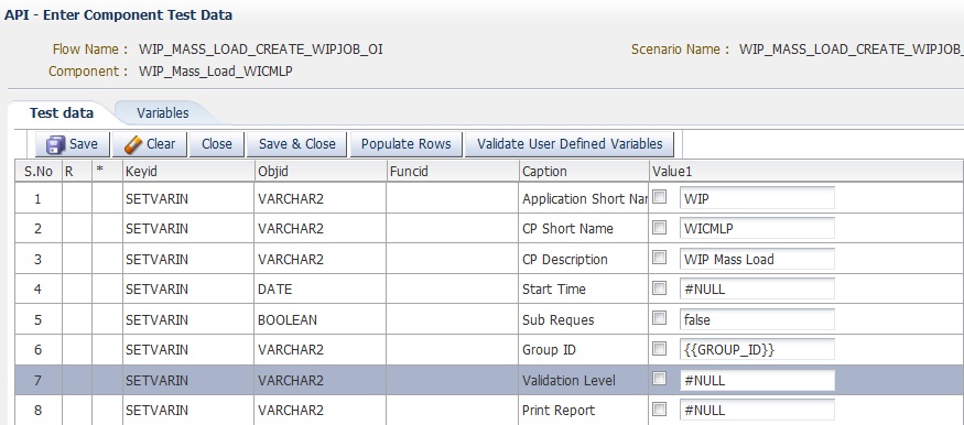

The following are guidelines for entering Test Data for component objects:
Rerunable: For fields marked Rerunable in the component code, the Test Data is entered as "?Value" in the Value column. For example, the Test Data entered for Username field would be ?RTUser. Rerunable fields are indicated with an "R" in the R (Rerunable) column in the Test Data entry screen.
Mandatory: Test data is mandatory for all fields marked as Mandatory=Yes in the component code. Mandatory fields are indicated with an asterisk in the * (Mandatory) column in Test Data entry screen.
Value field checkbox: Select the checkbox in value fields if the value is to be passed as a variable. When checked, the text field for the value changes to a list of values (LOV) listing all variable names from previous components in the flow. Variable s are appended with sequence number, for example, var1, var2, etc. If data is not provided to any field in "Enter Test Data", the code for that line would not be generated in the OpenScript script.
Button objects: For button object clicks, select True/False. Test data input is required only if the button object keyword is enclosed in Optional tags.
Checkbox objects: For checkbox object clicks, enter True to select the checkbox, False to clear the checkbox. Test data input is required only if the checkbox object keyword is enclosed in Optional tags.
Date fields: For date fields, Test data is entered for different date requirements as follows:
To empty the value in a Date field enter: #EMPTY
To specify the date format as DD_MMM_YYYY enter: #RAND(2_3_4)
To add n days to system date enter: #SYSDATE(+n) Ex. #SYSDATE(+2)
To subtract n days to system date enter: #SYSDATE(-n) Ex. #SYSDATE(-2)
To use the System Date enter: #SYSDATE(0)
Function calls: For calls to library functions, the data entered is specific to the function called. See the library reference for additional details.
Link objects: For Link object clicks, select True to click the link. Test data input is required only if the link object keyword is enclosed in Optional tags.
Menu selection: For simple menu selections, enter the menu names separated by the pipe (|) character. For example, File|Open. Test data input is required only if the menu object keyword is enclosed in Optional tags.
Navigation (Forms): To handle navigation to a form from the forms navigator, enter data as follows in the Navigate component:
Security,User,Define
Navigation (OAF): To handle navigation to a form or OAF page with multiple drill menus from the application home page such as: Purchasing, Vision Operations (USA)- Setup-Profile Management Configuration-Organization Encryption, enter data as follows in the Navigate component:
Resp: Purchasing, Vision Operations (USA)
Menu Path: Setup,Profile Management Configuration
Menu Choice: Organization Encryption
Radio button objects: For Radio button object clicks, enter True to select the Radio button, False to clear the checkbox. Test data input is required only if the Radio object keyword is enclosed in Optional tags.
Text/Text Area objects: Enter the value to input into the text/textarea field.
Wait: For Wait for all objects: No Test Data required. Wait uses the default wait time. For Wait > Normal: No Test Data required. Wait uses the default wait time.

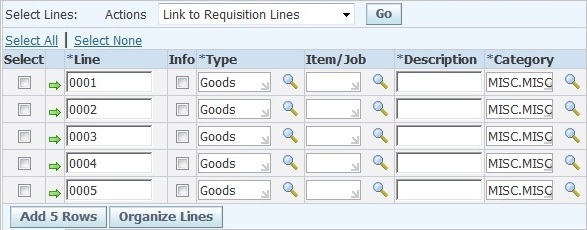

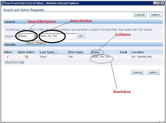

Webtable/Forms table-Entry: For components containing tables in forms / Web, enter Test Data for "Enter Line Number" or similar Display Name as the line number where values are to be entered. For example, to enter data for the 1st line in the form or table, enter 1 as the Test Data.
Figure 5-16 Test Data for Webtable/Forms-Entry
Webtable/Forms table-Verify/Update: For components that require updating a line in a table or performing an action on any element in a table, the Test Data entered is the unique column name.For example, if the action to perform is check the checkbox in the "Select" column for *Member = Stock, Ms.Pat, then the Test Data to be entered for the Search column specified as "*Member" is "Stock, Ms Pat".
Figure 5-17 Test Data for Webtable/Forms-Verify/Update
WEBSELECTLOV Function: Test data entry for the WEBSELECTLOV Function corresponds to the following:
Figure 5-18 Test Data Locations for WEBSELECTLOV Function
Click Save and Close when finished.

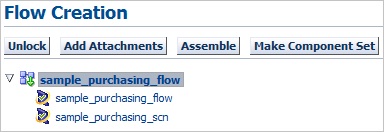

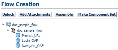

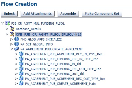

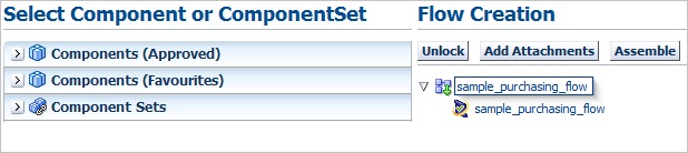

Set the status of the flow as necessary for the current state of development:
Click Unlock at any time when adding components and entering Test Data to save and exit the Flow Creation pane. The Search pane indicates Published Flow Successfully. The Flow is set to In Progress status and can be changed and updated as necessary.
Click Assembled when finished entering the Test Data for all the components and exit the Flow Creation pane. The Search pane indicates Assembled Flow successfully. The flow is set to Assembled status. When the flow is in Assembled status, the flow cannot be updated or changed. The flow status must be changed to Stabilizing to make any updates. Change the status to Stabilizing by right clicking on the flow name in the flow tree.
When a flow is in Assembled status, it can be evaluated by an Automation Team member who changes the status to Stabilizing. The automation user can update the flow if required. When in the Stabilizing status, the automation user generates and executes the OpenScript scripts and tests if the scripts generated from the flow are executing properly. The automation user determines if changes are required to update the components in the flow and continue stabilizing the flow. Once the automation user stabilizes the flow completely, an Automation POC verifies the flow and OpenScript scripts and changes the flow status to Completed.

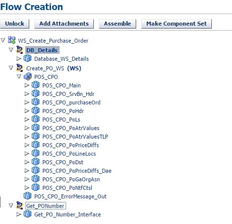

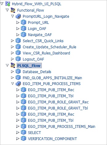

When you create a flow structure, a scenario name is automatically created to define the OpenScript child script name. Each scenario in a flow corresponds to an OpenScript child script. A flow may have only one scenario or it can have multiple scenarios depending upon the flow and the automation process the flow designer is developing.
The number of scenarios in a flow depends upon the user/automation process the flow designer is developing.
If the flow is small requiring only a few steps (components or component sets) to complete the flow, only one scenario may be required which will create the MASTERDRIVE script and one OpenScript child script. There is no need to add additional scenarios to the flow.
If the purpose of the flow is to automate multiple functional scenarios in one flow, then the better practice is to break the flow into multiple scenarios (and create multiple OpenScript child scripts) under one flow.
If a flow is to automate a lengthy end-to-end scenario, the better practice is to break the flow into multiple simple scenarios to make it easier to execute and troubleshoot the OpenScript child scripts, if necessary.

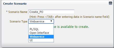

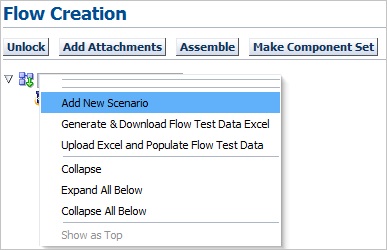

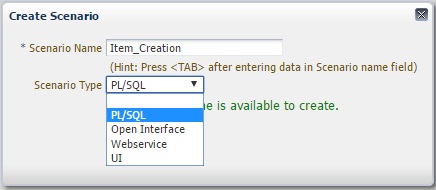

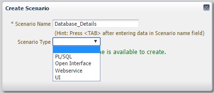

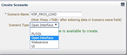

To add scenarios to the flow tree:
Open the flow tree and select the flow name.
Right-click the flow name and select Add New Scenario from the shortcut menu.
Figure 5-19 Add New Scenario Shortcut Menu

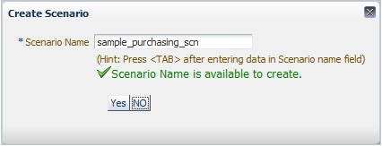

Enter a scenario name, then press the Tab key. The Scenario Name is available to create check mark appears if the name does not currently exist in the database.
Click Yes.
Click OK to confirm.
Add components and/or component sets to the flow tree under the scenario name.
When you generate the OpenScript scripts, each scenario name will correspond to an OpenScript child script along with the MASTERDRIVE script.

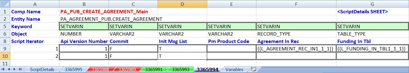

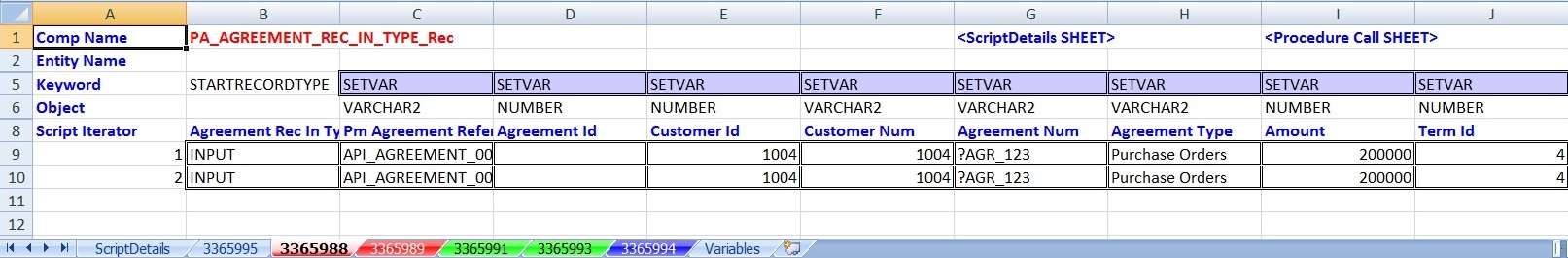

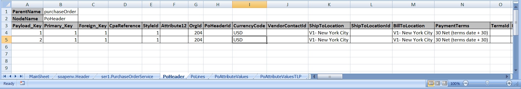

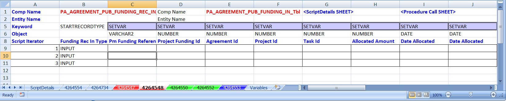

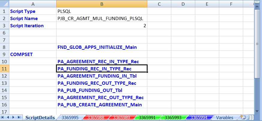

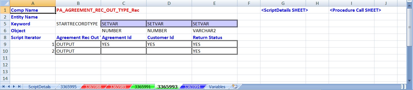

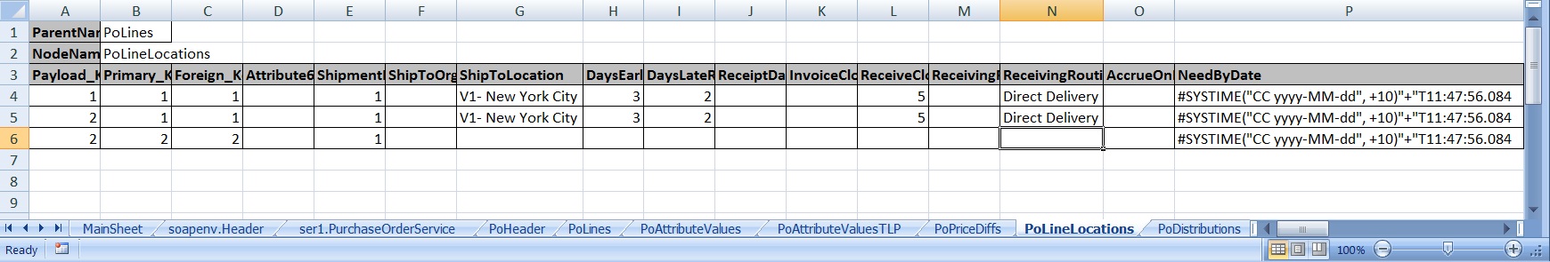

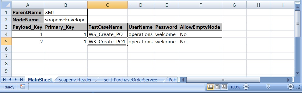

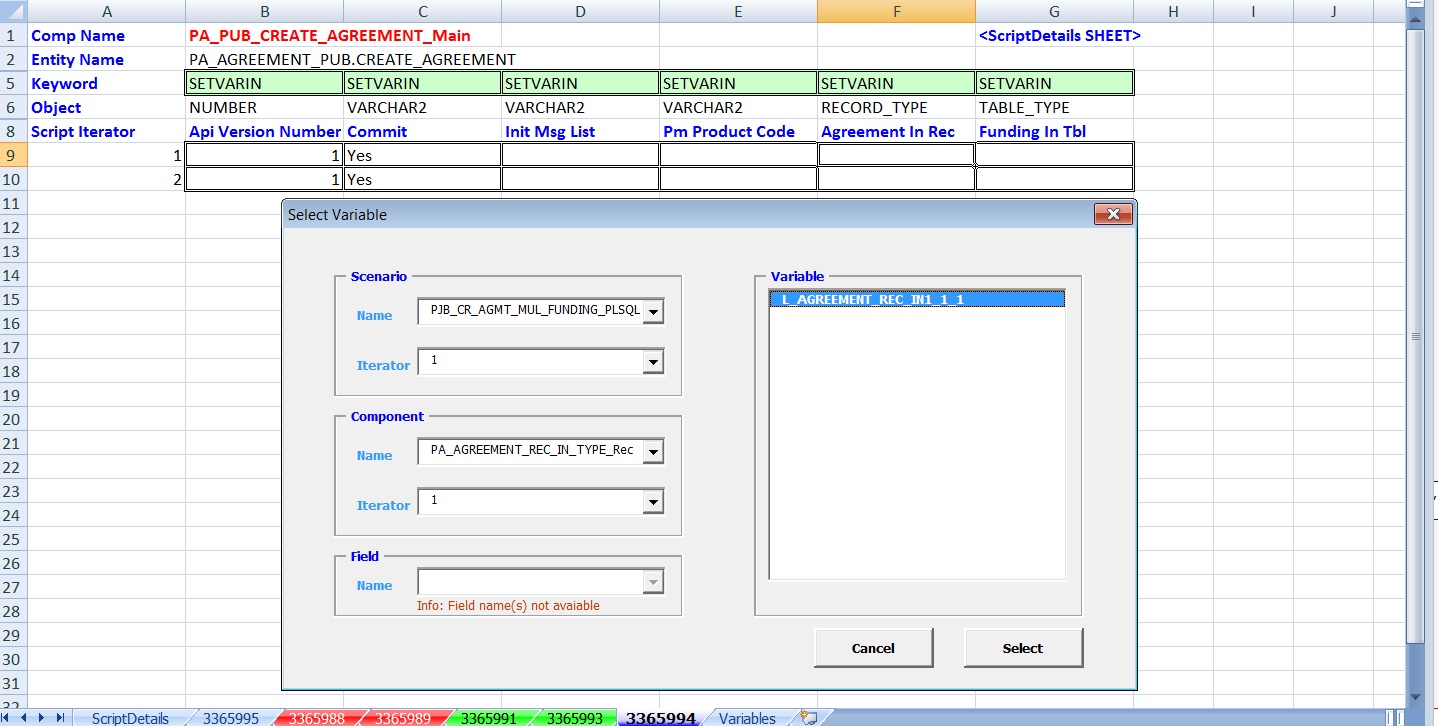

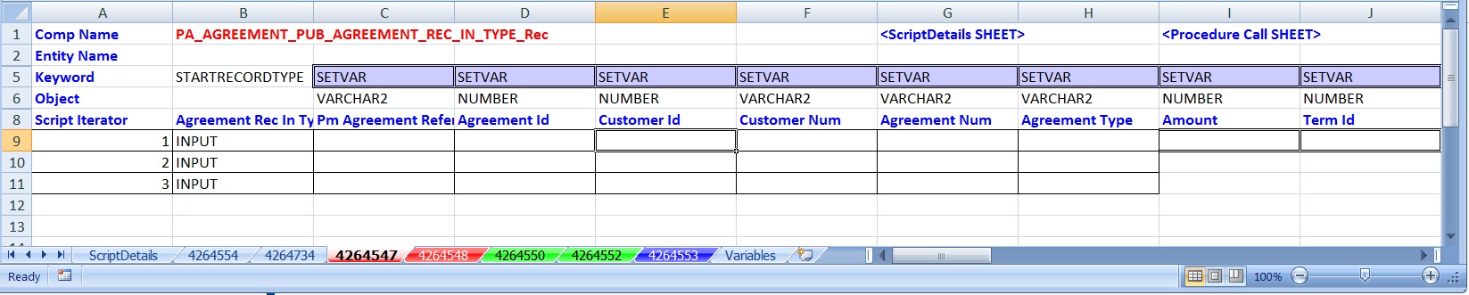

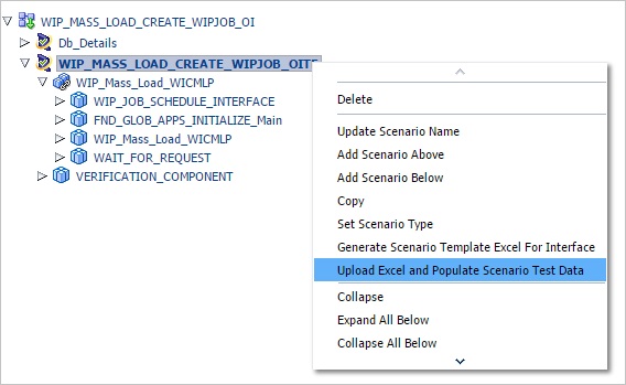

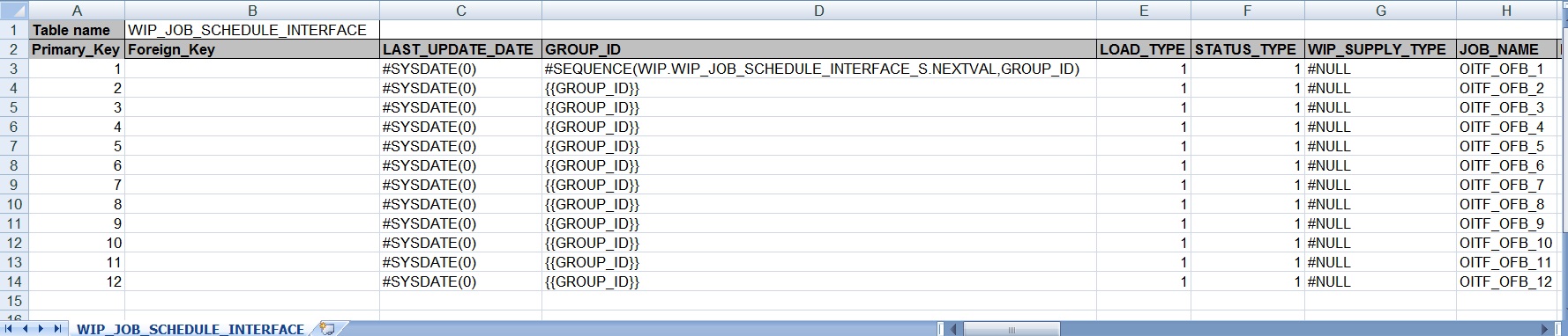

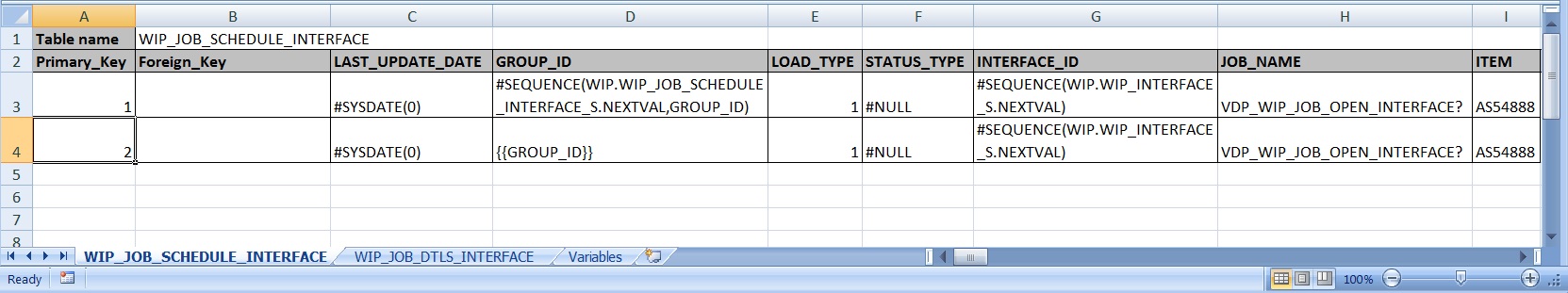

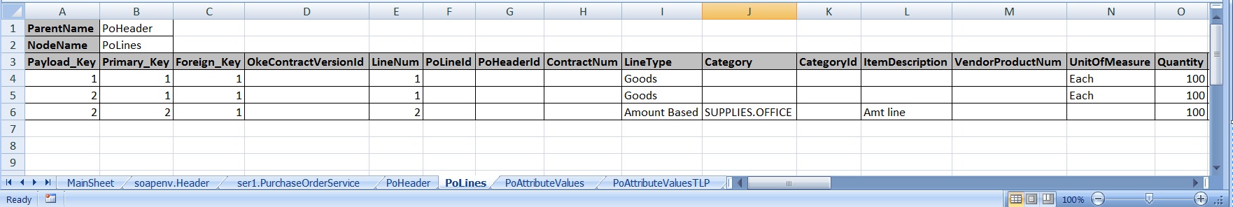

You can enter Test Data for an entire flow into an Excel file and then upload the Excel file to the flow. The basic steps are as follows:
Download the test Data Excel file for the flow.
Enter the Test Data into the Excel file.
Upload the Test Data Excel file to the flow.
Populate the flow with the Test Data.

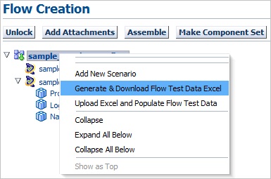

To enter Test Data for a flow using an Excel file:
Create a new flow or search for an existing flow.
Select Update Flow Structure.

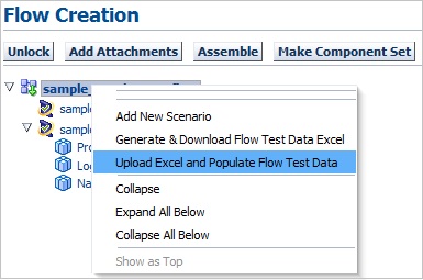

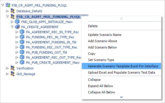

Right-click the flow name in the Flow Creation pane and select Generate & Download Flow Test Data Excel from the shortcut menu.
Figure 5-21 Flow Creation Pane Generate & Download Excel Shortcut Menu Option
Select Save and specify the location to save the Excel file.

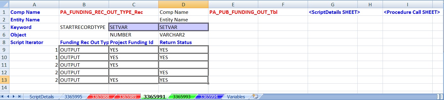

Edit the Excel file to enter the Test Data for the flow and save the Excel file.

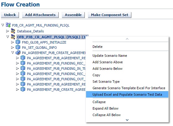

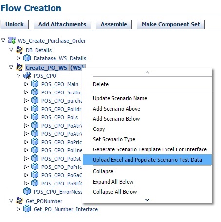

Right-click on the flow name in the Flow Creation pane and select Upload Excel and Populate Flow Test Data from the shortcut menu
Figure 5-22 Flow Creation Pane Upload Excel Shortcut Menu Option
Select the Excel file for the flow Test Data and click Start. Close the Browse dialog box after successfully uploading the file. The data will be populated to all components in the flow.

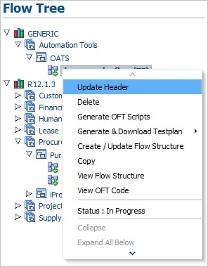

Existing flows can be updated to add or remove components or components sets from a flow or change Test Data.

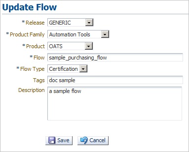

To update a flow header:
Expand the Flow Tree to the flow you want to update.
Right-click the flow name and select Update Header from the shortcut menu.
Figure 5-23 Update Header Option of the Flow Tree Shortcut Menu
In the Update Flow pane, edit the Release, Product Family, Product, Flow name, Flow Type, Tags and Description.
Click Save when finished to save and exit the Update Component Set pane. The Search pane indicates Updated Flow <name> Successfully.

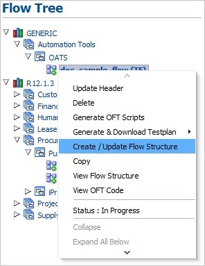

To add a component or component set to an existing component set:
Right-click the Flow name and select Create/ Update Flow Structure from the shortcut menu.
Figure 5-25 Create/Update Flow Structure Option of the Flow Shortcut Menu

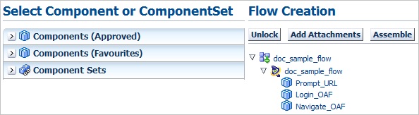

The Select Component or Components Set and the Flow Creation pane opens for specifying the components or component sets to add or update in the Flow.
Figure 5-27 Select Component Set Pane with Expanded Components Tree
Expand the Flow Creation tree to view the existing components or component sets.
Figure 5-28 Flow Creation Pane with Components Added
Select a component or component set in the Flow Creation tree where you want to add the new component or component set.
Right-click the component or component set in the Select Component (Approved), Select Component (Favourites) or Component Set tree that you want to add to the Flow Creation tree and click Move Above or Move Below.
Figure 5-29 Move Options of the Shortcut Menu

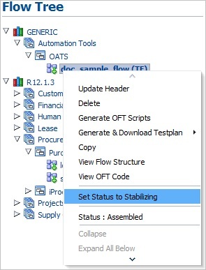

To change the flow to Stabilizing status, right-click the flow name in Flow Tree and select Set Status to Stabilizing.
Figure 5-31 Flow Tree Set Status to Stabilizing Shortcut Menu Option

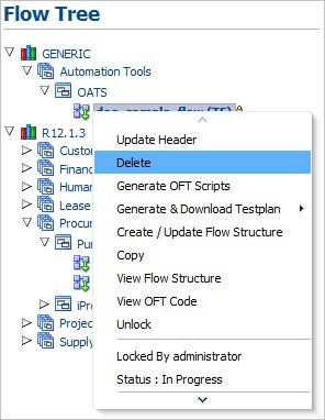

To delete flows from the Flow tree:
Expand the Flow Tree to the flow you want to remove from the flow tree.
Right-click the Flow name and select Delete from the shortcut menu.
Figure 5-32 Delete Flow Option of the Shortcut Menu
Click Yes to confirm.
Click OK.

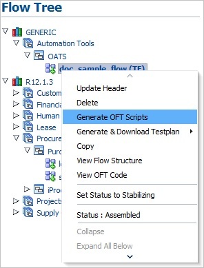

To generate OpenScript script code from an existing flow:
Expand the Flow Tree or use the search options to select the flow to use to generate OpenScript code.
Select Generate OFT Scripts from the Flow Tree shortcut menu or the search pane.
Figure 5-33 Generate OFT Scripts Option of the Shortcut Menu
Enter the Execution location folder.
Enter the Normal wait time.
Enter the Page wait time.
Select if the script is rerunable or not.
If Rerunable, select the time zone, specify the Rerun type.
Select the time zone.
Click Download Suite.

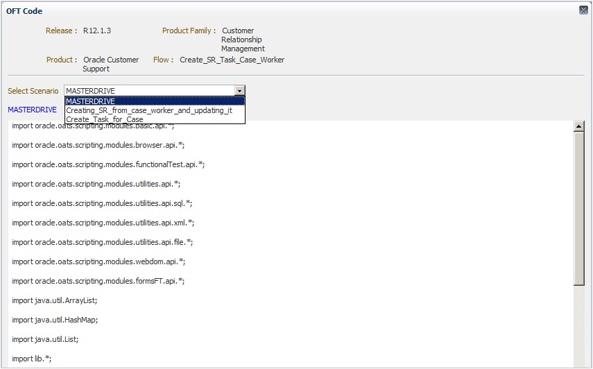

To view OpenScript script code from an existing flow:
Expand the Flow Tree or use the search options to select the flow to use to view OpenScript code.
Select View OFT Code from the Flow Tree shortcut menu.
Figure 5-34 View Code Window Showing OpenScript Code for a Flow
Select the MASTERDRIVE or flow scenario name from the Select Scenario list to view the OpenScript code for the specific flow.
Click the [X] button to close the code view when finished.

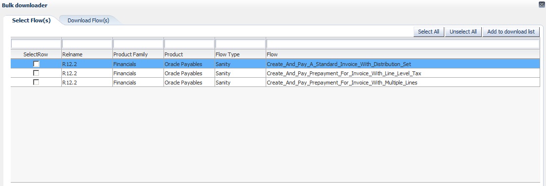

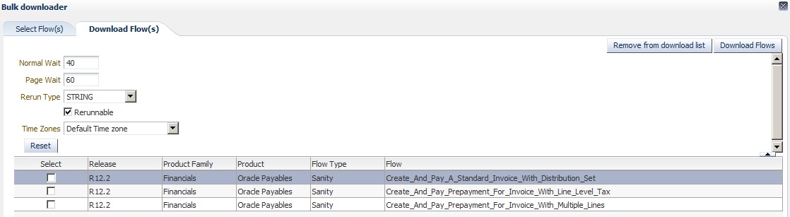

The Bulk Downloader lets you select and download multiple flows as generated OFT scripts.
To download multiple flows as generated OFT scripts:
Search for the flows you want to download using the Search criteria.
Figure 5-35 Search Pane with Search Criteria and Results
Select a flow in the Search Results.
Click the Bulk Downloader button.
Figure 5-36 Bulk Downloader with Flows Available for Download
Select the flows to include in the download by selecting the Select Row check box for the flow(s) or the Select All/Unselect All buttons.
Click the Add to download list button.
Click the Download Flow(s) tab.
Figure 5-37 Bulk Downloader with Flows Added for Download
Set the Wait times, Rerun Type, Rerunable option, and Time Zone.
Click the Download Flows button. Depending upon the number of flows selected, it may take a few moments for Oracle Flow Builder to generate the OFT scripts and create the BulkDownload_Administrator_#.zip file.
When the File dialog box appears, select Save File and click OK.
Save the BulkDownload_Administrator_#.zip file.
Extract the zip file into the OpenScript repository.
Start OpenScript.
Open and playback the MASTERDRIVE script located in the flowname folder. The MASTERDRIVE script executes the script containing the OpenScript code for the flow. You can also open the script with the flow code in OpenScript to view the Tree View and Java Code.
You can generate a Test Plan document for flows using the Generate & Download Test Plan option on the More menu of the Search pane.
To generate sand download a Test Plan for a flow:
Search for the flow you want to generate and download a Test plan for using the Search criteria.
Select the Flow name in the Search Results.
Select the Generate & Download Test Plan option on the More menu.
Select the file location and click Save.
Extract the flowname.zip file to view the .doc, .html, or .log file in the appropriate editor/viewer.

Oracle Flow Builder provides the flexibility to create hybrid flows. For example, a flow can have combination of different interfaces and GUI.

Oracle Flow Builder supports creation of flow for execution of PLSQL procedures with single and Multiple Test Data. OFB PLSQL flow can be created as follows:
Use an Oracle Flow Builder Flow scenario to provide database details.
Create Scenario by right clicking on the flow and selecting Add New Scenario. Provide the following details in the Create Scenario dialog box.
Scenario Name
Scenario Type as Empty
Figure 5-38 Create Scenario Details: Database
Drag the component "Database_WS_Details" into the scenario.
Each procedure call should have one Flow scenario.
A separate scenario is to be created after PLSQL procedure execution scenario for verification of data and to retrieve any data from the database using queries. The following components are required for verification and select query:
Verification Components - for verification of data.
Select Components - to retrieve data from the database.
Create Scenario by right clicking on the flow and selecting Add New Scenario. Provide the following details in the Create Scenario dialog box as follows:
Scenario Name
Scenario Type as "PL/SQL"
Figure 5-39 Create Scenario Details: PL/SQL
The Scenario Type will be displayed next to the scenario names as "(PLSQL)".

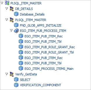

A PLSQL scenario should have following structure:
Add components related to PLSQL initialization like FND_GLOBAL.APPS_INITIALIZE, which is required to execute a specified procedure. Some of the initialization/Org Context components are as follows:
FND_REQUEST_SET_ORG_ID
FND_GLOBAL_SET_NLS_CONTEXT
MO_GLOBAL_SET_POLICY_CONTEXT
MO_GLOBAL_INIT
Add Component Set(s) related to the procedure to be executed.
Note: If a procedure has only "Standard Types" as parameters, then there will be only one component available for that procedure and there will not be any Component Set created for that. You need to drag the Component instead of the Component Set while creating the PLSQL scenario for that procedure execution. |
The following shows an example PLSQL Flow Structure:
Figure 5-40 Example PLSQL Flow Structure

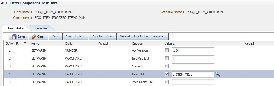

For PLSQL Flows with a single set of Test Data, do the following:
Right-click on a component in the PLSQL scenario and select Enter Test Data from the menu.
Figure 5-41 Example Enter Test Data Menu Option for PLSQL Flows
Specify the Test Data for the PLSQL procedure and its associated components, such as Records/Table of Records, etc.
Specify the Test Data for the all the Standard type parameters that are available in the procedure component.
If any user defined data type like Record/Object is taken as input to the procedure, then go the corresponding component in the component set and specify the data for that component.
Specify data as ”INPUT” for the first field ”START RECORD TYPE”/”START OBJECT TYPE”.
Specify data for the Record/Object fields.
The following figure shows an example of the Record/Object Component Test Data.
Figure 5-42 Example Record/Table Component Test Data
If any user defined data type like Table of Records/Table of Objects is taken as input to the procedure, then go the corresponding component in the component set and specify the data.
Table of Records/Objects corresponds to two components:
- Record/Object
- Table
Need to drag the Record/Object component above the table component based on the number of records to be passed to the table.
Specify the data for all the Record/Objects.
Specify the data for the table component, as follows:
- Specify the number of rows that are to be passed to the table at "STARTROWITERATOR" and click "Populate Rows".
- Associate all the dragged record/object component variables in the table component for each row.
Figure 5-43 Example Record/Object Component Test Data

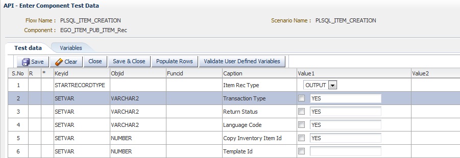

If any user defined data type like Record/Object is returned as output from the procedure, then go the corresponding component in the component set and provide the data as mentioned.
- Specify data as "OUTPUT" for the first field "START RECORD TYPE"/"START OBJECT TYPE".
- Specify data as "YES" for all the fields which are required as output from specified Record/Object.
- These fields can be used in the subsequent scenarios as {{RecordVariable_FieldName}}.
Figure 5-45 Example Record/Object Component Test Data

Specify the Test Data for the main procedure as follows:
- Specify Test Data for all the "Standard data types"(Varchar, Boolean, Number etc.) with the required data.
- Test data for all the "User defined data types"(Record/Object/Table of Objects/Table of Records) can be provided by selecting the variable name of the corresponding components.
Specify Test Data for DATE field as follows:
Value1: Specify date as #SYSDATE(+n), for example: #SYSDATE(+1)
#SYSDATE(0) - Today's date
#SYSDATE(+1) - Tomorrow's date
#SYSDATE(-1) - Yesterday's date
Value2: Specify date format as "DD-MON-YYYY"
The following figure shows an example of the Date Test Data.
Specify Empty in the Test Data as #EMPTY.
Specify a function call in the Test Data as #FUNCTIONCALL(functionName).
Specify Null in the Test Data as #NULL.
The following figure shows an example of the Null Test Data.

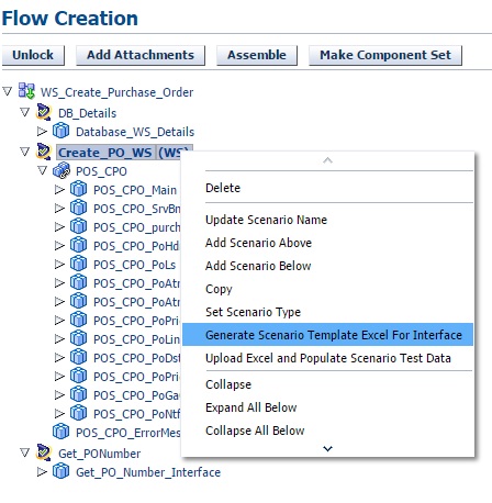

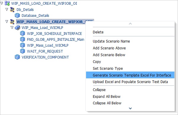

Multiple Test Data for PLSQL flows should be specified in the Excel spreadsheet and a separate Excel spreadsheet should be generated for each procedure Scenario.
Right-Click on the Scenario name in the Flow Structure pane and select Generate Scenario Template Excel For Interface. Oracle Flow Builder will generate the Multiple Test Data Excel spreadsheet file with a .xlsm extension for the specified procedure. The Excel spreadsheet file will be downloaded as scenarioname.xlsm.
Figure 5-51 Generate Scenario Template Excel for Interface Menu Option
The multiple PLSQL Excel spreadsheet file will have the following details.
Figure 5-52 Example Multiple PLSQL Excel Spreadsheet
Script Details sheet - this sheet will have details about the Scenario Name, Scenario Type, Scenario Iterations, and Scenario Structure.
Scenario Iteration indicates the number of times scenario needs to be executed.
Scenario structure will have the hyperlinks to navigate to the corresponding sheet in the Excel spreadsheet.
Components in the component structure will be mapped to the Excel sheets as follows:
Each Record/Object will have one sheet.
Table of Records/Table of Objects will be comprised of two components and those two components together will have one sheet. These two components are available in the corresponding sheet.
Table of Standard types will have one sheet.
One sheet for the Procedure Component and will be highlighted with blue color in the Excel spreadsheet.
Variables sheet - this sheet includes all the variables from the first scenario to the current scenario.
Open the Excel file and enable macros.
Specify the following in the Script Details sheet:

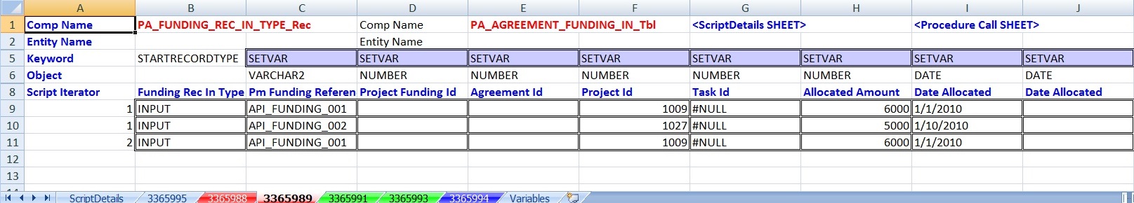

Test Data for Table of Records/Table of Objects As Input
Specifying Test Data for Table of Records/Table of Objects which are passed as input to the procedure requires the following details:
Figure 5-53 Example Test Data for Table of Records/Table of Objects as Input
Table of Records/Objects corresponds to two components in Oracle Flow Builder, as follows:
Table component
These two components become one sheet in the Excel spreadsheet. The component names will be displayed in the top header of the sheet.
Script Iterator indicates data for the specific iteration.
If you wish to pass multiple rows to the table, then provide all the rows with same script Iterator. For example:
If you want to pass two rows to the table during first iteration, then provide "1” for those two rows of data.
If you want to pass a single row to the table during second iteration, then provide "2" for the single row of data.

Record/Table Component will have one sheet in the Excel spreadsheet.
Record/Object can have only one row of data for each iteration.
Two rows of data can not have the same iterator.
Specify the script iterator for each row of data.
Test Data for Table of Records/Table of Objects as Output
Specifying Test Data for Table of Records/Table of Objects which are returned as output from the procedure requires the following details:
Figure 5-55 Example Test Data for Table of Records/Table of Objects as Output
Table of Records/Objects corresponds to two components in Oracle Flow Builder:
Table component
These two components becomes one sheet in the Excel spreadsheet. The component names will be displayed in the top header of the sheet.
If the table is returning multiple rows as output, then provide all the rows with same script Iterator and "YES" for the fields which needs to be returned as output.

Upload Excel and Populate Test Data
Right-click on the scenario name in the Flow creation pane and select Upload Excel and Populate Scenario Test Data.
Figure 5-57 Upload Excel and Populate Scenario Test Data Menu option
On uploading the Excel spreadsheet, following set of the actions will be performed:
The number of Iterations will be displayed next to the script name.
Variables will be created for all the iterations specified in the excel based on the number of rows of data.
Data will be stored in the Oracle Flow Builder application.
Figure 5-58 Example Flow After Uploading Excel Spreadsheet
Test Data for Procedure Component in Excel
Specify the Test Data for the Procedure component in the Excel spreadsheet, as follows:
Right-Click on the Scenario name in the Flow Structure pane and select Generate Scenario Template Excel For Interface to generate the Excel spreadsheet.
Specify the Test Data for Standard Data types such as Varchar, Number, Boolean, etc, in the procedure component.
Specify the Test Data for user defined data types of all iterations with a corresponding variable. Variables in the Excel spreadsheet can be specified as follows:
Enable Macros for the Excel spreadsheet.
Double-click on the cell where you need to provide the variable to open a dialog box for selecting variables.
Figure 5-59 Example of Variable Selection in Excel
Provide details like Scenario name, Scenario iteration, component name, component iteration to filter exact variable. Select the variables from the variables pane.
Figure 5-60 Example Test Data For Procedure Component

Create Scenario by right click on the flow and select Add New Scenario. Provide the following details in the Create Scenario dialog box as follows:
Scenario Name
Scenario Type as "Open Interface"
Figure 5-63 Create Scenario Details: Open Interface
Scenario Type will be displayed next to the scenario names as "(OI)".

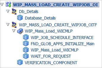

An Open Interface scenario should have following structure:
A Component Set corresponds to a specific concurrent request. The Component Set should have the following:
Components to insert data into Interface database tables.
PLSQL procedure component to execute concurrent request.
Drag any components such as FND_GLOB_APPS_INITIALIZE, etc. above the "Concurrent Request" component based on requirement.
Drag "WAIT_FOR_REQUEST" component below the "Concurrent Request" component to wait till the concurrent request is completed.
The following figure shows an example of the Open Interface Flow structure:
Figure 5-64 Example Open Interface Flow Structure

Right-click the Scenario name in the Flow Structure pane and select Generate Scenario Template Excel For Interface.
Figure 5-65 Generate Scenario Template Excel For Interface Menu Option
Selecting this menu option does the following:
Generates the Excel spreadsheet for all the interface tables.

Specify the data for interface tables. Primary_Key & Foreign_Key columns are used for user reference. Primary_Key field is a mandatory field and should be provided in sequence.

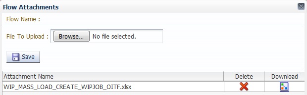

Figure 5-67 Upload Excel and Populate Scenario Test Data Menu Option
Upon uploading the Excel spreadsheet, the Excel file will be added to the Flow Attachments.
Figure 5-68 Excel File as Open Interface Flow Attachment
Right-click on the procedure component in the Open Interface scenario and select Enter Test Data from the menu.
Figure 5-69 Example Enter Test Data Menu Option for Open Interface Flow
Specify the Test Data for the procedure as per the concurrent request.
Figure 5-70 Example Component Test Data for Concurrent Request
Specify the values for Request Id, Interval and Max Wait data field in Wait for Request component. This component is used to wait till the concurrent request is completed.
Figure 5-71 Example Component Test Data for Wait for Request

To update the Test Data for an Open Interface scenario:
Download the Excel spreadsheet that corresponds to the specified scenario from the Flow Attachments, as follows:
Click the Add Attachments button just above the flow name.
Download the Open Interface Excel spreadsheet.
Update the data in the Open Interface Excel spreadsheet.
Delete the Open Interface Excel spreadsheet in the flow attachments that corresponds to the scenario, as follows:
Delete the Open Interface Excel spreadsheet that corresponds to the scenario.
Upload the updated Open Interface Excel spreadsheet using the Upload Excel and Populate Scenario Test Data menu item at the scenario level.

All database table fields should be provided as String.
Date values can be specified as #SYSDATE(+n). For example:
Null value can be specified as #NULL.
Empty ("") value can be specified as #EMPTY.
Space (" ") value can be specified as #SPACE.
Rerunnable value can be specified using "?". "?" can be used anywhere in the existing data.
A unique number with a database sequence can be specified as #SEQUENCE(SequenceName.NEXTVAL). For example:
#SEQUENCE(WIP.WIP_INTERFACE_S.NEXTVAL)
A unique number with a database sequence and store the runtime database sequence in a variable for further usage in the same Excel template or another scenarios can be specified as #SEQUENCE(SequenceName.NEXTVAL, VariableName). For example:
#SEQUENCE(WIP.WIP_JOB_SCHEDULE_INTERFACE_S.NEXTVAL,GROUP_ID)
Variable Name can be used as {{Varaible Name}} in the same Excel spreadsheet (any sheet) or in the subsequent scenarios.
The following image shows an example of Open Interface Test Data:
Figure 5-72 Example Open Interface Test Data
Oracle Flow Builder supports creation of flow for web services execution with multiple sets of Test Data and supports verification of response data. A Webservice flow can be created as follows:
A flow scenario to provide hostname and port details.
Each Webservice payload and corresponding response verification as one scenario.
Create a Scenario by right clicking on the flow and selecting Add New Scenario. Provide the following details in the Create Scenario dialog box, as follows:
Scenario Name
Scenario Type as "Webservice"
Figure 5-73 Create Scenario Details: Webservice
Scenario Type will be displayed next to the scenario names as "(WS)".
The Webservice scenario should have following structure:
Add Component Sets related to the Webservice payload. The component set should have the following:
A component for WSDL and payload root structure details.
Components for Payload nodes having elements.
Add Components related to Webservice response based on the requirements. Add all the output response components to the scenario which are required for the following:
Verification.
To retrieve the value from a response for further usage in the scenarios.
Figure 5-74 Example Webservice Flow Structure
Specify the Test Data for Webservice flows as follows:
Right-click on a Payload structure component in the Webservice scenario and select Enter Test Data from the menu.
Figure 5-75 Example Enter Test Data Menu Option for Webservice Flow
Specify the Test Data for the envelop (specify attributes of the root node for the Envelop field). For example:
@xmlns:ser="http://xmlns.oracle.com/apps/fnd/ServiceBean", @xmlns:ser1="http://xmlns.oracle.com/apps/po/service", @xmlns:soapenv="http://schemas.xmlsoap.org/soap/envelope/"
Figure 5-76 Example Test Data for Payload Component
Save and close.
Right-click on the Scenario name in the Flow Structure Webservice scenario pane and select Generate Scenario Template Excel For Interface.
Figure 5-77 Generate Scenario Template Excel for Interface Menu Option
Generating the Scenario Template Excel does the following:
Generates an Excel spreadsheet for all the Webservice payload node components and WebService Response Components. Each "node component" in the scenario corresponds to one sheet in the Excel spreadsheet.
The Webservice Excel spreadsheet file will have the following details:

Specify the following details in the Main sheet:
Figure 5-78 Example Main Sheet Test Data for Webservice Flow
Payload_key for each iteration of the payload.
Provide Primary_Key corresponds to each payload.
Provide TestCaseName corresponds to each payload. This must be provided for each payload.
Provide UserName/Password, which are required as Webservice security authentication during payload execution.
AllowEmptyNode indicates inclusion of empty nodes (Nodes which doesn't have any data) in the generate payload. Provide data for this field as follows:
YES - indicates Empty will be included in the payload even if data is not provided.
NO - indicates Empty nodes will be removed in the payload when data is not provided.
Specify the Payload data, as follows:
Figure 5-79 Example 1 PoHeader Sheet for Webservice Flow
Provide data for each node component with Payload_Key.
Primary_Key and Foreign_Key to be provided based on node structure. These are to be provided corresponding to the payload.
If the same node data is repeated multiple times, then provide multiple rows in the Test Data with the same Payload_Key.
Figure 5-80 Example 2 PoLines Sheet for Webservice Flow
Figure 5-81 Example 3 PoLineLocations Sheet for Webservice Flow

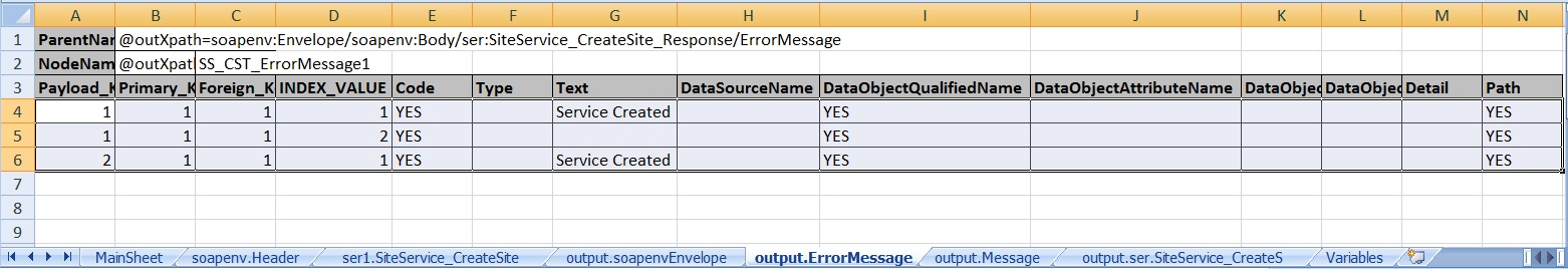

Specify data to retrieve from payload response or verification of data in payload response.
Figure 5-82 Example Data to Retrieve/Verification of Data
If user needs to verify any data for specific field from the output payload response, provide the data to be verified as Test Data in the corresponding field.
If user needs to retrieve any data for specific field from the output payload response, then provide "YES" in the Test Data for the corresponding field.
The column INDEX_VALUE in the output response components is used specify the index of the specific fields. This is to support repetition of the same node multiple times.

Upload the Excel spreadsheet by right-clicking on the Webservice scenario name in the Flow creation pane and select Upload Excel and Populate Scenario Test Data.
Figure 5-83 Upload Excel and Populate Scenario Test Data Menu Option

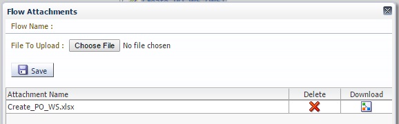

Upon uploading the Excel spreadsheet, the Excel file will be added to the Flow Attachments:
Figure 5-84 Excel File as Webservice Flow Attachment

Oracle Flow Builder supports creation of flows with a combination of Functional Flow and PLSQL / Interface / Webservice flows.
This section provides general guidelines on best practices and things to avoid when creating PLSQL flows.
General best practices are as follows:
Create a separate scenario to provide database details.
Provide the scenario type when creating any interface scenario. The scenario type is required to download the Multiple Test Data template for interfaces.
Data provided in the Excel spreadsheet should be in Text format.
Create separate scenario for verification and select components.
To validate data.
To retrieve any data from database using queries.
It is best to have a hybrid flow with a single set of Test Data.
Multiple Test Data is supported only for the following interfaces at the scenario level:
PLSQL
Open Interface
Webservice
Flow level Test Data Excel spreadsheet is used only for GUI flows.
You should use flow level Test Data Excel spreadsheet for GUI flows.
You should not use flow level Test Data Excel spreadsheet for interfaces like PLSQL, Open interface and Webservice with single or Multiple Test Data.
You should not use flow level Test Data Excel spreadsheet for hybrid flow.
