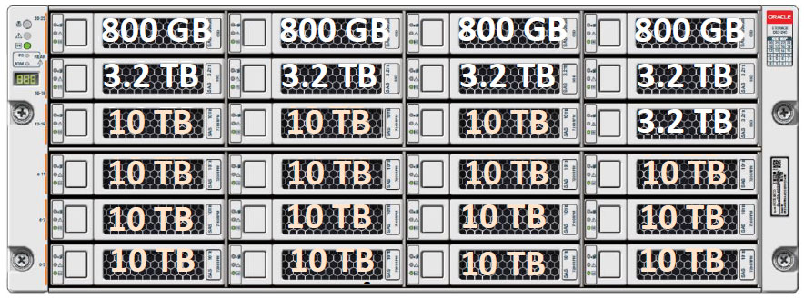

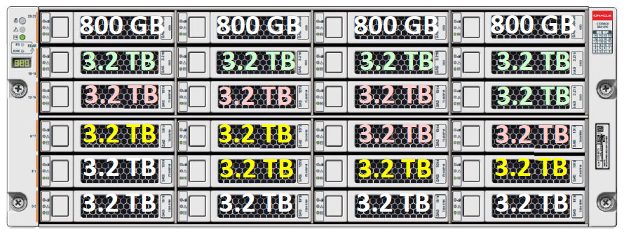

Add disk storage in an Oracle Database Appliance X7-2-HA storage shelf.
The Oracle Database Appliance X7-2-HA storage shelf partially-populated base configuration supports 15 expansion slots for either 3.2 TB SSDs (available in five-packs) or 10 TB HDDs (available in a fifteen-pack). These expansion slots are labeled 5-19 as seen from the front of the system (callouts 5 through 19 in the following illustration).
Note the following:
Expanding the base configuration storage shelf with 3.2 TB SSDs can be performed with the appliance running. The base configuration has slots 20-23 populated with 800GB drives for REDO and slots 0-4 with 3.2 TB drives for DATA/RECO. Expansion drives are available in five-packs and are populated in shelf storage slots from the bottom up to be used for DATA/RECO, as follows:
The following illustration shows the expanded drive configuration for 3.2 TB SSDs.
When you expand storage, you must first install all of your expansion disks (5, 10 or 15). Once you expand storage to support additional disks, you cannot revert to the base configuration (no drives in slots 5-19).
Expanding the base configuration storage shelf with 10 TB HDDs requires that you first power down the appliance. The base configuration has slots 20-23 populated with 800GB drives for REDO and slots 0-4 with 3.2 TB drives for DATA/RECO. Expansion drives are available in a fifteen-pack and are populated in the storage shelf as follows:
The following illustration shows the expanded drive configuration for 10 TB HDDs.
After adding the storage, power on the appliance to perform cleanup, redeploy the appliance and restore the database as described in the Deployment and User's Guide for the appliance. Once you expand storage to support additional disks, you cannot revert to the base configuration (no drives in slots 5-19).
If you plan on adding another storage shelf, it must be populated identically to your first storage shelf.
