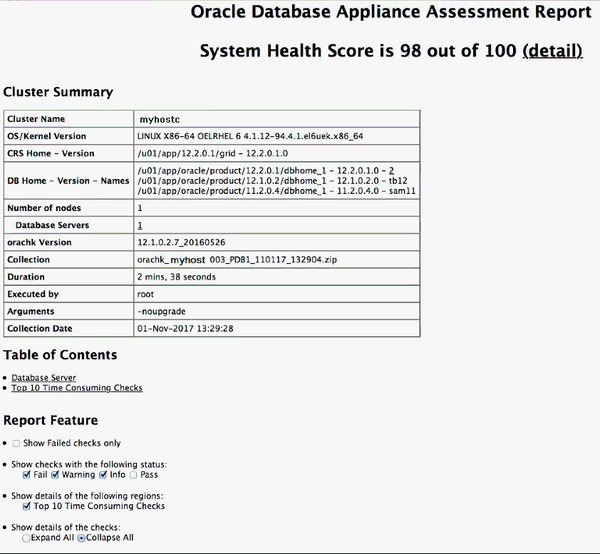

  1. Open the command-line interface as root.
  2. Navigate to the ORAchk tool in the /suptools directory.
    /u01/app/12.2.0.1/grid/suptools/orachk
  3. Run the utility.
    ./orachk
    When all checks are finished, a detailed report is available. The output displays the location of the report in an HTML format and the location of a zip file if you want to upload the report.
  4. Review the Oracle Database Appliance Assessment Report and system health and troubleshoot any issues that are identified.
    The report includes a summary and filters that enable you to focus on specific areas. For example, you can choose the filter to show failed checks only, show checks with a Fail, Warning, Info, or Pass status, or any combination.
