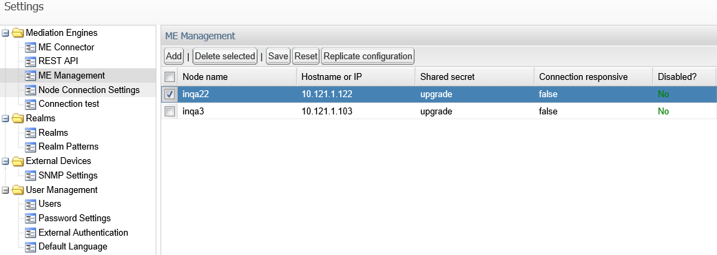

  1. Navigate to the ME Management section.
  2. Click Add.
  3. Double click a row to edit its values.
    • Node name: The name of the mediation engine is used by Mediation Engine Connector to form the URL under which the mediation engine is reached.
    • Hostname or IP: The hostname or IP address of the mediation engine.
    • Shared secret: The password required by the mediation engine to authenticate itself while connecting to Mediation Engine Connector.
      The same password needs to be set in the connecting mediation engine from the ME Management page in the System Settings dialog box.
    • Disabled: Disconnect a mediation engine from Mediation Engine Connector
  4. Click Save.
