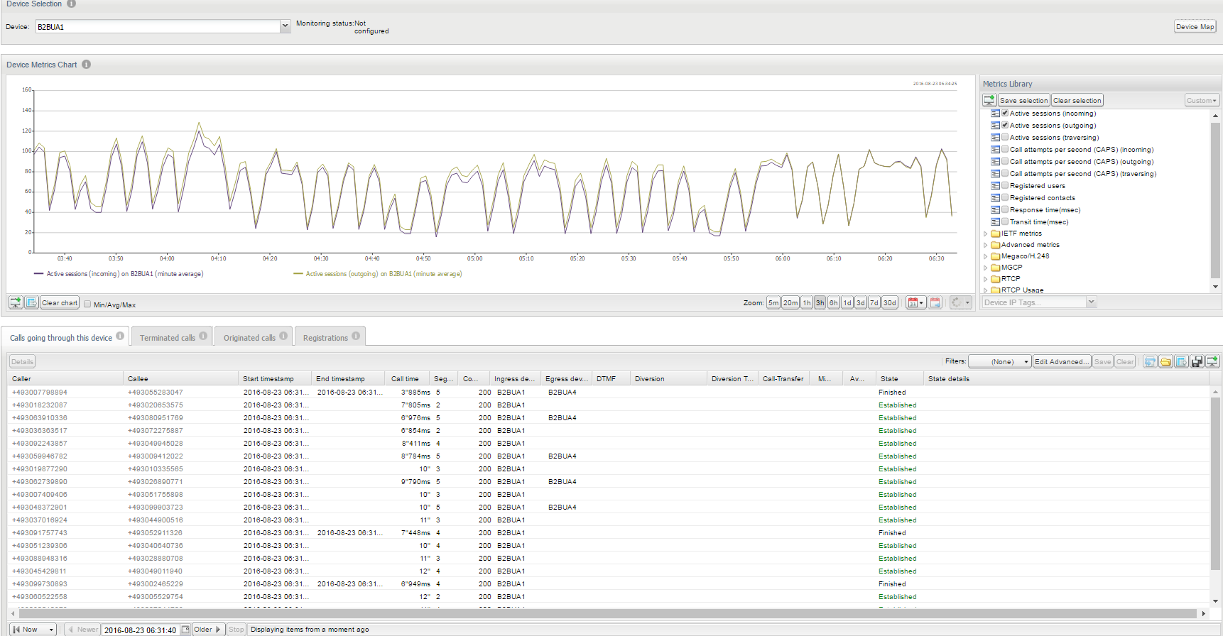

Devices
The Devices page (see Figure 4-63) shows not only an overview of all configured platform devices, but it also aggregates information about each individual platform device. To use it, the platform devices (or trunks) have to be configured in the platform settings. For more information, see "unresolvable-reference.htm". This page contains a device selection drop-down menu, a device metrics chart, and a tab panel providing details about calls, registrations, and voice quality for the selected device.

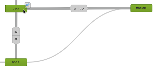

Device Map
You can display a map of devices by clicking on Device Map button. It shows an overview of the status and activity for all configured devices on the monitored platform (see Figure 4-64). They are displayed as nodes on a topological graph; activity between nodes is shown in the lines connecting them. From this page it is easy to monitor platform activity and status.
Trunk devices are not displayed on the Device Map page.
Figure 4-64 Device Map
Device Map
Once added, you can drag and drop devices around the page to best represent the local network topology. There is a Reset Layout button on the toolbar to reset the page.
Hover over the node with the mouse cursor to show the inbound and outbound value of the displayed metric of a node, as shown in Figure 4-65.

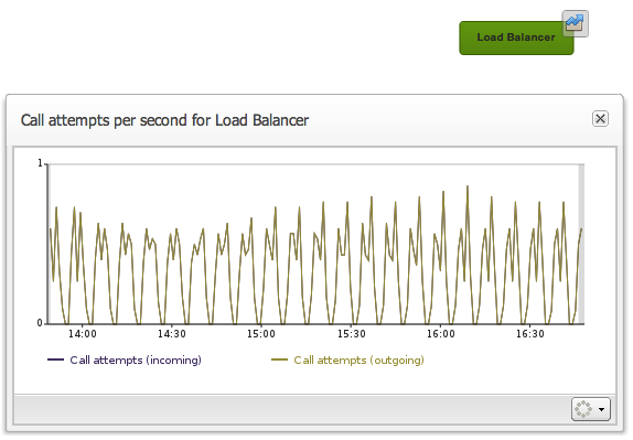

More detailed information about the selected metric (see Figure 4-67) can be displayed per-device by clicking on the Details button that appears overlaid on a device while hovering:
Figure 4-67 Click on a Device to Display Detail Information About the Active Metric
Call attempts per second for load balancer

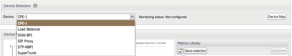

Device Selection Panel
The Device Selection panel illustrated in Figure 4-68 determines the device whose details are displayed on the page. Select a device from the drop-down menu.
Figure 4-68 Device Selection Panel
Description of Figure 4-68 follows
Description of "Figure 4-68 Device Selection Panel"
Device Monitoring Status
The Device Selection panel displays the monitoring status for the current device (see Figure 4-69). This information is available only if device monitoring is configured for that specific platform device.
To configure device monitoring, refer to "unresolvable-reference.htm" and "unresolvable-reference.htm".
Figure 4-69 Device Monitoring Status
Description of Figure 4-69 follows
Description of "Figure 4-69 Device Monitoring Status"

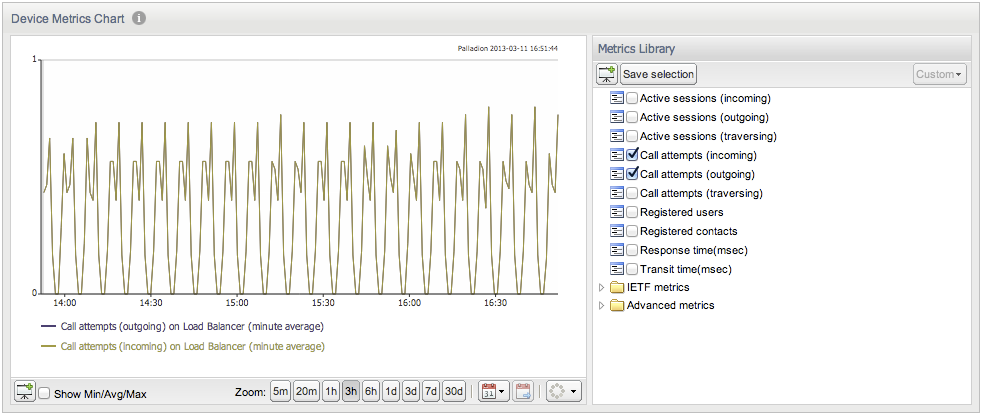

Device Metrics Chart
The Device Metrics Chart, illustrated in Figure 4-70, displays the evolution of the selected device metrics from the Metrics Library. For more information about the Metrics Library, see " KPI/Metrics ". Device metrics are special in that they measure properties connected to a certain platform device.
Figure 4-70 Device Metrics Chart
Device metrics chart
You can select up to five metrics by marking the check box of the desired metric.
The Save Selection button saves the current set of metrics for the specified device in the Device Metrics chart.
You can add the Device Metrics Chart to the Dashboard by clicking the Show in Dashboard icon button.
At the bottom of the chart, the Show Min/Avg/Max check box controls whether minute or hour minima and maxima are displayed for each selected metric. The other controls are described in the section on chart panels. For more information, see " Charts ".

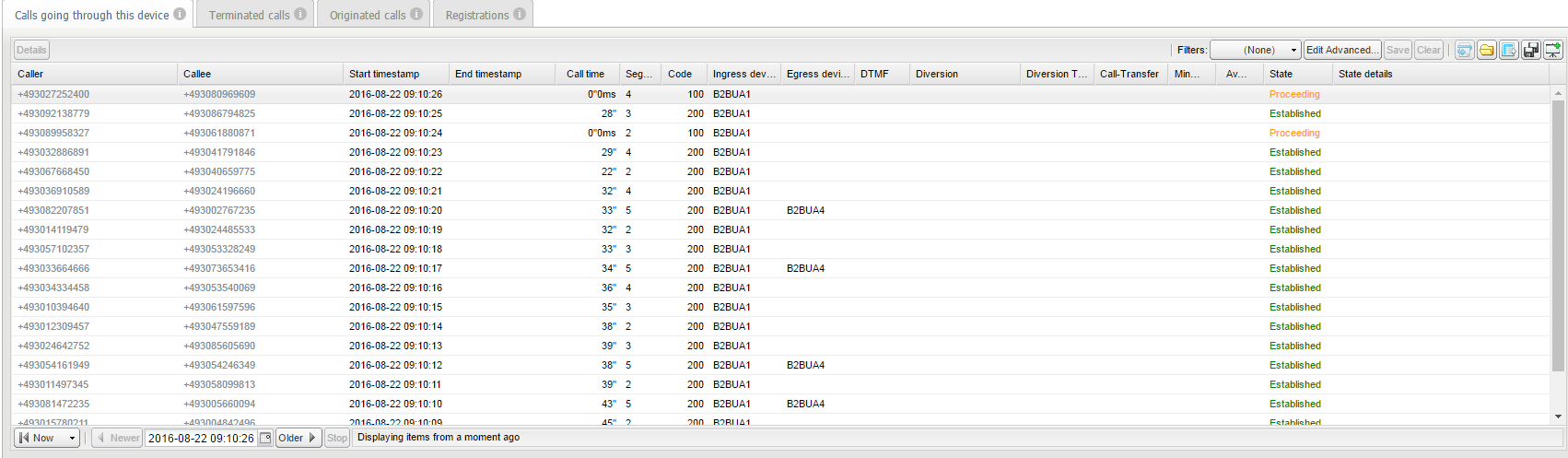

Calls Going Through This Device Tab
The Calls going through this device tab, as illustrated in Figure 4-71, is similar to the Recent calls panel described in the "Calls" section. The table displays only the calls that have an inbound leg to the current device and an outbound leg from the current device.

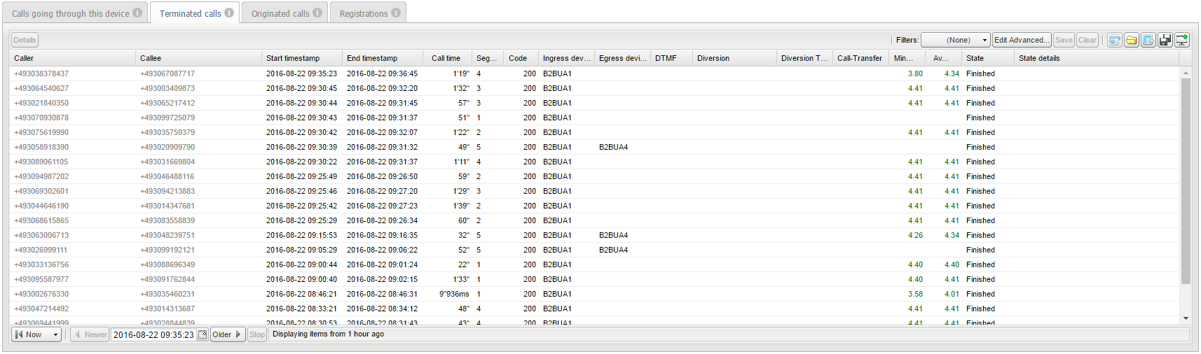

Terminated Calls Tab
The Terminated calls tab, as illustrated in Figure 4-72, is exactly like the Recent calls panel described in "Calls". The table displays only the calls which have an inbound leg to the current device. Terminated calls do not have an outbound leg from the current device.
Figure 4-72 Terminated Calls Tab
Description of Figure 4-72 follows
Description of "Figure 4-72 Terminated Calls Tab"

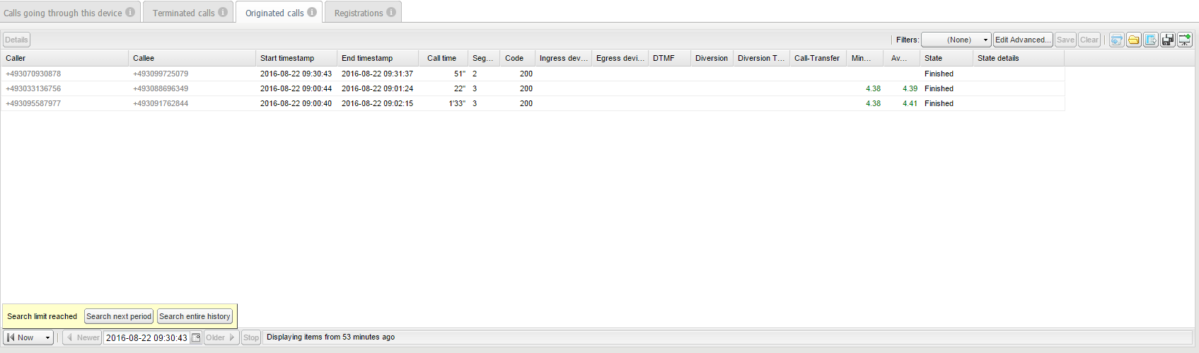

Originated Calls Tab
The Originated calls tab, as illustrated in Figure 4-73, is exactly like the Recent calls panel described in "Calls". The table displays only the calls which have an outbound leg from the current device. Originated calls do not have an inbound leg to the current device.
Figure 4-73 Originated Calls Tab
Description of Figure 4-73 follows
Description of "Figure 4-73 Originated Calls Tab"

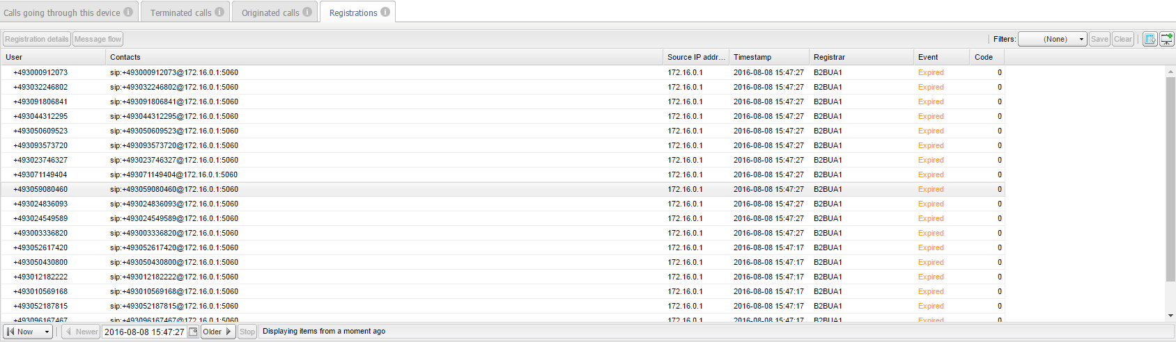

Registrations Tab
The Registrations tab, as illustrated in Figure 4-74, is similar to the Registrations panel described in "Registrations". However, it only displays registrations which are handled by the current device.
