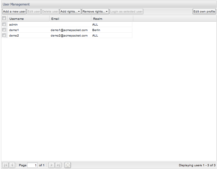

The User Management panel features seven buttons, as shown in Figure 7-37.
The left most three of them allow a user to manage his sub-users: Add a new, edit an already added one, or remove a no longer needed user. To modify or delete a sub-user, its parent-user needs to select a row out of the table and press the corresponding button. Both the Add a new user and the Edit user buttons invoke a wizard (in a new window) asking for the needed detail in order to set-up a new or change an existing user. The Add rights...and the Remove rights... buttons make it possible to add selected rights to selected or all users created by the current user, respectively to remove selected rights from selected or all users created by the current user. The rights to add or remove can be selected in a wizard, that is in accordance with the last two pages of the wizard. The Login as selected user button allows a parent user to login as a sub-user without having to enter a password. The Edit own profile button to the right of the page allows the current user to edit one's own profile information.

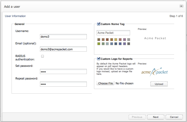

The first step, named User Information, requires providing the log-in name (the username), an optional email address, and a password (asked two times to prevent accidental mistyping) as can be seen in Figure 7-38. Instead of entering a password, it is also possible to opt for RADIUS authentication, if RADIUS authentication has been set up for this Operations Monitor instance. To learn more about Operations Monitor's RADIUS authentication feature, see "unresolvable-reference.htm".
Figure 7-38 Setting User Information for a New User
Description of "Figure 7-38 Setting User Information for a New User"
A logo image is located in the upper left corner of the interface. By default, this is the Oracle logo, but it can be customized for each individual user; this is useful when the web interface is accessed by multiple clients of the same provider, sharing the same Operations Monitor setup. The Custom Logo for Reports section provides an upload field where the user can insert the picture to use as a logo.
The following logo formats are supported: TIF, TIFF, EPS, PDF, JPG, JPEG, GIF, and PNG.
After specifying the path, one must upload the file by pressing on the Upload image button.

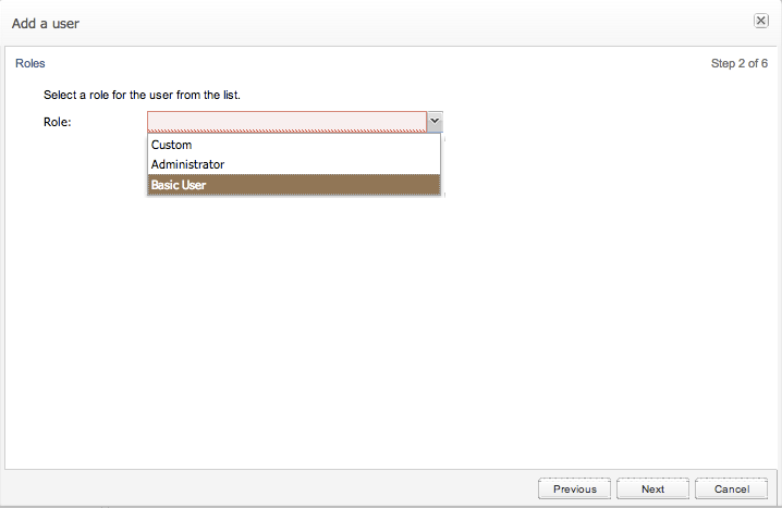

Selecting a Role
After choosing a username and password, the user is given the option of selecting a role (See Figure 7-39) providing roles have been defined in addition to the custom role. If no roles are available, the dialogue will continue directly to the realms selection if they exist, otherwise onto the individual permissions selection.
Figure 7-39 Setting a Role for a New User
Description of "Figure 7-39 Setting a Role for a New User"

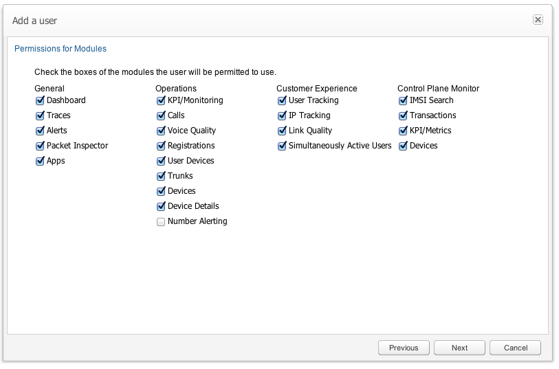

The Permissions for Modules page, is where the parent user can control what the new user will be able to access. The set of permissions are grouped in four, reflecting the grouping of functionality on the actual web interface:
General
Operations
Customer Experience
Control Plane Monitor
Each check box in these groups corresponds to a menu item in the main menu of Operations Monitor. If it is checked, the new user will have the corresponding menu item in his main menu.
Figure 7-40 Setting Permissions for Modules for a New User
Description of "Figure 7-40 Setting Permissions for Modules for a New User"

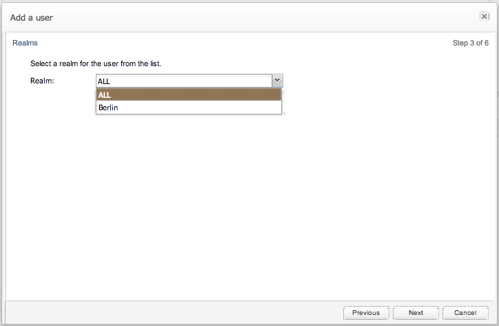

User Realm
The second step sets the realms that the future user will be able to access.
A user assigned to a realm can only see devices that are also assigned to that realm. Users assigned to the realm ALL are unrestricted and can see all devices, regardless of the realm the device is assigned to. For more information about the realm concept in Operations Monitor, see unresolvable-reference.htm
On the KPI/Metrics page, users also only see the devices listed in their assigned realm. For more information, see KPI/Metrics
A user can access either one or ALL the realms (see Figure 7-41).

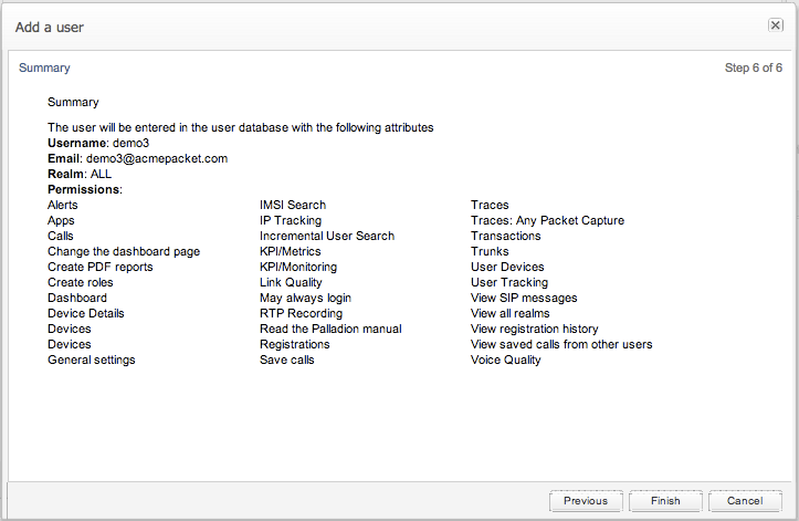

The summary as shown in Figure 7-42 gives a brief overview of the new user. Included is the username, email address (if entered), role, realm and permissions bitmask.

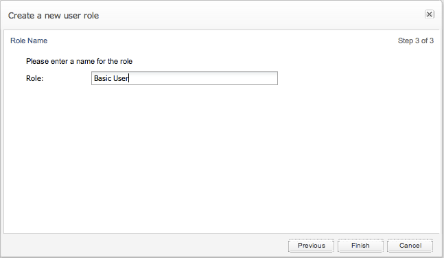

Adding a Role

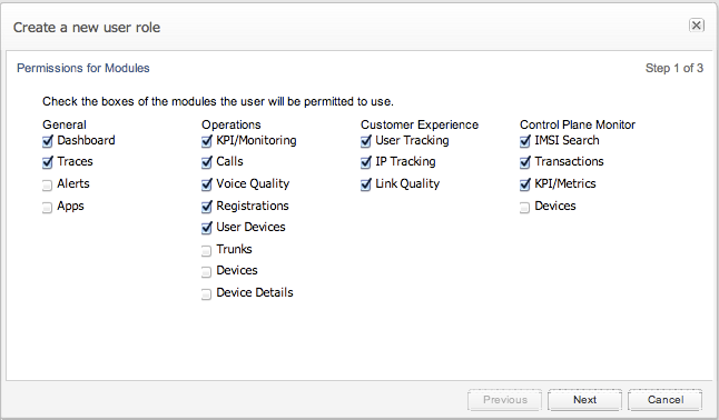

Adding a role is performed after selecting the Add a new role button. As shown in Figure 7-44, Figure 7-45, and Figure 7-46. This is equivalent to the permissions screens of adding a new user, however after setting the permissions there is a prompt for the role name, see Figure 7-46. The role name is mandatory.
Figure 7-44 Setting Permissions for Modules for a New Role
Description of "Figure 7-44 Setting Permissions for Modules for a New Role"

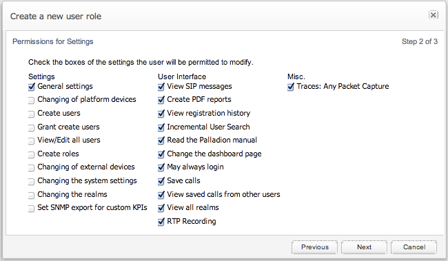

Figure 7-45 Setting Permissions for Settings for a New Role
Description of "Figure 7-45 Setting Permissions for Settings for a New Role"

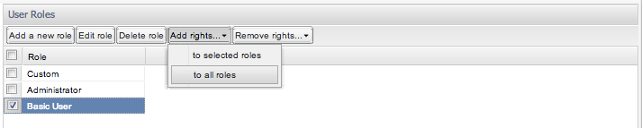

Adding Rights to a Role
One can either add rights to a selected role or generally to all roles. This can be selected as demonstrated in Figure 7-47 and Figure 7-48. The following dialogue is equivalent to the normal role dialogue, only without the option to change a role name. The selected check boxes designate which rights will be added to the selected role(s).
Figure 7-48 Adding Rights to Selected Roles
Description of "Figure 7-48 Adding Rights to Selected Roles"

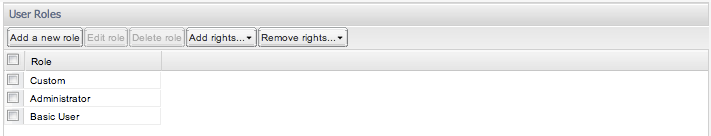

Removing Rights from a Role

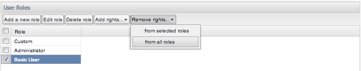

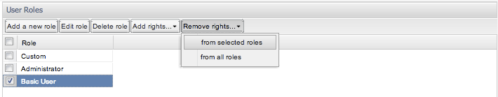

Likewise, one can remove rights from individual roles or generally across all roles. This is selected as shown in the images Figure 7-49 and Figure 7-50. Removing rights is the mirror process to adding rights, with the selected check boxes will be removed from the selected role(s).
Figure 7-49 Removing Rights from All Roles
Description of "Figure 7-49 Removing Rights from All Roles"
Figure 7-50 Removing Rights from Selected Roles
Description of "Figure 7-50 Removing Rights from Selected Roles"

Click Next.
The permissions for Settings screen appears.
Click Next.
The Summary screen appears.
Verify the summary and click Finish.
