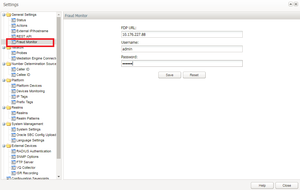

After the successful certificate exchange configure the FDP URL at admin >Setting >General Settings >Fraud Monitor.
The username and Password must be same as the FDP Username and Password used for login to Fraud Monitor.
Figure 2-1 Fraud Monitor configuration Page

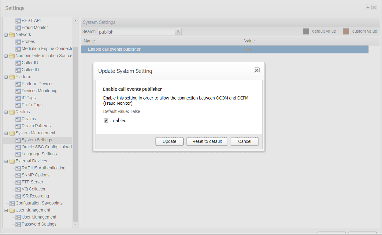

The Operations Monitor initiates secured (TLS) connection to Fraud Monitor, if Fraud Detection is enabled from the below path admin >Settings >System Settings >Enable call Events publisher
Figure 2-2 Fraud Monitor System Setting
