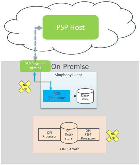

The process for a credit card transaction follows these steps (as illustrated in the following figure):
Figure 11-4 Terminal Mode Architecture With Attached PED
POS Operations sends a payment request to the PED, addressing it as localhost:port.
The PED communicates with the PSP Host and returns the token and voucher printing instructions to POS Operations.
The token and other transaction details are saved in the Datastore on the POS client.
This scenario is independent of both the LAN and the OPI server.

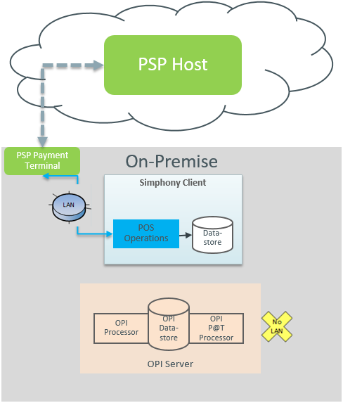

POS Clients Without Attached PEDs
POS clients, such as tablets and Android devices, may not have PED devices directly attached. However, PSPs offer network-capable PEDs that can be used.
Figure 11-5 POS Clients Without Attached PEDs
Figure 11-6 Terminal Mode Architecture Without Attached PED
POS Operations sends a payment request to the PED over the network, addressing it with its IP address:port.
This scenario depends on a LAN connection and is vulnerable to network failure to the PED, but does not require an OPI server.

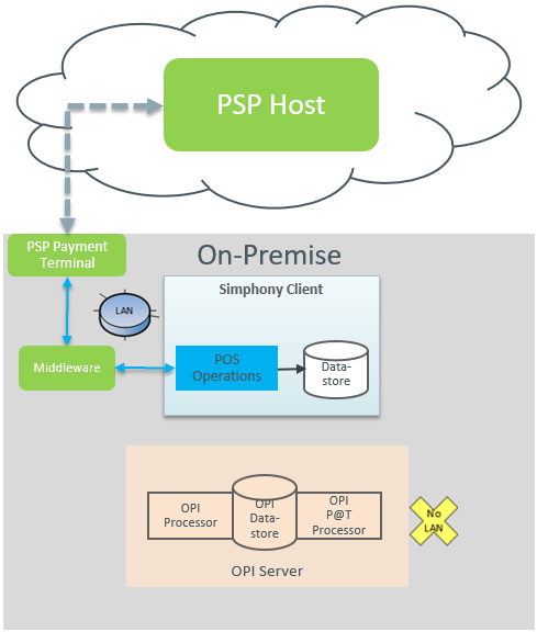

Middleware Mode
POS Clients With or Without Attached PEDs
The PSP provides an application, called middleware, which handles the mapping of a POS client to a PED.
Figure 11-7 Middleware Mode Architecture With or Without Attached PED
POS Operations sends a payment request to the IP address where the middleware application is configured.
The middleware application passes the request to the appropriate PED.
