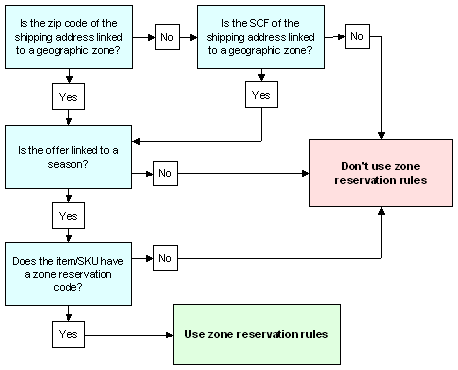

When Do Zone Reservation Rules Apply?
For an order line to be eligible for zone reservation processing:
• The item/SKU must be assigned a zone reservation code in the item table to identify it as a zone reservation item.
• The offer associated with the order must be linked to a season in the offer table
• The shipping address must be assigned to a geographic zone. The system uses ZIP codes or SCF codes to identify geographic zones.
• For each zone reservation code, you must define zone date windows for all geographic zones in the country.
Note: In order for the system to search for a zone in order entry or maintenance, the Bypass Geographic Zone Searching in Order Entry/Order Maintenance (H55) system control value must be unselected.

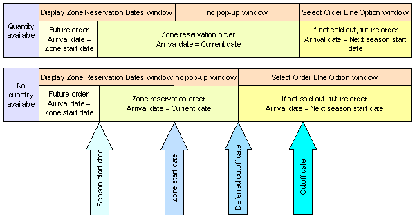

Standard Zone Reservation Rules
If the Use Alternate Zone Reservation Logic (I52) system control value is unselected, items which are eligible for zone reservation processing in order entry follow these rules based on the current date:
Prior to the season start date:
• The order line is taken as an open order, but is not reserved.
• The backorder status = F (Future order).
• The arrival date of the order = the zone start date.
• The system presents the Display Zone Reservation Dates Window if you have flagged the order type to display zone date windows.
After the season start date but prior to the zone start date:
• The backorder status = Z (Zone reservation).
• The arrival date of the order line = the current date.
After the zone start date but prior to the deferred cutoff date:
After the deferred cutoff date (backorder cutoff date) but prior to the cutoff date:
• If stock is available, the order follows the rule listed above.
• If stock is not available, the order line follows the rule below.
After the cutoff date, the Select Order Line Option Window presents two options:
1. Sell out the order line
2. Take the order line as a future order (backorder status = F) with an arrival date = the next season's start date
Future orders: An order line taken outside the season as a future order will have a future Arrival date and a backorder status of F (Future order). Future order lines are reserved or backordered during the Evaluate Future Orders periodic process. The order is then selected for pick slip generation when the zone opens, since this date is the arrival date for the order line.

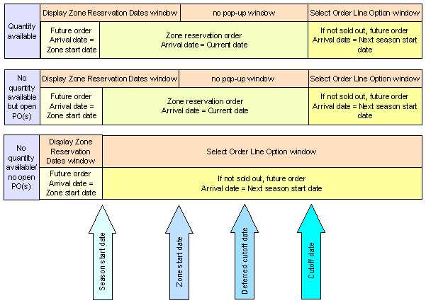

Alternate Zone Reservation Rules
If the Use Alternate Zone Reservation Logic (I52) system control value is selected, items which are eligible for zone reservation processing in order entry follow these rules based on the current date:
• If the item has an available quantity or any open purchase orders:
- The order line is taken as an open order, but is not reserved.
- The backorder status = Z (Zone reservation).
- The arrival date of the order line = the current date.
- The system presents the Display Zone Reservation Dates Window if you have flagged the order type to display zone date windows.
• If the item has no available quantity or open purchase orders, the Select Order Line Option Window presents two options:
- Sell out the order line
- Take the order line as a future order (backorder status = F) with an arrival date = the next season's start date
After the zone start date but prior to the cutoff date:

Overview: All of the values specified below must be set in order for zone reservation rules to apply to an item in order entry.
SKU table: The Zone reservation code field in the SKU table indicates whether or not an order line is processed under zone reservation rules.
Offer table: The Season field in the Offer table identifies the season linked to the offer. A zoned reservation item offered in more than one season (spring and fall, for example) has more than one set of date windows (spring date windows and fall date windows). The zone reservation program uses this information to identify which season's date windows to use. Only order lines whose offers are linked to a season are eligible for zone reservation rules. See Working with Offers (WOFR).
ZIP/City/State table or SCF table: The Geographic zone field in the ZIP/City/State table, or alternatively the Geographic zone field in the SCF table identifies the geographic zone of the ship-to address. You must specify a geographic zone for each ZIP code, or alternatively for each SCF code, to which you ship zone reservation items. You can specify a geographic zone for a range of ZIP codes on the Update Postal Codes by Range Screen.
The Geographic zone in the ZIP/City/State table overrides the Geographic zone in the SCF table for zone reservation processing. The ZIP/City/State table is not company specific; zones assigned at the ZIP/City/State table applies to all companies in your system. You can define different geographic zones for different companies by leaving the Geographic zone field blank in the ZIP/City/State table and instead entering values in the Geographic zone field of the SCF table, which is specific to each company. See Working with SCF Codes (WSCF).
Either of these tables can supply the third required value for an order line to be eligible for processing under zone reservation rules.
System control values:
• Bypass Geographic Zone Searching in Order Entry/Order Maintenance (H55): must be unselected.
• Use Alternate Zone Reservation Logic (I52): controls whether the system uses Standard Zone Reservation Rules or Alternate Zone Reservation Rules
• Auto Update Order Priority (G45): updates to 9 the priority of any order on which the arrival date has been overwritten with a date other than the current date. This includes all zone reservation orders for which you have overridden the zone reservation arrival date. Orders with a priority of 9 takes precedence in pick slip generation if you specify Priority as a criterion.
Note: You can update the priority of an order by changing the arrival date for the order, for the order ship to, or for the order detail. If you also want to change the shipping date for a zoned reservation item, you must change the arrival date on the Work with Order Line Screen (Changing/Adding an Item).
Order Type table: The Zone date windows flag in the Order Type table controls whether to display the Display Zone Reservation Dates Window in order entry when a zoned reservation item is ordered prior to the start date for the order's shipping zone. You might want to display this window for phone orders, for example, but not for mail orders. See Establishing Order Types (WOTY) for more information.
Season table: The Start date field in the Season table determines when a zoned reservation item ordered before its Zone Start date is flagged as a future order. The Season Start date must be earlier than the start date for any zone date windows. Zoned reservation items ordered before this earlier Season Start date, are processed as future orders with an arrival date = the zone window start date; they do not fall under zone reservation rules. If the season Start date is left blank, all orders taken before the zone reservation Start date fall under zone reservation rules.
The End date field in the season table is informational only. See Working with Season Codes (WSEA) for more information.
Order Ship-To table: The Geographic zone field in the order ship-to table is automatically populated during order entry for zoned reservation items, and can be used during pick slip generation as a selection criterion.
