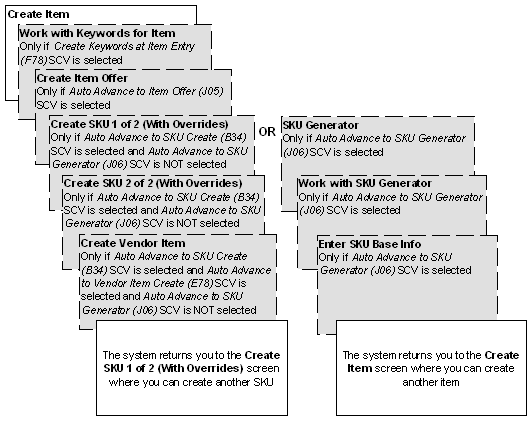

Creating SKU'ed Items Screen Flow
Select the SKUs field on the Create Item Screen to create a SKU’ed item. The system automatically advances you through the following screens to create a SKU’ed item.
1.
Create Item Screen
2.
First Work with Keywords for Item Screen (only if the Create Keywords at Item Entry (F78) system control value is selected)
3.
Create Item Offer Screen (only if the Auto Advance to Item Offer (J05) system control value is selected)
4.
Depending on whether you are using the SKU Generator:
Create SKU 1 of 2 (With Overrides) Screen (only if the Auto Advance to SKU Create (B34) system control value is selected and the Auto Advance to SKU Generator (J06) system control value is unselected)
SKU Generator Screen (Entering SKU Information) (only if the Auto Advance to SKU Generator (J06) system control value is selected)
6.
Create SKU 2 of 2 (With Overrides) Screen (only if the Auto Advance to SKU Create (B34) system control value is selected and the Auto Advance to SKU Generator (J06) system control value is unselected)
Work with SKU Generator Screen (only if the Auto Advance to SKU Generator (J06) system control value is selected)
7.
Create Vendor Item Screen (only if the Auto Advance to SKU Create (B34) system control value is selected, the Auto Advance to Vendor Item Create (E78) system control value is selected and the Auto Advance to SKU Generator (J06) system control value is unselected)
Enter SKU Base Information Pop-Up Window (only if the Auto Advance to SKU Generator (J06) system control value is selected)
Once you have completed creating the item and SKU, you return to the:
Create SKU 1 of 2 (With Overrides) Screen if you are not using the SKU Generator, where you can create another SKU.
Create Item Screen if you are using the SKU Generator, where you can create another item.
SKU’ed item screen flow:

Completing this screen: If you are creating a SKU'ed item, you advance to the Create Item Offer Screen. If you are creating a non-SKU'ed item, you advance to the Create Item (Base Information) Screen.

How to display this screen: Complete the Create Item Screen with the SKUs field unselected.

Completing this screen: You advance to the Create Vendor Item Screen if the Auto Advance to Vendor Item Create (E78) system control value is selected; otherwise, you advance to the Create Item Offer Screen.

• You advance to this screen automatically when you create a SKUed or non-SKUed item if the Auto Advance to Item Offer (J05) system control value is selected; see Creating Items Screen Flow.
• Select Create at the Work with Item Offers Screen.

• You advance to this screen automatically when you create a SKUed item if the Auto Advance to SKU Create (B34) system control value is selected and the Auto Advance to SKU Generator (J06) system control value is unselected. See Creating SKU'ed Items Screen Flow.
• Select Create at the Work with SKUs Screen.
Completing this screen: Select OK to advance to the Create SKU 2 of 2 (With Overrides) Screen. This screen contains additional SKU attributes, including those related to long SKU and physical dimensions.
After you create a SKU, the system returns you to this screen, allowing you to create another SKU. You can select Exit when you have finished creating all SKUs.
You can also select Exit if you wish to create a SKU’ed item without creating the individual SKUs at this time.
