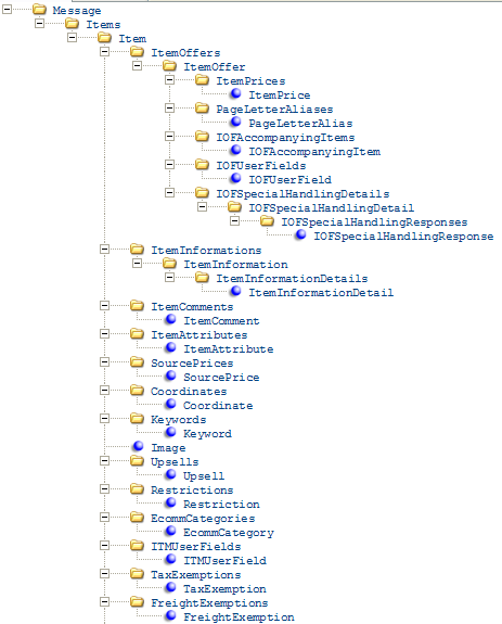

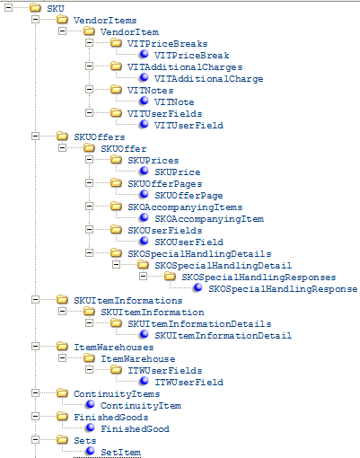

• Item Download XML Message (CWItemOut)
- Item Download Message: Sample XML

You can define Item Outbound XML inclusion rules at the Outbound Interface XML Inclusion Screen.
XML inclusion defines which elements to include in the item download message.
• If the element is included, that element and its parents are included in the generated item download XML message.
• If the element is excluded, that element and its children are excluded from the generated item download message.
This table indicates which elements in the item download message are included, based on which elements you flag to include or exclude.
Include element in XML message? |
Element |
Selected = Include Item Unselected = Exclude Item and all of its children; the system sends a message with only the Message element and its attributes |
Item |
Selected = Include ItemOffer and its parent Item Unselected = Exclude ItemOffer and its children ItemPrice, PageLetterAlias, IOFAccompanyingItem, IOFUserField, IOFSpecialHandlingDetail and IOFSpecialHandlingResponse |
ItemOffer |
Selected = Include ItemPrice and its parents, ItemOffer and Item Unselected = Exclude ItemPrice |
ItemPrice |
Selected = Include PageLetterAlias and its parents ItemOffer and Item Unselected = Exclude PageLetterAlias |
PageLetterAlias |
Selected = Include IOFAccompanyingItem and its parents ItemOffer and Item Unselected = Exclude IOFAccompanyingItem |
Selected = Include IOFUserField and its parents ItemOffer and Item Unselected = Exclude IOFUserField |
IOFUserField |
Selected = Include IOFSpecialHandlingDetail and its parents ItemOffer and Item Unselected = Exclude IOFSpecialHandlingDetail and its child IOFSpecialHandlingResponse |
IOFSpecialHandlingDetail |
Selected = Include IOFSpecialHandlingResponse and its parents IOFSpecialHandlingDetail, ItemOffer, and Item Unselected = Exclude IOFSpecialHandlingResponse |
Selected = Include ItemComment and its parent Item Unselected = Exclude ItemComment |
ItemComment |
Selected = Include ItemAttribute and its parent Item Unselected = Exclude ItemAttribute |
ItemAttribute |
Selected = Include SourcePrice and its parent Item Unselected = Exclude SourcePrice |
SourcePrice |
Selected = Include Coordinate and its parent Item Unselected = Exclude Coordinate |
Coordinate |
Selected = Include Keyword and its parent Item Unselected = Exclude Keyword |
Keyword |
Selected = Include Image and its parent Item Unselected = Exclude Image |
Image |
Selected = Include Restriction and its parent Item Unselected = Exclude Restriction |
Restriction |
Selected = Include ITMUserField and its parent Item Unselected = Exclude ITMUserField |
ITMUserField |
Selected = Include TaxExemption and its parent Item Unselected = Exclude TaxExemption |
TaxExemption |
Selected = Include FreightExemption and its parent Item Unselected = Exclude FreightExemption |
FreightExemption |
Selected = Include SKU and its parent Item Unselected = Exclude SKU and all of its children VendorItem, SKUItemInformation, ItemWarehouse, FinishedGood, SetItem, VariableSet, SKUComment, SKUAttribute, UPC, SKUUserField |
SKU |
Selected = Include VendorItem and its parents SKU and Item Unselected = Exclude VendorItem and its children VITPriceBreak, VITAdditionalCharge, VITNote, and VITUserField |
VendorItem |
Selected = Include VITPriceBreak and its parents VendorItem, SKU, and Item Unselected = Exclude VITPriceBreak |
VITPriceBreak |
Selected = Include VITAdditionalCharge and its parents VendorItem, SKU, and Item Unselected = Exclude VITAdditionalCharge |
VITAdditionalCharges |
Selected = Include VITNote and its parents VendorItem, SKU, and Item Unselected = Exclude VITNote |
VITNote |
Selected = Include VITUserField and its parents VendorItem, SKU, and Item Unselected = Exclude VITUserField |
VITUserField |
Selected = Include SKUOffer and its parents SKU and Item Unselected = Exclude SKUOffer and its children SKUPrice, SKUOfferPage, SKOAccompanyingItem, SKOUserField, and SKOSpecialHandlingDetail |
SKUOffer |
Selected = Include SKUPrice and its parents SKUOffer, SKU and Item Unselected = Exclude SKUOfferPage |
SKUPrice |
Selected = Include SKUOfferPage and its parents SKUOffer, SKU, and Item Unselected = Exclude SKUOfferPage |
SKUOfferPage |
Selected = Include SKOAccompanyingItem and its parents SKUOffer, SKU, and Item Unselected = Exclude SKOAccompanyingItem |
Selected = Include SKOUserField and its parents SKUOffer, SKU, and Item Unselected = Exclude SKOUserField |
SKOUserField |
Selected = Include SKOSpecialHandlingDetail and its parents SKUOffer, SKU, and Item Unselected = Exclude SKOSpecialHandlingDetail and its child SKOSpecialHandlingResponse |
Selected = Include SKOSpecialHandlingResponse and its parents SKOSpecialHandlingDetail, SKUOffer, SKU, and Item Unselected = Exclude SKOSpecialHandlingResponse |
Selected = Include SKUItemInformation and its parents SKU and Item Unselected = Exclude SKUItemInformation and its child SKUItemInformationDetail |
SKUItemInformation |
Selected = Include SKUItemInformationDetail and its parents SKUItemInformation, SKU, and Item Unselected = Exclude SKUItemInformationDetail |
Selected = Include ItemWarehouse and its parents SKU and Item Unselected = Exclude ItemWarehouse and its child ITWUserField |
ItemWarehouse |
Selected = Include ITWUserField and its parents ItemWarehouse, SKU, and Item Unselected = Exclude ITWUserField |
ITWUserField |
Selected = Include FinishedGood and its parents SKU and Item Unselected = Exclude FinishedGood |
FinishedGood |
Selected = Include SetItem and its parents SKU and Item Unselected = Exclude SetItem |
SetItem |
Selected = Include VariableSet and its parents SKU and Item Unselected = Exclude VariableSet and its children VariableSetGroup and VariableSetItem |
VariableSet |
Selected = Include VariableSetGroup and its parents VariableSet, SKU, and Item Unselected = Exclude VariableSetGroup and its child VariableSetItem |
VariableSetGroup |
Selected = Include VariableSetItem and its parents VariableSetGroup, VariableSet, SKU, and Item Unselected = Exclude VariableSetItem |
VariableSetItem |
Selected = Include SKUComment and its parents SKU and Item Unselected = Exclude SKUComment |
SKUComment |
Selected = Include SKUAttribute and its parents SKU and Item Unselected = Exclude SKUAttribute |
SKUAttribute |
Selected = Include UPC and its parents SKU and Item Unselected = Exclude UPC |
UPC |
Selected = Include SKUUserField and its parents SKU and Item Unselected = Exclude SKUUserField |
SKUUserField |

• If you exclude the element Item and all of its children (using the Item Outbound XML Inclusion rules), the system sends an item download message including the Message element and Items element with no attributes.

Item elements:
SKU elements:

The ItemOffer element repeats for each item offer record defined for the item in the Item Offer table. |
Offer_Number |
alpha |
3 |
A code that represents the offer where the item is advertised. From the Offer number field in the Item Offer table. |
Gift_wrap_flag |
alpha |
1 |
Indicates if gift wrapping is available for the item in the offer. • Y = The item can be gift wrapped. • N = The item cannot be gift wrapped in this offer. From the G/W flag field in the Item Offer table. |
Gift_wrap_price |
numeric |
7.2 |
The price in the offer for gift wrapping the item. From the G/W price field in the Item Offer table. |
SH_price |
numeric |
7.2 |
The price to charge the customer for special handling. From the S/H price field in the Item Offer table. |
Special_handling |
alpha |
1 |
Indicates if the item is eligible for special handling in the offer. • Y = The item is eligible for special handling in the offer. • N = The item is not eligible for special handling in the offer. From the S/H flag field in the Item Offer table. |
Term_payment_interval |
numeric |
5 |
The number of days between payments. From the Term payment interval field in the Item Offer table. |
Standard_price |
numeric |
7.2 |
The standard price for the item in the offer. From the Standard price field in the Item Offer table. |
Freight |
numeric |
6.2 |
The freight amount to charge for the item in the offer. From the Freight field in the Item Offer table. |
Hidden_freight |
numeric |
6.2 |
The hidden freight amount to charge for the item in the offer. From the Hidden freight field in the Item Offer table. |
IOF_Volume_Discount_YN |
alpha |
1 |
Indicates if the item is eligible for a volume discount in the offer. • Y = The item is eligible for a volume discount. • N = The item is not eligible for a volume discount. From the IOF volume discount Y/N field in the Item Offer table. |
IOF_Coupon_Disc_dlr |
numeric |
7.2 |
The coupon dollar amount subtracted from the price when the item is ordered from the offer. From the IOF coupon disc $ field in the Item Offer table. |
IOF_Coupon_Effective_Date |
numeric |
7.0 |
The date the coupon becomes effective. From the IOF coupon effective date field in the Item Offer table. |
IOF_Featureoption |
alpha |
1 |
A code that indicates if the item is considered a featured or optional item in an advertisement for the offer. • F = The item is the featured item in the advertisement. • O = The item is an optional item in the advertisement. From the Feature/option field in the Item Offer table. |
IOF_Pickupnew |
alpha |
1 |
A code that indicates if the item has been carried over from a previous offer or is new to your product offerings. • P = Item is a pickup item, previously sold in another offer. • N = Item is a new addition in the offer. From the Pickup/new field in the Item Offer table. |
IOF_Sale_Book_Item_Flag |
alpha |
1 |
Indicates if the item is on sale. • Y = The item is on sale. • N = The item is not on sale. From the IOF sale book item flag field in the Item Offer table. |
IOF_Qty_Break_Upsl_Thrshd |
numeric |
5 |
From the IOF qty break upsl thrshd field in the Item Offer table. |
IOF_Pop_Up_Message_1 |
alpha |
30 |
From the IOF pop up message 1 field in the Item Offer table. |
IOF_Pop_Up_Message_2 |
alpha |
30 |
From the IOF pop up message 2 field in the Item Offer table. |
IOF_Pop_Up_Message_3 |
alpha |
30 |
From the IOF pop up message 3 field in the Item Offer table. |
IOF_Pop_Up_Message_4 |
alpha |
30 |
From the IOF pop up message 4 field in the Item Offer table. |
IOF_Warranty_Item |
alpha |
1 |
Indicates if the item in the offer is a warranty item. • Y = The item is a warranty item. • N = The item is not a warranty item. From the IOF warranty item? field in the Item Offer table. |
IOF_Required_Add_Reason |
alpha |
1 |
Indicates if an add reason code is required when the item in the offer is added to an order. • Y = An add reason code is required. • N = An add reason code is not required. From the IOF required add reason? field in the Item Offer table. |
IOF_Included_Internet_Ofr |
alpha |
1 |
From the IOF future use Y/N 1 field in the Item Offer table. |
ADD_Addl_chg_code |
alpha |
2 |
The additional charge code associated with the type of special handling you are offering for the item in the offer. From the ADD Add’l chg code field in the Item Offer table. |
ADD_Description |
alpha |
30 |
A description of the additional charge. From the ADD description field in the Additional Charge table. |
SHF_Code |
alpha |
2 |
A code that indicates the format of the custom special handling offered for the item in the offer. From the SHF code field in the Additional Charge table. |
SHF_Description |
alpha |
30 |
A description of the custom special handling. From the Description field in the Special Format table. |

The VITPriceBreak element repeats for each vendor price break defined for the vendor item in the Vendor Item Price Break table. |

The VITAdditionalCharge element repeats for each vendor additional charge associated with the vendor item in the Vendor Item Addl Charge table. |

The VITNote element repeats for each vendor item note associated with the vendor item in the Vendor Item Notes table. |

The VITUserField element repeats for each vendor item user field associated with the vendor item in the Vendor Item User Field table. |

The SKUOffer element repeats for each SKU offer record defined for the SKU in the SKU Offer table. |

The SKUPrice element repeats for each SKU price record defined for the SKU in the SKU Price table. |

The SKUOfferPage element repeats for each SKU offer page record defined for the SKU in the SKU Offer Page table. |

The SKOAccompanyingItem element repeats for each accompanying item record defined for the SKU in the Accompanying Item table. |

The SKOUserField element repeats for each SKU offer user field record defined for the SKU in the SKU Offer User Field table. |

The SKOSpecialHandlingDetail element repeats for each special format detail record defined for the SKU offer in the Special Format Details table. |

The ItemWarehouse element repeats for each item warehouse defined for the SKU in the Item Warehouse table. |
Warehouse |
numeric |
3 |
A code that represents a warehouse or retail store. From the Whs field in the Item Warehouse table. |
Allocation_freeze |
alpha |
1 |

The FinishedGood element is included only if the item is defined as a finished good item (the Kit_type attribute is set to F). The FinishedGood element repeats for each finished good component defined for the SKU in the Kit Details table. |
SeqNbr |
numeric |
5 |
The sequence number assigned to the kit detail. From the Seq# field in the Kit Detail table. |
Qty |
numeric |
5 |
The number of items that are used to make up the finished good. From the Qty field in the Kit Detail table. |
Kit_Comp_ITM_Number |
alpha |
12 |
A component item that makes up the finished good. From the Kit comp ITM number field in the Kit Detail table. |
Kit_Comp_SKU_Code |
alpha |
14 |
The SKU of the component item that makes up the finished good. From the Kit comp SKU code field in the Kit Detail table. |
The SetItem element is included only if the item is defined as a set item (the Kit_type attribute is set to S). The SetItem element repeats for each set component defined for the SKU in the Set Details table. |
A sample of the Item Download XML Message (CWItemOut) is presented below.
<Message source="RDC" target="IDC" type="CWITEMOUT">
<Items>
<Item Allow_SKUs="Y" Buyer="HEB" Buyer_Name="HANNAH BROWN" Company="6" Drop_ship_item="N" ITM_Allow_Pct_discount="Y" ITM_Create_Date="1081014" ITM_Description="GEL PEN" ITM_Exclude_From_Flex_Pay="N" ITM_Membership="N" ITM_Oversize_flag="N" ITM_Royalty="N" Item_Number="GEL2000" Non-inventory="N" Serial_Nbr_tracking="N" Standard_cost="1.2340" Transaction_type="C" UOM_Description="EACH" UOM_Units="1" Unit_of_measure="EA" VIA_Ship_via_code="0" Vendor_Nbr="12">
<ItemOffers>
<ItemOffer Freight="2.12" Gift_wrap_flag="Y" Gift_wrap_price="1.12" Hidden_freight="2.12" IOF_Coupon_Disc_dlr="1.12" IOF_Coupon_Effective_Date="1100101" IOF_Required_Add_Reason="N" IOF_Volume_Discount_YN="N" IOF_Warranty_Item="N" Offer_Number="OFR" SH_price="2.12" Special_handling="Y">
<ItemPrices>
<ItemPrice Associate_price="9.12" Effective_date="1081001" Price="10.12" Qty="1" />
</ItemPrices>
</ItemOffer>
</ItemOffers>
<SourcePrices>
<SourcePrice SPS_Associate_price="0.11" SPS_Price="0.12" SPS_Qty="100" SRC_Source_code="SOURCE" />
</SourcePrices>
<Keywords>
<Keyword KWD_KeywordExclusion="GEL" KWD_Type="I" />
<Keyword KWD_KeywordExclusion="WRITER" KWD_Type="I" />
</Keywords>
<SKU List_price="2.23" Location="PRIM1" Lowest_price="0.12" Restrict_orders="N" SKU_Average_Cost="1.2345" SKU_Code="BLUE " SKU_Create_Date="1081014" SKU_Cubing_value_override="5.0" SKU_Description="BLUE" SKU_Element_1_Code="BLUE" SKU_Element_1_Desc="BLUE" SKU_Element_1_Name="COLR" SKU_Element_2_Code="" SKU_Element_2_Name="SIZE" SKU_Element_3_Code="" SKU_Element_3_Name="OTHR" SKU_Gift_certificate="N" SKU_Original_Retail_Price="5.12" SKU_Returnable="N" SKU_Subscription="N" SKU_Suppress_BO_Card="N" Sale_credit_flag="N" Selling_weight_override="2.120" Short_SKU="760" Warehouse="1" Warehouse_name="MAIN WAREHOUSE LOCATION" Weight_override="1.120">
<VendorItems>
<VendorItem Cubic_volume="1" Description="BLUE" Item="VGEL2000" Lead_days="1" Minimum_qty="1" Price="1.2345" Ship_weight="1.230" UOM_Description="EACH" UOM_Units="1" Unit_of_measure="EA" VIT_Upload_frt_dlr_limit="100.12" VIT_Upload_hnd_dlr_limit="90.12" VIT_Upload_other_dlr_limit="80.12" VIT_Vend_ord_qty_multiple="1" Vendor_Nbr="12" />
</VendorItems>
<SKUOffers>
<SKUOffer Freight="3.12" Gift_wrap_flag="Y" Gift_wrap_price="4.12" Hidden_freight="2.12" Offer_Number="OFR" Page_Nbr="32" SH_price="5.12" SKO_Coupon_discount_dlr="2.12" SKO_Coupon_effective_date="1121212" SKO_Required_Add_Reason="N" SKO_Volume_discountable="N" SKO_Warranty_Item="N" Special_handling_flag="Y">
<SKUPrices>
<SKUPrice Associate_price="10.12" Effective_date="1081001" Price="11.12" Qty="1" />
</SKUPrices>
</SKUOffer>
</SKUOffers>
<ItemWarehouses>
<ItemWarehouse Allocation_freeze="N" Economic_order_qty="20" ITW_Current_retail_price="2.34" ITW_Original_retail_price="1.23" ITW_Protect_MinMax="N" ITW_Protect_current_price="N" Max_qty="100" Min_qty="5" Reorder_qty="5" Warehouse="1" />
</ItemWarehouses>
<UPCs>
<UPC UPC="1234567890" UPC_Type="E13" UPC_VND_Vendor="12" />
</UPCs>
</SKU>
</Item>
</Items>
</Message>
