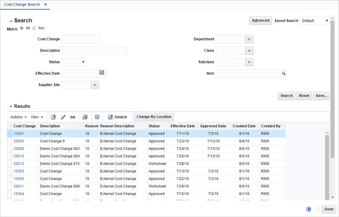

You can access the Cost Change Search page from the Task menu, select Cost > Manage Cost Changes. The Cost Change Search page appears.
The Cost Change Search page contains the following sections.
Figure 2-1 Cost Change Search Page

Search for a Cost Change
To search for a cost change:
  1. From the Task menu, select Cost > Manage Cost Changes. The Cost Change Search page appears.
  2. You can search for a cost change by using basic or advanced search criteria, depending on the requirement. The basic mode is the default search mode.
    • Click Advanced to access the search section in advanced mode.
    • Click Basic to return to the basic mode.
Search for a Cost Change Through the Basic Search Criteria
To search for a cost change using basic search criteria:
  1. Enter, select or search for one or all of the following basic search criteria.
    Table 2-1 Cost Change Search - Basic Search Criteria and Description
    Fields Description
    Match option
    Check radio button All or Any.
    All - only suppliers matching all entered search criteria are shown.
    Any - suppliers matching any of the entered search criteria are shown.
    Cost Change
    Enter the cost change number.
    Description
    Enter the cost change description.
    Status
    Select the status of the cost change from the list.
    Effective Date
    Enter the effective date for the cost change, or use the Calendar icon to select a date.
    Supplier Site
    Enter, select or search for the supplier site.
    Department
    Enter, select or search for the department.
    Class
    Enter, select or search for the class.
    Subclass
    Enter, select or search for the subclass.
    Item
    Enter, select or search for the item.
  2. Click on the Saved Search list to select one of the saved search criteria. Selecting a saved search populates the search section with the saved search criteria. If the run automatically function is enabled for the search, the search is executed immediately.
    You can also personalize your saved searches by selecting Personalize. The Personalize Saved Searches page appears.
    For more information about the Personalized Saved Search, see Personalize Saved Search in the Oracle® Retail Merchandising Foundation Cloud Service Do the Basics User Guide.
  3. Click Search. The cost changes that match the search criteria are displayed in the Results section.
  4. Click Reset to clear the search section and results.
  5. Click Save As... to save the current search criteria. The Create Saved Search page appears.
    For more information about how to save your search criteria, see Create Saved Search in the Oracle® Retail Merchandising Foundation Cloud Service Do the Basics User Guide.
  6. Click Done to close the page.
