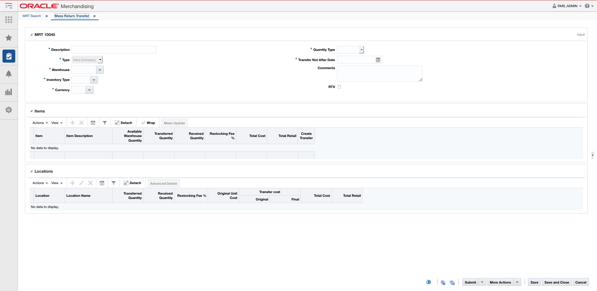

From the Tasks menu, select Inventory > Transfers > Create Mass Return Transfer. The Mass Return Transfer page appears.
Table 4-1 Mass Return Transfer Header - Fields and Description
| Fields | Description |
Title |
The title displays the Mass Return Transfer ID. The MRT Status is displayed at the top right of the header. This field contains the MRT number by default. |
Description |
Enter a description of the mass return transfer. This field is a required field. |
Type |
Select the type of the MRT you are creating. The options are:
Warehouse |
Enter, select or search for the warehouse. This field is a required field. |
Currency |
Enter, select or for search the currency. This field is a required field. |
Quantity Type |
Select how you will determine the number of items to transfer. The options are:
Transfer Not After Date |
Enter the last date the transfer can occur, or click the Calendar icon to select a date. This field is a required field. |
Comments |
Enter any additional comments as necessary. |

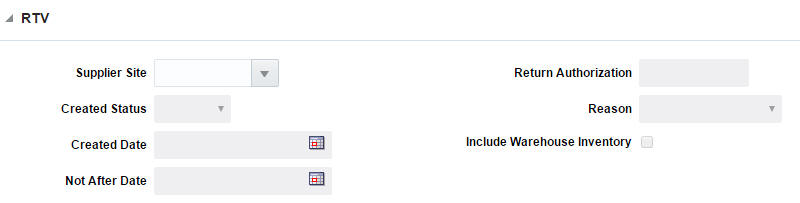

RTV |
Select the RTV. The RTV section appears. For more information on the RTV, see the Create with an RTV section. |
Once you select the RTV checkbox, the RTV section appears in the Mass Return Transfer page.
The RTV section includes the following fields.
Table 4-2 RTV - Fields and Description
Supplier Site |
Enter, select or search for the supplier site. |
Created Status |
Select the status the RTV will be created in. The options are: Input, Output, and Manual. |
Created Date |
Enter the date the RTV is created, or use the Calendar icon to select a date. |
Not After Date |
Enter the last date the transfer can occur, or use the Calendar icon and select a date. |
Return Authorization |
Enter the return authorization number of the supplier. |
Reason |
Select the reason you are creating the RTV. |
Include Warehouse Inventory |
Select this option to indicate warehouse inventory is included in the creation of the RTVs. |

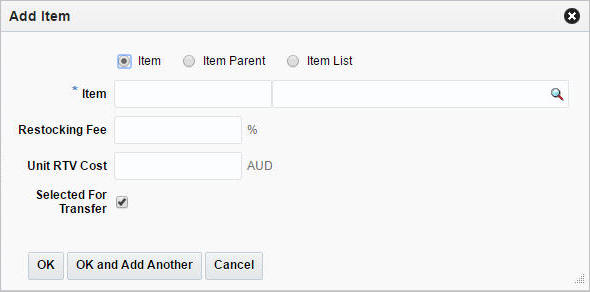

To add items to a mass return transfer, follow the steps below.
In the Mass Return Transfer page, go to the Items section.
From the Actions menu, select Add or click the Add icon
. The Add Item pop-up appears.
Select any one of the following options: Item, Item Parent, or Item List.
In the Item field, enter the item or search and select from the list. This is a required field.
In the Restocking Fee % field, enter the percentage that is applied for restocking fees.
In the Unit RTV Cost field, enter the Unit RTV cost for the item
The Selected For Transfer checkbox is selected by default. This indicates whether the transfer for the item should be created when the MRT is approved or not.
Then choose one of the following option.
Click OK to add the item and close the page.
Click OK and Add Another to add additional items.
Click Cancel to reject all entries and close the page.

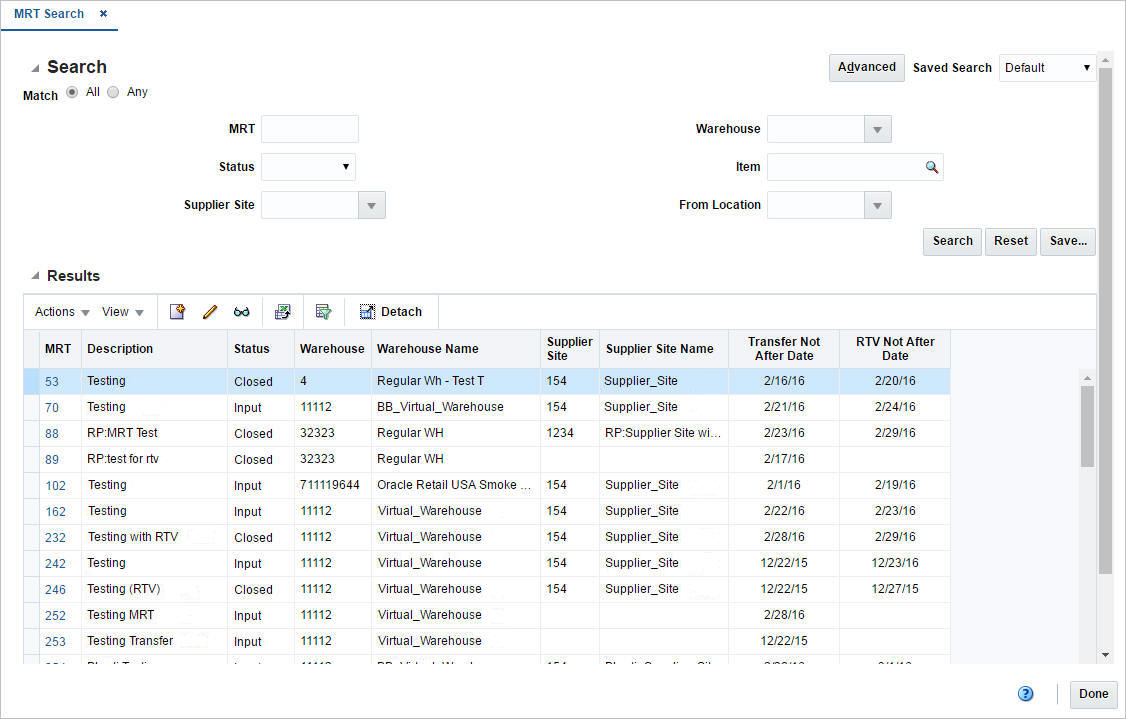

You can access the MRT Search page from the Task menu, select Inventory > Transfers > Manage Mass Return Transfer. The MRT Search page appears.
In the MRT Search page you can search for mass return transfers by specifying various search criteria. You can choose to access mass return transfers in the search results in edit or view mode depending on security privileges. There are also options for creating a new mass return transfer.
To search for an MRT:
From the Tasks menu, select Inventory > Transfers > Manage Mass Return Transfer. The MRT Search page appears.
You can search for a mass return transfer by providing search criteria in the search section. The criteria can be provided either in Basic or Advanced mode, depending on the requirement. Basic is the default mode when the search page is entered. Click Advanced to access search panel in advanced mode. You can return to Basic mode by clicking Basic.
To search for an MRT through the basic search criteria:
Enter or select one or all of the following basic search criteria.
Table 4-4 MRT Search - Basic Search Criteria and Description
Match option |
Check radio button All or Any. All - only MRTs matching all entered search criteria are shown. Any - MRTs matching any of the entered search criteria are shown. |
MRT |
Enter the MRT description. |
Status |
Select the status of the mass return transfer. The options are: Input, Submitted, Approved, RTV Created, Closed. |
Supplier Site |
Enter the supplier site, select or search the supplier site and number from the list. |
Warehouse |
Enter the warehouse ID, select or search the warehouse. |
Item |
Enter the item number of the item or search the item. |
From Location |
Enter the location or select and search the location and the ID. |
For more information about searches, see Search Screens in the Oracle® Retail Merchandising Foundation Cloud Service Do the Basics User Guide.Click Search. The MRTs that match the search criteria are displayed in the Results section.
Click Reset to execute the saved search.
Click Done to close the page.

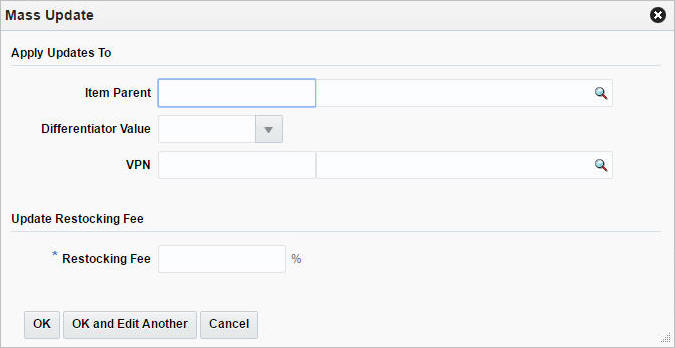

To update the Restocking fee based on either an Item Parent, a Differentiator, or VPN use the Mass Update function in the Mass Return Transfer page.
In the Items section, select Actions > Mass Update, or use the Mass Update button. The Mass Update pop-up appears.
In the Apply Updates to section, you can choose any one of the following fields: Item Parent, Differentiator Value, or VPN. You can narrow down the items for which restocking fee % will be updated. If none of the values are chosen, the update will be applicable to all the items.In the Update Restocking Fee section, enter the intended value of Restocking Fee % . This field is a required field.
Then choose one of the following options.
Click OK to commit the mass update and close the pop-up.
Click OK and Edit Another to commit the changes and edit an additional mass update.
Click Cancel to reject all entries and close the pop-up.

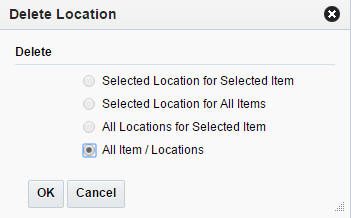

To select delete location options, follow the steps below.
In the Mass Return Transfer page, go to Locations section.
From the Actions menu, click the Advanced Delete button.The Delete Location pop-up appears.
You can delete any one of the following options:
Selected Location for Selected Item
Selected Location for All Items
All Locations for Selected Item
All Item/Locations
Click OK to delete the locations.
Click Cancel to reject all entries an close the pop-up.
