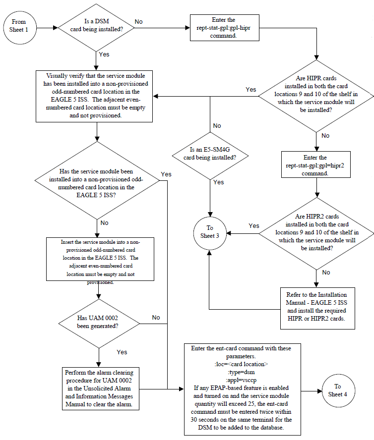

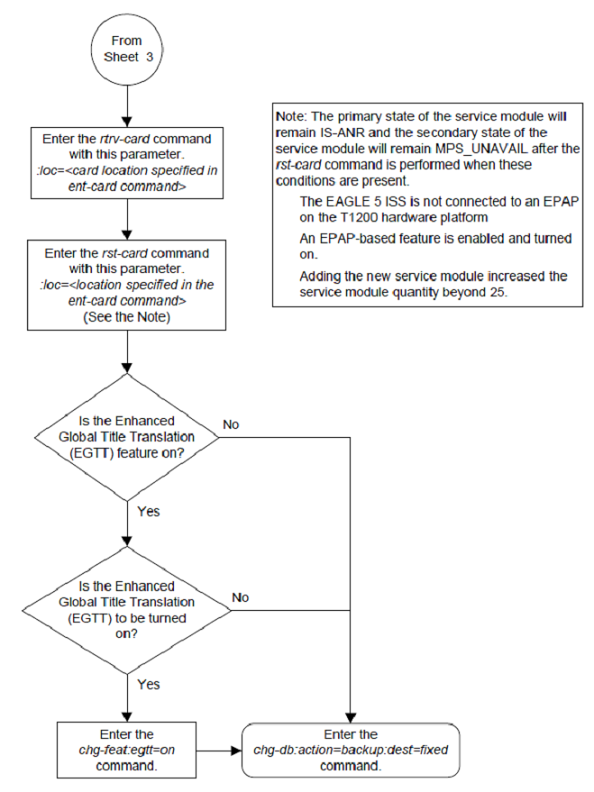

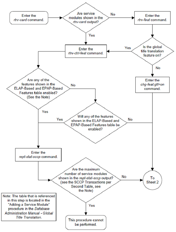

This procedure is used to add a service module to
support the Global Title Translation or Enhanced Global Title Translation
feature to the database using the
ent-card command.
The card that is used as a service module depends on the
GTT related features that are being used and the features that will enabled
after this procedure is performed. The features or feature combinations shown
in
Table 2-31
show the type of card that must be installed in the EAGLE to meet the minimum
EAGLE performance requirements. The features that are currently being used by
the EAGLE are shown in the
rtrv-feat or
rtrv-ctrl-feat command outputs.
Table 2-31 Service Module and Feature Combinations
| Card | Features |
E5-SM8G SLIC |
Any of these features:
or GTT and EGTT (if the Enhanced Global Title Translation feature is on) in combination with at least 2 of these features:
The E5-SM8G-B can be inserted only in the odd numbered card slots of the control or the extension shelf. Slots 09 and 10 of each shelf contains the HIPR2 card, thus the E5-SM8G-B cannot be inserted in slot 09 and 10. The E5-SM8G-B can be inserted in the control shelf, but only in slots 01, 03, 05, 07 and 11. The E5-SM8G-B occupies two card slots, so the even numbered card slot adjacent to the odd numbered slot where the E5-SM8G-B has been inserted must be empty, as shown in Table 2-32. The E5-SM8G-B is connected to the network through the odd numbered card slot connector. The E5-SM8G-B requires two HIPR2 cards in the shelf where it is installed.
The SLIC can be inserted only in the odd numbered card slots if it is
provisioned with the
type=dsm parameter of the
ent-card command. The SLIC can be
inserted in odd or even numbered card slots if it is provisioned with the
type=slic parameter of the
ent-card command.
Table 2-32 Card Locations
| Location of the E5-SM8G-B | Empty Card Location |
| Slot 11 | Slot 12 |
| Slot 13 | Slot 14 |
| Slot 15 | Slot 16 |
| Slot 17 | Slot 18 |
The
ent-card command uses these
parameters:
:loc – The location
of the card being added to the database.
:type – The type of
card being added to the database. The value of this parameter is
dsm or
slic.
:appl – The
application software that is assigned to the card. The value of this parameter
is
vsccp.
:data – The data type
of the card when running the EPAP Data Split feature and the Dual ExAP
Configuration feature. The value of this parameter is
dn or
imsi for the EPAP Data Split feature
and
ELAP,
EPAP or
GTT for the Dual ExAP Configuration
feature.
The shelf to which the card is to be added must already
be in the database. This can be verified with the
rtrv-shlf command. If the shelf is not
in the database, perform the "Adding a Shelf" procedure in
Database Administration – System Management User's
Guide.

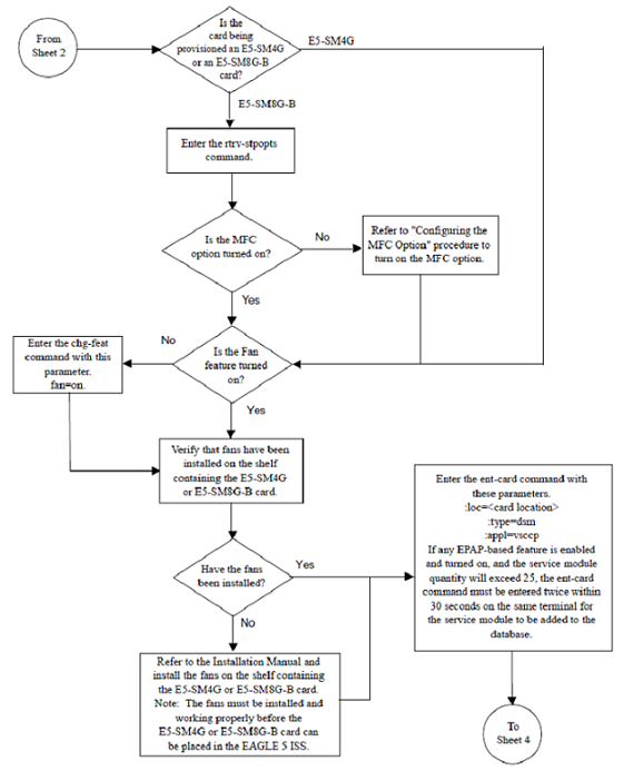

The card cannot be added to the database if the specified card location already has a card assigned to it.
If you want to add an E5-SM8G-B or SLIC card as the service module, verify the temperature threshold settings for the appropriate card by performing the "Changing the High-Capacity Card Temperature Alarm Thresholds" procedure in Database Administration - SS7 User's Guide. The E5-SM8G-B card also requires a fan tray.rtrv-card command to verify that
the card location for the new service module is not provisioned. This is an
example of the possible output.
Cards should be distributed throughout the EAGLE for proper power distribution. Refer to Installation Guide for the shelf power distribution.This is an example of the possible output:

If the
rept-stat-sccp output shows that
the EAGLE has the maximum number of service modules, as shown in
Table 2-36,
the remainder of this procedure cannot be performed.
the EAGLE does not have the maximum number of service modules, as shown in
Table 2-36,
continue the procedure by performing one of these steps.
rept-stat-gpl:gpl=hipr2

If HIPR2 cards are installed at card locations 9 and 10 in the shelf where the E5-SM8G-B card will be installed, continue the procedure with 7.
If HIPR2 cards are not installed in the shelf where the E5-SM8G-B card will be installed, refer to Installation Guide to install the HIPR2 cards. Once the HIPR2 cards have been installed, continue the procedure with 7.
rtrv-feat output in
2
as being
on, and in the
rtrv-ctrl-feat output in
4
as being enabled) and any features that will be enabled after this procedure is
performed.
Caution:
If the versions of the flash GPLs on the service module do not match the flash GPL versions in the database when the service module is inserted into the card slot, UAM 0002 is generated to indicate that these GPL versions do not match. If UAM 0002 has been generated, perform the alarm clearing procedure for UAM 0002 in Unsolicited Alarm and Information Messages Reference before proceeding with this procedure.enable-ctrl-feat:fan=on command to
turn on the fan.
enable-ctrl-feat:MFC=on to turn it
on.
ent-card command. For this example,
enter this command.
ent-card:loc=1301:type=dsm:appl=vsccp
If any EPAP-based feature is enabled and turned on, and the service module quantity will exceed 25, theent-card command must be entered
twice within 30 seconds on the same terminal for the service module to be added
to the database.

rst-card command with the card
location specified in
10.
For this example, enter this command.
rst-card:loc=1301
The primary state of the service module will remainIS-ANR and the secondary state of
MPS_UNAVAIL after the
rst-card command is performed when
these conditions are present.
When this command has successfully completed, this message should appear.
rlghncxa03w 09-07-28 08:21:07 GMT EAGLE5 41.1.0 Card has been allowed.
EGTT = on in the
rtrv-feat command output in
2
, or if the EGTT feature is off and will not be turned on in this procedure,
25.
Once the Enhanced Global Title Translation (EGTT) feature is turned on with thechg-feat command, it cannot be
turned off.
The EGTT feature must be purchased before turning it on. If you are not sure whether you have purchased the EGTT feature, contact your Sales Representative or Account Representative.
When the
chg-feat has successfully
rlghncxa03w 09-07-25 09:57:41 GMT EAGLE5 41.1.0 CHG-FEAT: MASP A - COMPLTD
chg-db:action=backup:dest=fixed

Figure 2-36 Add a Service Module - Sheet 1 of 4
Figure 2-37 Add a Service Module - Sheet 2 of 4
Figure 2-38 Add a Service Module - Sheet 3 of 4
Figure 2-39 Add a Service Module - Sheet 4 of 4
