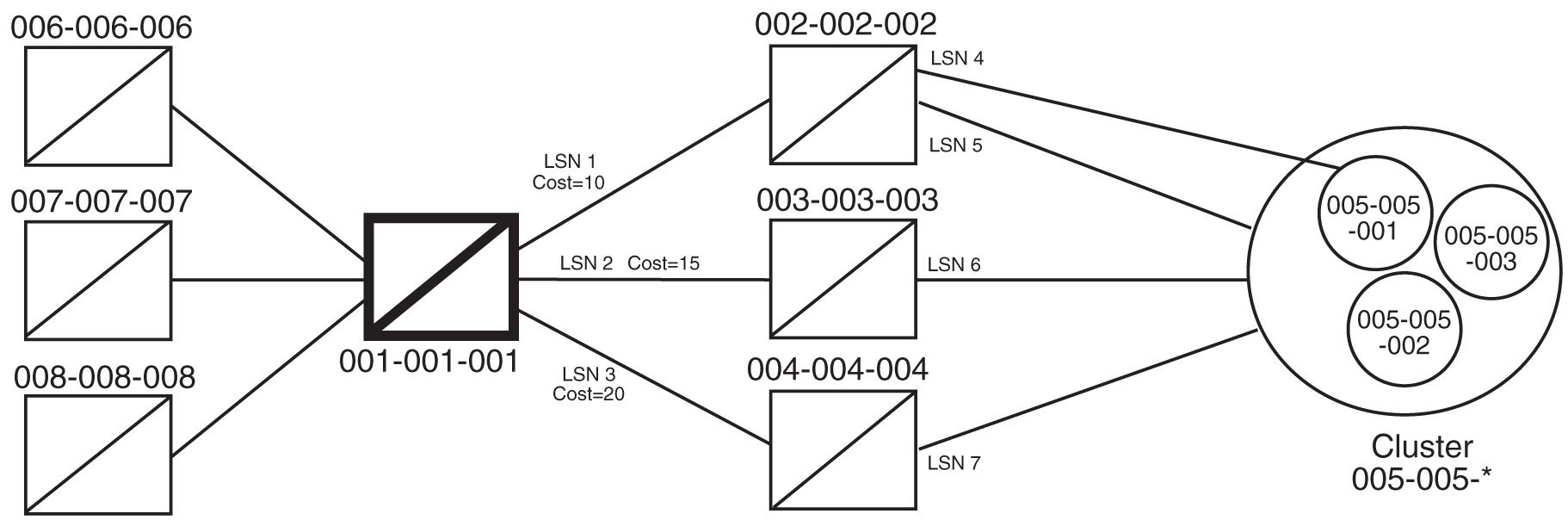

Cluster Routing and Management Diversity Example
This section shows an example of the Cluster Routing and Management Diversity feature, and lists the network events affecting the EAGLE. This example is based on Figure 2-22 and Table 2-7.
Figure 2-22 Cluster Management
Table 2-7 Example Cluster Routing Information
| Route Table for Destination 005-005-001 | Route Table for Cluster 005-005-* | |
| 1 |
LSN 1, Cost=10 |
LSN 1, Cost=10 |
| 2 |
LSN 2, Cost=15 |
LSN 2, Cost=15 |
| 3 |
LSN 3, Cost=20 |
LSN 3, Cost=20 |
When the normal routes, linksets LSN 1 and LSN 2, become available, the EAGLE sends a preventive TFP for destination 005-005-001 and a preventive TCP for cluster 005-005-* to node 002-002-002, and starts routing messages to destination 005-005-001 and cluster 005-005-* using linkset LSN 1. The EAGLE broadcasts TFAs about destination 005-005-001 and TCAs about cluster 005-005-* to all other adjacent nodes.
When the level 3 timer T11 for destination 005-005-001 expires, TFRs are broadcast for destination 005-005-001 to nodes 004-004-004, 006-006-006, 007-007-007, and 008-008-008. Destination 005-005-001 is restricted.

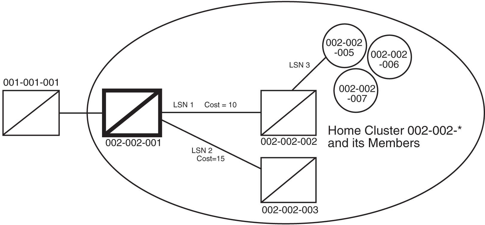

Home Cluster Example
Figure 2-23 Home Cluster Example
Table 2-8 Home Cluster Routing Information
| Route table for Destination 002-002-005 | Route table for cluster 002-002-* | |
| 1 |
LSN 1, Cost=10 |
LSN 1, Cost=10 |
| 2 |
LSN 2, Cost=15 |
LSN 2, Cost=15 |
A home cluster is a cluster point code that contains either the true point code or any capability point code of the EAGLE. For example, if the EAGLE’s true point code or any capability point code is 002-002-001 and a cluster 002-002-* is configured, then the cluster 002-002-* is a home cluster.
Provisioning a home cluster causes a profound impact on network management, regarding the home cluster as well as members of the cluster. These impacts are:
This makes network management unreliable for the home cluster and its members.
When the normal routes, linksets LSN 1 and LSN 2, become available, the EAGLE sends a preventive TFP for destination 002-002-005 to node 002-002-002, and starts sending messages to destination 002-002-005 and cluster 002-002-* using linkset LSN 1. No preventive messages are sent for cluster 002-002-*. The EAGLE broadcasts a TFA for destination 002-002-005 and a TCA for cluster 002-002-* to all other adjacent nodes.
