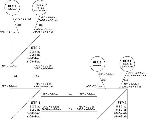

Figure 2-11 shows an example network. The items shown in bold are items that are added during this stage of the migration procedure.
The following steps are performed for each node shown in Figure 2-11, one at a time, as part of this stage of the migration procedure.
  1. Upgrade each EAGLE shown in Figure 2-11 to the software release that contains the ITU National and International Spare Point Code Support feature by performing the appropriate upgrade procedure.
  2. Enable the ITU National and International Spare Point Code Support feature on each EAGLE shown in Figure 2-11, by performing the Activating the ITU National and International Spare Point Code Support Feature procedure. Do not turn the feature on at this time.
    Provisioning for the ITU National and International Spare Point Code Support feature can be performed once the feature is enabled. Message processing based on this feature is not performed until the feature is turned on.
  3. Add a new true ITU-National spare point code in the self identification table of each EAGLE by performing the Adding a Point Code to the Self-Identification of the EAGLE procedure at each EAGLE. For example, add these point codes:
    • Point code s-3-2-2-ab to STP 1
    • Point code s-2-2-1-ab to STP 2
    • Point code s-5-2-2-ab to STP 3.
  4. Add one secondary ITU-National spare point code to each EAGLE by performing the Adding a Secondary Point Code procedure. For example, add these point codes:
    • Point code s-0-0-1-ab to STP 2
    • Point code s-0-0-2-ab to STP 1
    • Point code s-0-0-3-ab to STP 3.
  5. Add a secondary adjacent ITU-National spare point code (SAPC) to the linksets whose APCs have the “ab” suffix by performing the Configuring an ITU Linkset with a Secondary Adjacent Point Code (SAPC) procedure. For example, add these secondary adjacent point codes:
    • SAPC s-0-0-1-ab for linkset LS3 in STP 1
    • SAPC s-0-0-2-ab for linkset LS3 in STP 2
    • SAPC s-5-2-2-ab for linkset LS5 in STP 1
    • SAPC s-3-2-2-ab for linkset LS5 in STP 3
    • SAPC s-1-2-1-ab for linkset LS2 in STP 2
    • SAPC s-7-2-1-ab for linkset LS8 in STP 3.
    This provisioning must be done before National Spare traffic can be routed over the linksets whose APCs have the “ab” suffix using the ITU National and International Spare Point Code Support feature. As a result of this provisioning, linksets LS2, LS3, LS5, and LS8 can support traffic to and from ITU-National spare point codes as well as ITU-National point codes.
  6. Provision the routes for the ITU-National spare point codes provisioned in step 5 by performing one of these procedures as required.
    For example, provision a route to point code s-1-2-1-ab on LS3 at STP 1.
Figure 2-11 Stage One - ITU National and International Spare Point Code Support Feature Provisioned on All Nodes
After Stage One has been completed, as indicated in Figure 2-11, linksets LS2, LS3, LS5, and LS8 are capable of supporting traffic to and from both ITU-National and ITU-National spare point codes. Routing decisions, however, are still made using the Duplicate Point Code rules, as the ITU National and International Spare Point Code Support feature has not been turned on.

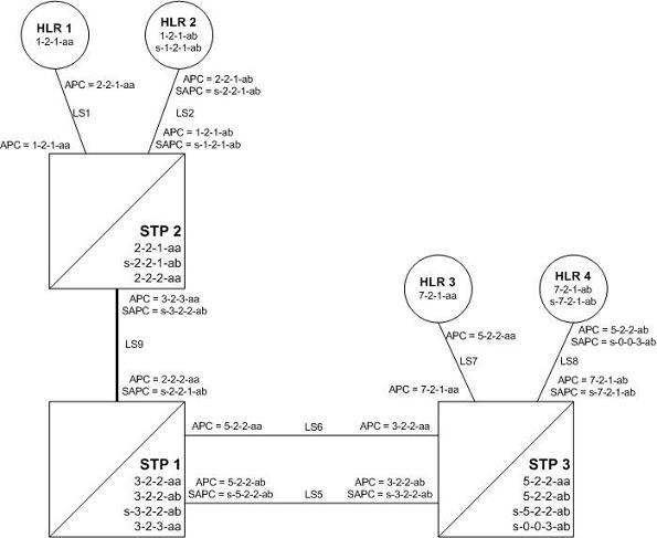

  5. Create a third linkset, LS9, that contains high-speed signaling links with these APC and SAPC values:
    • The APC for linkset LS9 on STP 2 is 3-2-3-aa
    • The APC for linkset LS9 on STP 1 is 2-2-2-aa
    • The SAPC for linkset LS9 on STP 2 is s-3-2-2-ab
    • The SAPC for linkset LS9 on STP 1 is s-2-2-1-ab.

    The traffic from linksets LS3 and LS4 will be merged onto linkset LS9. Linkset LS9 will be the only linkset that will remain between STP 1 and STP 2 after the migration is complete.

  7. Change the routes on STP 1 to s-1-2-1-ab and 1-2-1-aa so that all National and National Spare traffic uses linkset LS9 by performing the Changing a Route procedure. At this point, incoming National Spare traffic to STP 1 still uses linkset LS3, and incoming National Spare traffic to STP 1 still uses linkset LS4 until the routes on STP 2 are changed so that all National and National Spare traffic uses linkset LS9.
  8. Provision routes on the adjacent nodes to include the new true and secondary point codes that were added to STP 1 and STP 2. Perform one of these procedures as required.
All traffic (National and National Spare) should now be flowing on linkset LS9.
Figure 2-12 Stage Two - All Traffic Merged onto a Third Linkset
In Figure 2-12, all traffic between STP 1 and STP 2 is routed over linkset LS9, using the national spare network indicator value 3 ( NI=11binary) and the national network indicator value 2 ( NI=10binary) to select the route. Note that linkset LS3 and linkset LS4 are not being used.

At this point, after all affected linksets have been merged, the situation looks like Figure 2-13. Both National and National Spare traffic between STP 2 and STP 1 are sent over linkset LS9. Traffic between STP 1 and STP 3 continues to route over linkset LS6 for ITU-National point code/group code aa and over linkset LS5 for ITU-National spare point code/group code ab. This is because the ITU National and International Spare Point Code Support feature has been turned on for STP 1 but not for STP 3, so the routes have not been changed between STP 1 and STP 3.
Figure 2-13 Stage Three - All Traffic Merged onto Linkset LS9
