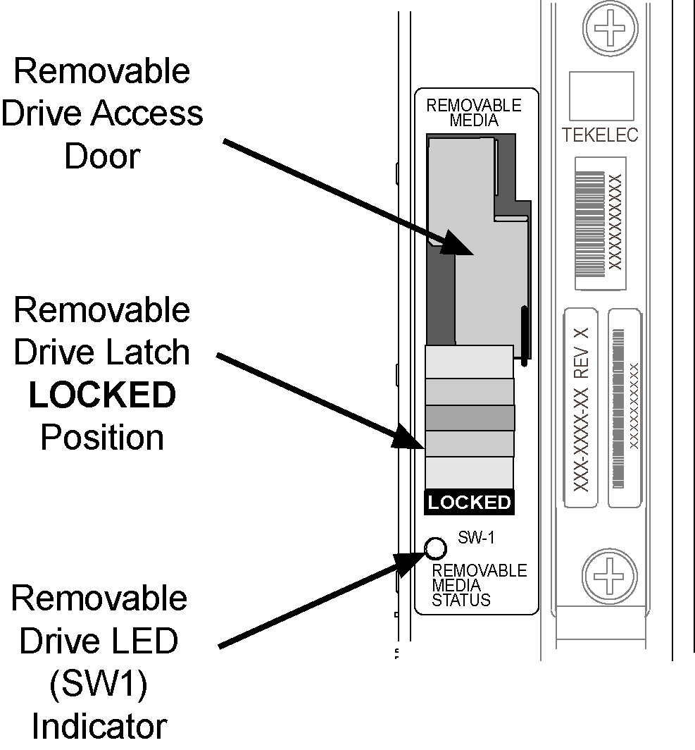

  1. Verify that the removable USB drive is locked in position and in use.
    The removable drive latch (SW1) is in the LOCKED position and the Removable Media Status LED on the E5-MASP is Off. Refer to Figure 2-1.
    Figure 2-1 Removable USB Drive LOCKED

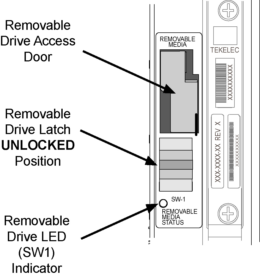

  2. Move SW1 from the LOCKED to the unlocked position and wait for the LED to indicate a steady blue state. See Figure 2-2.
    When SW1 is transitioned from locked to unlocked, the LED will flash blue to indicate the drive is unlocked and in process of shutting down.
    Caution:
    Removal of the drive prior to the LED indicating steady blue could result in drive corruption.
    Figure 2-2 Removable USB Drive UNLOCKED
  3. When the LED indicates a steady blue state, the removable USB drive can be safely removed. The LED is off when the USB drive is fully ejected from the drive media.
    The USB drive can now be removed from the drive media.
