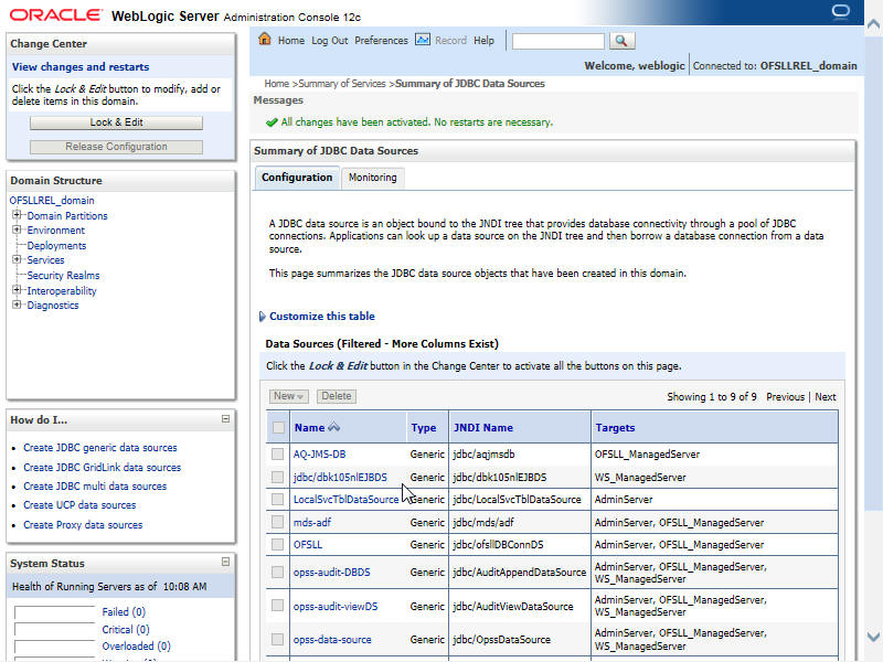

3.1 Creating Data Sources for WebServices
it is assumed that a managed server is already created for the following web service deployment(s) as per the process detailed in Application Installation guide section - 3.2 Creating Domain and Servers.
- Login to WebLogic Server 12c console (http://hostname:port/console).
- The following window is displayed.
- Click Domain Name > Services > Data Sources. The following window is displayed.
- Click ‘Lock & Edit’ button on the left panel. Click ‘New’ on right panel and select ‘Generic Data Source’.

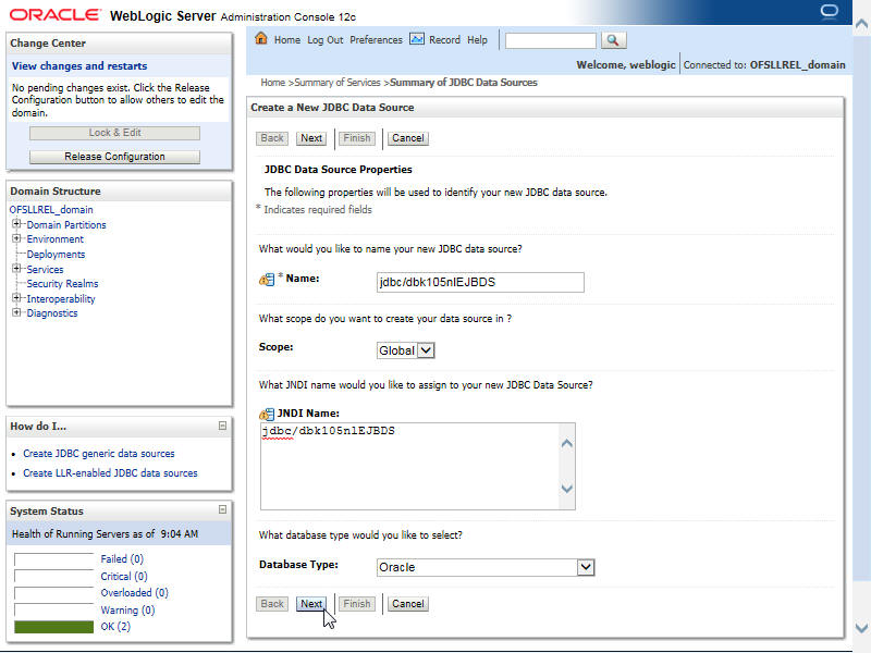

- Specify the following details:
- Enter Data source Name.
- Enter JNDI Name as ‘jdbc/dbk105nlEJBDS’.
- Select ‘Oracle’ as Database Type.
- Click ‘Next’. The following window is displayed.

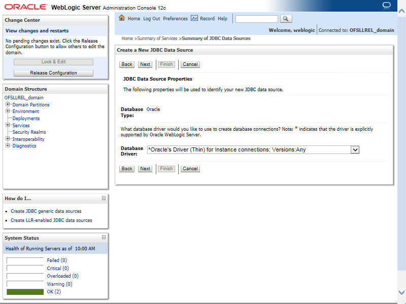

- Select the Database Driver ‘Oracle's Driver(Thin) for Instance connections;Versions:Any’ as shown.

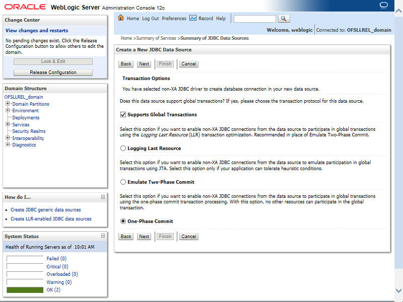

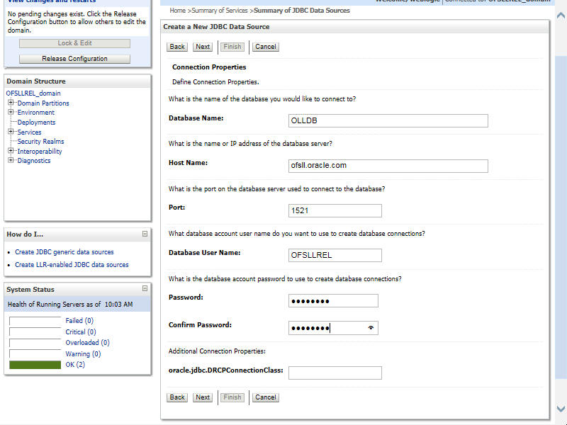

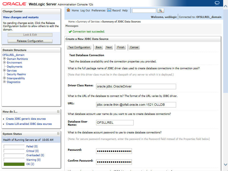

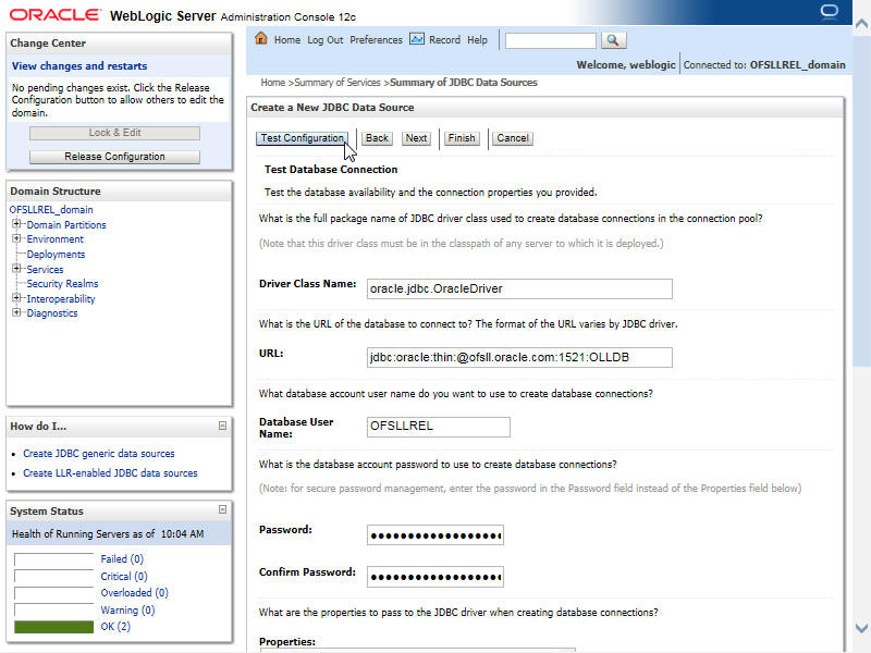

- Enter the Database details.
- Click ‘Test Configuration’. The following window is displayed indicating a confirmation message as ‘Connection test succeeded’.

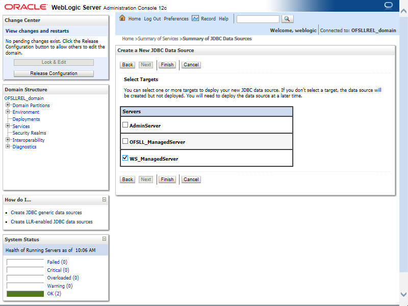

- Select ‘WS_ManagedServer’ as the target Web service Server and click ‘Finish’. The following window is displayed.

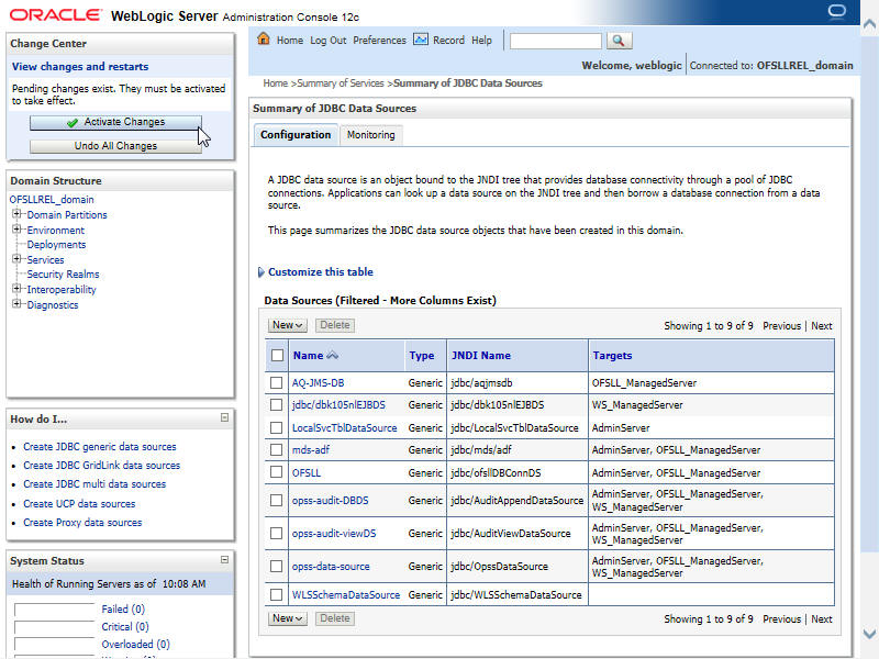

- Click ‘Activate Changes’.
Similarly follow the above steps to create the following data sources:
- jdbc/dbkwsDS
- jdbc/IN1HukWznG0b4esj

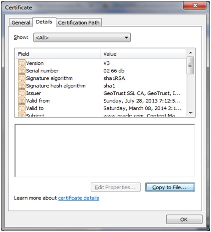

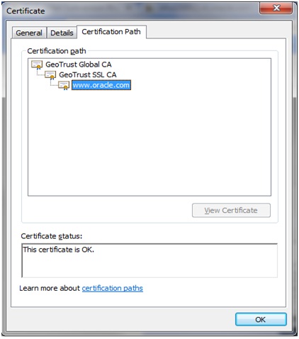

- Click on the padlock and choose ‘View Certificates’.
- Click on the Certification Path tab and select the certificate with the ‘Name’ and ‘Issued To’ the same as the user-defined ID.

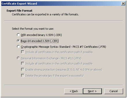

- Go to the Details tab.
- Click on the ‘Copy to File’ button, and click ‘Next’. Select ‘Base-64 encoding’ and save the file somewhere on your local computer.
- Run following command to import certificate into JKS(dls_cacerts)

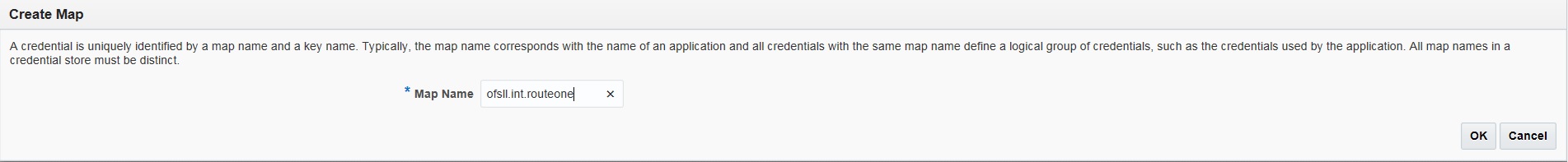

- Click ‘Create Map’. The following window is displayed.
- Enter Map Name as ‘ofsll.int.routeone’ and click ‘OK’.

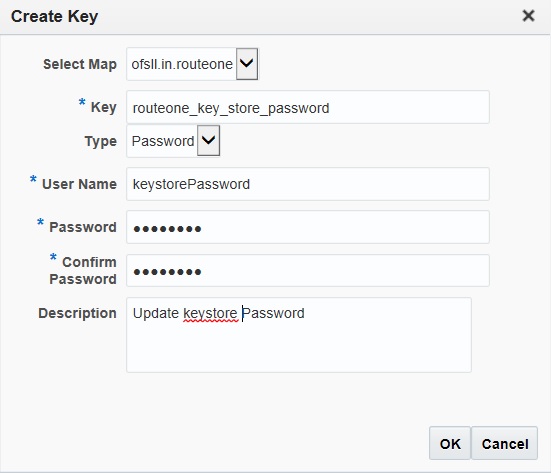

- Click ‘Create Key’. The following window is displayed.
- Click ‘OK’.
Similarly you need to create the following Maps and corresponding keys as indicated in following table.
Maps
Key Name
Username
Password
Description
ofsll.int.routeone
routeone_key_store_pd
keystorePassword
changeit
The keystore password
routeone_key_alias
roKeyAlias
routeone_pub_tst
RouteOne's public key alias name.The public key is needed to verify the xml signature of the request.
routeone_sscro_key_pd
sscroKeyAlias
ssc_routeone
OFSLL's private key alias name. The private key is used to sign xml response to RouteOne
routeone_sscro_key_passsword
sscroKeyPassword
demotestSSCR1
OFSLL's private key password

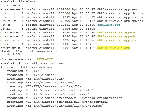

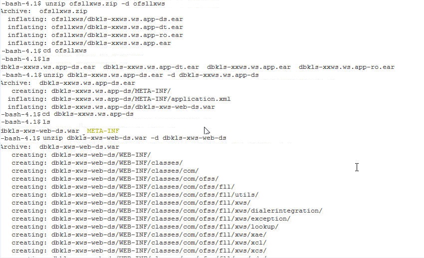

- Unzip all the ear files present:
- dbkls-xxws.ws.app.ear
- dbkls-xxws.ws.app-dt.ear
- dbkls-xxws.ws.app-ro.ear
- dbkls-xxws.ws.app-ds.ear
- Open each of the unzipped files and unzip the war file.
- It creates a WEB-INF file
After unzipping the war file to directory, the directory will have the following structure
- dbkls-xxws.ws.app / dbkls-xxws.ws.app-ds / dbkls-xxws.ws.app-dt / dbklsxxws.ws.app-ro

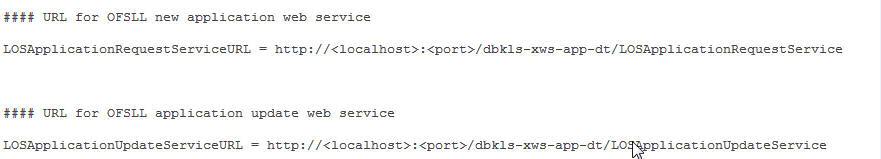

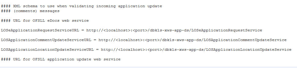

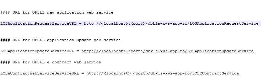

- To edit the web interface config files, navigate to the above WEB-INF > classes > config. Edit the following configuration files with the application url and port.
For complete details on configuration parameters, refer to “Configuration parameters” section in Appendix chapter.
- ds_servlet_init.conf-This is the configuration file only for edocs servlet interface
- dt_servlet_init.conf- This is the configuration file only for dealer track servlet interface
- ro_servlet_init.conf- This is the configuration file only for route one servlet interface

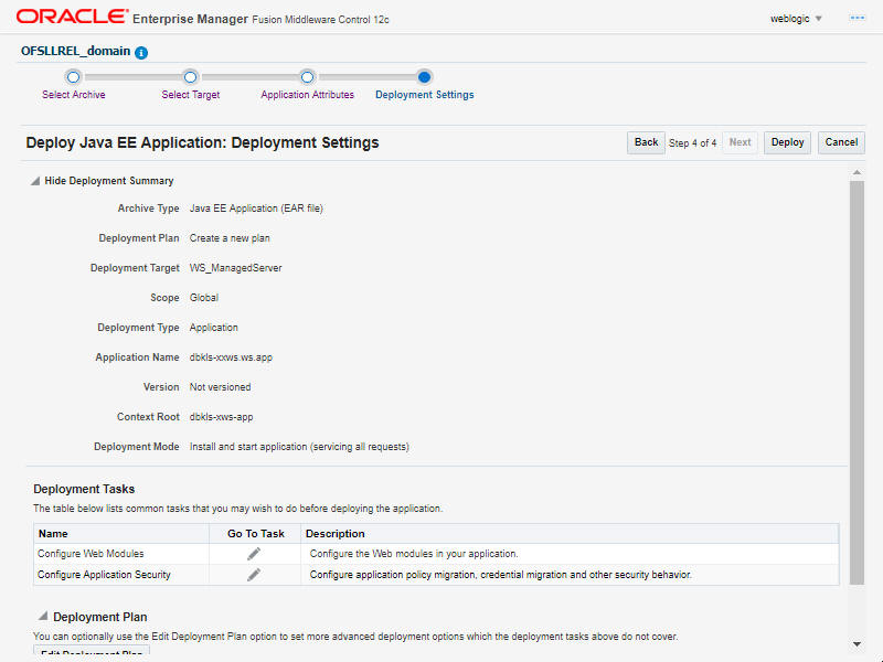

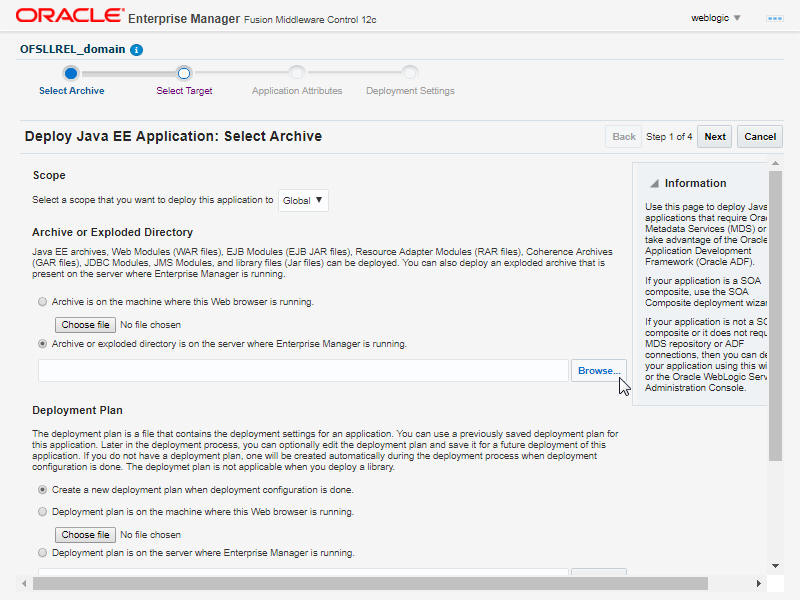

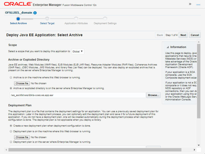

- Right click on ‘WS_ManagedServer’ in left panel, select Application Deployment > Deploy.
- Browse to the folder containing the WebService.
Eg: /ws-as/ofsllxws/dbkls-xxws.ws.app
Click ‘Next’.

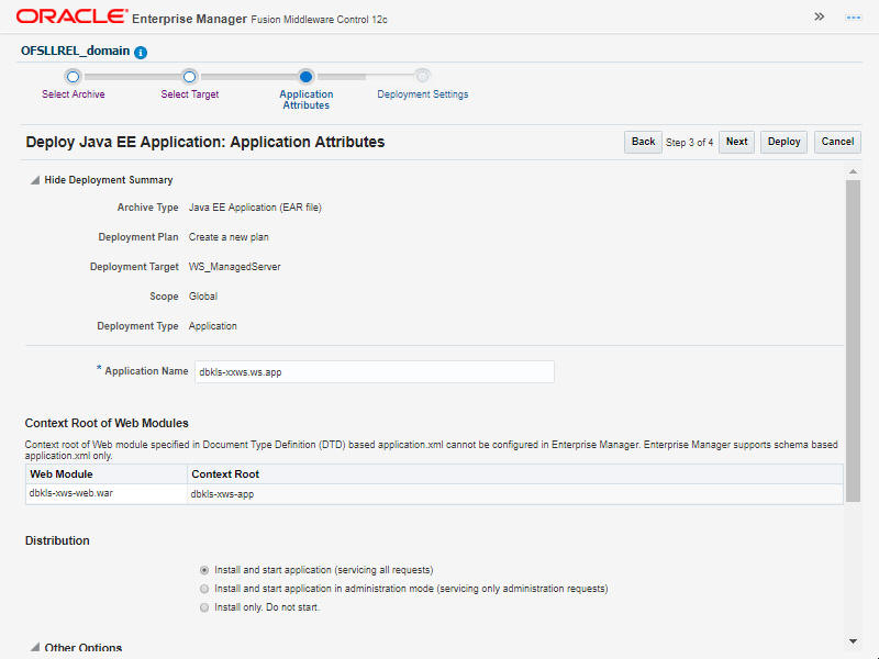

- The following window is displayed. Select the server on which the WebService needs to be deployed. Click ‘Next’.
- The following window is displayed. Check the context root and select the Distribution option as ‘Install and start application (servicing all requests)’. Click ‘Next’.

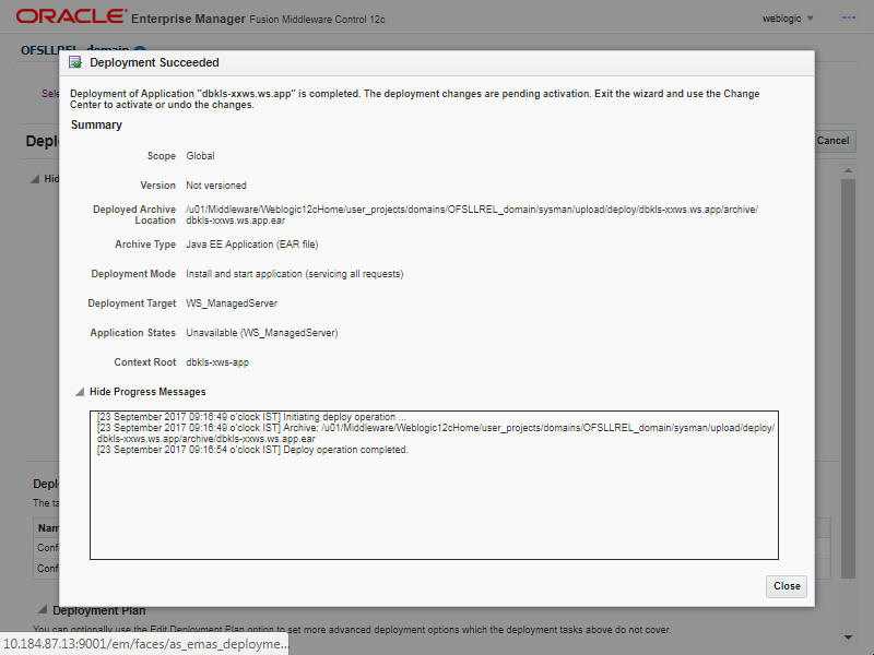

- The following window is displayed. Click ‘Deploy’.
- The following window is displayed. Click ‘Close’.

- In case the context root has to be changed for the WebServices, it can be changed by editing the application.xml or through the console. To change through console, login to WebLogic Server 12c console (http://hostname:port/console).
- Go to Deployments > <select the service deployment> > Configuration General and modify the context root to the recommended name as follows:
Service
Service EAR
Recommended Context
Remark
Webservices
dbkls-xws-app
If this the recommended context name is not used, then the Service URLs in the configuration files needs to be changed
Edocs Interface
dbkls-xws-app-ds

Route One Interface
dbkls-xws-app-ro
