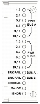

- This alarm indicates a power fault has been
identified by the breaker panel. The LEDs on the center of the breaker panel
(see
Figure 3-1)
identify whether the fault occurred on the input power or the output power, as
follows:
- A power fault on input power (power from site
source to the breaker panel) is indicated by one of the LEDs in the PWR BUS A
or PWR BUS B group illuminated red. In general, a fault in the input power
means power has been lost to the input power circuit.
LEDs in the PWR BUS A or PWR BUS B group that correspond to unused feeds are not illuminated; LEDs in these groups that are not illuminated do not indicate problems. - A power fault on the output power (power from the breaker panel to other frame equipment) is indicated by either BRK FAIL BUS A or BRK FAIL BUS B is illuminated red. This type of fault can be caused by a surge or some sort of power degradation or spike that causes one of the circuit breakers to trip.
Figure 3-1 Breaker Panel LEDs
