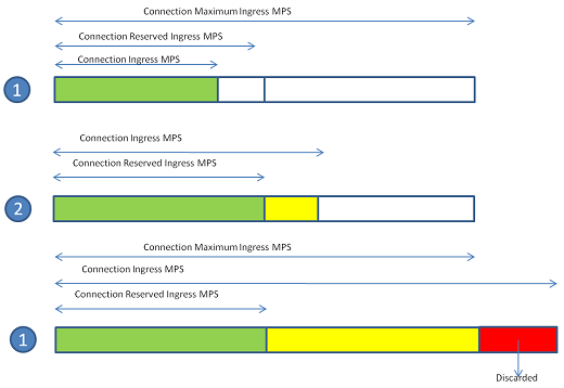

Per-Connection Ingress Message Coloring
In addition to enforcing ingress message rate limits on a per-connection basis, PCIMC colors ingress messages based on the reserved and average ingress message rates. message color can be used at other traffic shedding points, such as DA-MP Overload Control.
Traffic from under-utilized connections is marked green by per-connection ingress message controls, while traffic from over-utilized connections is marked yellow. Traffic discarded by PCIMC due to capacity exhaustion (per-connection or shared) is marked red and is not considered for any subsequent processing.
If the connection's reserved ingress MPS is 0, all the messages processed by the connection are colored yellow.Figure 12-1 Per-Connection Message Coloring
