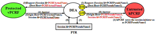

An example of a Protected-vPCRF to Untrusted-hPCRF Diameter transaction is shown in Figure 9-17.
Figure 9-17 Protected-vPCRF to Untrusted-hPCRF Transaction

An example of an Untrusted-hPCRF to Protected-vPCRF Diameter transaction is shown in Figure 9-18.
Figure 9-18 Untrusted-hPCRF to Protected-vPCRF Diameter Transaction
