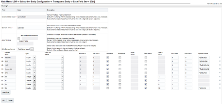

From an active
NOAM, add subscribers in UDR.
- Add the required
fields for the EIR subscriber profile according to .
List Field name Type Value Range Default Value White List WL INT 0-1 1 Gray List GL INT 0-1 0 Black List BL INT 0-1 0 Software Version SV INT 0-1 99 The EIR profile fields should look similar to Figure 4-1.
Figure 4-1 EIR Subscriber Screen
