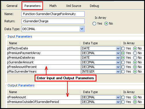

Steps to Configure a Function Override
  1. Make sure the Function is open in the Configuration Area. If not, double-click the .xml file to open it.
  2. Click the Parameters tab.
Function Parameters
Function Parameters Tab
  1. Enter the name of the function.
  2. Enter the return value. It is a best practice to begin the value with the letter r.
  3. Select the Data type.
  4. Click the radio button for Yes or No if function is an array.
  5. Click Add and click in the blank field to enter the input parameters.
    • input parameter name (best practice is to begin with the letter p)
    • select the data type from the drop down box.
    • specify whether it is an array.
  6. Click Add and click in the blank field to enter the output parameters.
    • output parameter name (best practice is to begin with the letter o).
