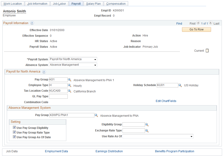

Use the Payroll page (JOB_DATA2) to select Absence Management as the absence system and assign pay group parameters for each payee whose absences are tracked through Absence Management.
Image: Job Data - Payroll page
This example illustrates the fields and controls on the Job Data - Payroll page.
For each payee whose absences you will track in Absence Management, you must do the following:
  1. Select Absence Management on the Installation Table - Products page.
  2. Assign the payee to a pay group on the Job Data - Payroll page in HR.
The pay group assignment determines the default values for the payee’s eligibility group. You can override these values for an individual payee on the Job Data - Payroll page.
Note: As part of the general setup for Absence Management, you must define payee job data defaults on the Pay Group Name page prior to selecting a pay group for a payee on the Job Data - Payroll page.
Note: If you do not select a holiday schedule for the payee on the Job Data - Payroll page, the system uses the holiday schedule assigned to the payee's pay group during absence processing .
Note: The Job Data - Payroll page is discussed in HR documentation. The Pay Group Name page is discussed elsewhere in this documentation.
