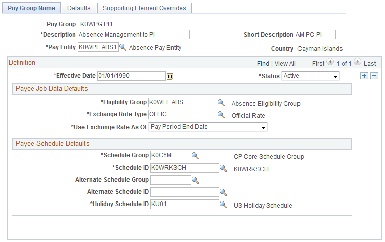

Use the Pay Group Name page (GP_PYGRP_NAME) to define pay group parameters.
Navigation
Image: Pay Group Name page
This example illustrates the fields and controls on the Pay Group Name page.
Field or Control |
Definition |
| Pay Entity |
Select the pay entity to associate with this pay group. You can link each pay group with only one pay entity. |
Warning! Once you've processed absences, never change the pay entity. Doing so can corrupt your data.
Payee Job Data Defaults
In this group box, you can define numerous default settings for a pay group. The effective date applies to the entire group box; therefore, you can change these options simultaneously if you have schedule, business process, or rule changes.
Note: Not every payee in a pay group has the same eligibility group, exchange rate type, or holiday schedule. You can override any default for an individual on the Job Data - Payroll page. Defaults can be overridden for certain periods of time through effective-dating. On the Job Data - Payroll page, the Absence Managementgroup box that includes eligibility group and exchange rate type appears only if you set the Absence System field to Absence Management.
Field or Control |
Definition |
| Eligibility Group |
Select the default eligibility group to associate with this pay group. Apply elements to payees in pay groups via eligibility groups. An eligibility group must be associated with a pay group. A payee is assigned to an eligibility group through the default defined at the pay group level. This default value can be overridden at the payee level. Note: Payees in an eligibility group are eligible for elements at the payee level, but if a payee isn't in an eligibility group for which an element is valid, that payee cannot be eligible for that element. |
Field or Control |
Definition |
| Exchange Rate Type |
Select the default exchange rate type that's used for currency conversions for this pay group during processing. You can specify an element in a currency other than the processing currency. During processing, it is converted to the processing currency, using this exchange rate information. Define exchange rate types on the Market Rate Type page. |
| Use Rate As Of |
Select the effective date for use in retrieving the exchange rate. The options correspond to the dates that you associate with this pay group. Values are Pay Period Begin Date, Pay Period End Date, and Payment Date. |
Payee Schedule Defaults
Define scheduling defaults for a pay group. Payees can be assigned a work schedule and an alternate work schedule based on the scheduling defaults defined for the payee's pay group.
Field or Control |
Definition |
| Schedule Group |
Select the schedule group for the pay group. Schedule groups allow you to categorize schedules into specific groups. |
| Schedule ID |
Select the schedule ID for the pay group. |
| Rotation ID |
Select the rotation ID for the selected the schedule ID. Rotation IDs are used with rotating schedules. Rotating schedules can be assigned to several payees with different schedule begin days. Note: The Rotation ID field only appears if you select a rotating schedule. |
| Alternate Schedule Group |
(Optional) Select an alternate schedule group for the pay group. |
| Alternate Work Schedule |
(Optional) Select an alternate work schedule. A payee can be associated with an alternate work schedule for some absences. |
| Alternate Rotation ID |
(Optional) Select an alternate rotation ID for the pay group. Note: The Alternate Rotation ID field only appears if you select a rotating schedule. |
| Holiday Schedule |
Select the holiday schedule for the pay group. The pay group's holiday schedule is used in processing if you do not select a different holiday schedule for the payee on the Job Data - Payroll page. However, the pay group holiday schedule is not entered as a default on the payee's Job record. |

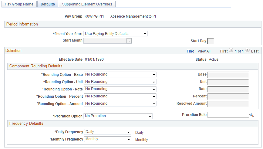

Use the Defaults page (GP_PYGRP_DFLT) to define default rounding, proration, and frequency conditions for a pay group.
Navigation
Image: Defaults page
This example illustrates the fields and controls on the Defaults page.
Period Information
Define dates for your pay group's fiscal year.
Field or Control |
Definition |
| Fiscal Year Start |
Define the start date of your organization's fiscal year for this pay group. Values are: Use Paying Entity Defaults: The next two fields become unavailable. Use Specified Start Date: Complete the next two fields. |
| Start Month and Start Day |
Enter the first month and the first day of the start month in your organization's fiscal year. |
Component Rounding Defaults
Specify default rounding rules for absence elements at the pay group level. You can specify rounding for individual absence elements when those elements are defined or direct the system to follow the pay group default settings.
Field or Control |
Definition |
| Rounding Option - Base, Rounding Option - Unit, Rounding Option - Rate, Rounding Option - Percent and Rounding Option - Amount |
Select an option to determine whether these components of an entitlement element can be rounded before calculation. Values are: No Rounding: Prevents rounding of the component. Use Specified Rounding: Enter a rounding rule in the corresponding field on the right. |
| Resolved Amount |
Select the rounding rule to apply to the resolved amount for absence elements. Rounding occurs after the system resolves the element's calculation rule. Values are: No Rounding: Prevents rounding of the amount. Use Specified Rounding: Enter a rounding rule in the field on the right. |
| Proration Option |
Select either No Proration or Use Specific Proration. |
| Proration Rule |
If you selected Use Specific Proration in the Proration Option field, enter the proration rule that is to be used as the default proration rule for elements being used to process this pay group. In defining an earning or deduction element, you can have the system use the pay group default value or have it specify a unique rule for a certain earning or deduction element. |
Frequency Defaults
Use this group box to define the frequency defaults used in multiple absence calculation components.
