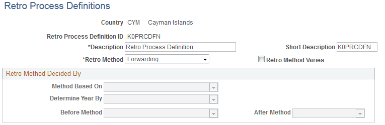

Use the Retro Process Definitions page (GP_RTO_PRC_DEFN) to define a retro process.
Navigation
Image: Retro Process Definitions page
This example illustrates the fields and controls on the Retro Process Definitions page.
| Field or Control | Definition |
| Retro Process Definition ID (retroactive process definition ID) | Identifies the retro process you are defining. |
| Retro Method | For Absence Management, this value should always be set to Corrective. |
| Retro Method Varies | Leave this check box empty. It applies only to Global Payroll. |
Retro Method Decided By
The fields in this group box apply only to Global Payroll.

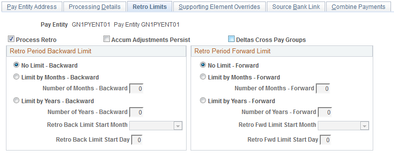

Use the Retro Limits page (GP_PYENT_RETRO) to define the backward and forward limits for retro processing at the pay entity level.
Navigation
Image: Retro Limits page
This example illustrates the fields and controls on the Retro Limits page.
After you have defined a retro method and the events that trigger retro processing, you must specify the backward and forward limits for retro processing at the pay entity level. This tells the system how far back in time to go to recalculate closed calendars, and how long a payee is eligible for retroactive processing after being inactivated or terminated.
Note: You can override backward and forward limits you define at the pay entity level using the Retro Limits Assignment page at the payee level.
Retro Period Backward Limit
Use the fields in this group box to limit the number of calendar periods that Absence Management can reprocess going into the past.
To determine how far back to go, the system compares the backward limit defined on the Retro Limits page to the retro trigger effective date. If the trigger effective date comes before the backward limit date, the system uses the backward limit date to determine the first retro period. If the backward limit date comes before the trigger effective date, the system uses the trigger date to determine the first retro period to process.
| Process Retro | Select to enable retroactive processing at the pay entity level. You can override your selection at the payee level. |
| Acm Adjustments Persist(accumulator adjustments persist) | Select to retain adjustments to accumulator balances when retroactive processing causes an accumulator to be recalculated in a prior period. This option may be needed because Absence Management does not automatically include adjustment amounts when recalculating accumulator balances. For example, if you select this check box and reprocess a prior period in which an accumulator with a value of 100 received an adjustment of 10, the system computes the incoming balance as the sum of the original accumulator and the user-entered adjustment, and returns a value of 110. Otherwise, the system ignores the adjustment and returns a balance of 100. Note: The preferred approach to managing accumulator balances is to correct the elements (entitlements or takes) that contribute to the accumulator, rather than to adjust the accumulator directly. This is because other accumulators that store period-to-date amounts or other values based on the calculation of the same elements will not be automatically updated, possibly resulting in calculation or reporting errors. Note: To adjust accumulator balances, use the Adjust Accumulator Balance page. |
| Deltas Cross Pay Groups | Leave this check box empty. It applies only to Global Payroll. |
| No Limit - Backward | If you select this option, then retro processing begins with the first period that includes the trigger effective date and goes forward. Selecting this option does not mean that there are no limits to how far back you can go. The No Retro Processing Before date limits how far back in time you can go to process retroactivity. |
| Limit by Months - Backward and Number of Months - Backward | To define a limit in terms of months, select this option and enter the number of months that the system can calculate into the past. The system determines the maximum number of months to go back starting from the begin date of the first calendar in the current calendar group for the payee. |
| Limit by Years - Backward and Number of Years - Backward | To define a limit in years, select this option and enter the number of years that the system is to calculate into the past. This limit year, in conjunction with the Retro Back Limit Start Month and Retro Back Limit Start Day fields, determines how far back the system can go when processing retroactivity. For example, if Number of Years - Backward is 2, Retro Back Limit Start Month is 06 (June), Retro Back Limit Start Day is 01, and the current period begin date is April 1, 2005, then the backward limit is June 1, 2003. The system allows retroactivity 2 years from the current period begin date, but not prior to June 1 of that year. |
| Retro Back Limit Start Month | Select the calendar month to use as the backward limit. |
| Retro Back Limit Start Day | Select the day to use as the backward limit. |
Example 1: Using months criterion to determine the first retro period to recalculate.
| Trigger Effective Date | Current Calendar Period | Backward Limit | First Retro Period |
| February 15, 2005 | June 1, 2005−June 30, 2005 | 2 months = April 1, 2005 | April 1, 2005 – April 30, 2005 |
Absence Management determines the backward limit by going back two months from the current calendar period begin date of June 1, 2005, providing a limit date of April 1, 2005. The system compares the backward limit date to the trigger effective date. The trigger effective date precedes the backward limit date, so the system uses the backward limit date to determine the first retro period. Two periods are recalculated. April (April 1, 2005−April 30, 2005) and May (May 1, 2005−May 31, 2005).
Example 2: Using years, months, and days criteria to determine the first retro period to recalculate (trigger effective date does not exceed backward limit date).
| June 30, 2004 | June 1, 2005−June 30, 2005 | Year =1, Month = 3, Day = 15 (March 15, 2004) | June 1, 2004−June 30, 2004 |
Absence Management determines the backward limit by going back one year (the start year is determined by the year of the begin date of the first calendar) and applying the month and day that are defined: The result is a backward limit date of March 15, 2004. The system compares the limit to the trigger effective date, which (in this example) establishes the first retro period because it does not exceed the backward limit date. Twelve periods will be recalculated.
Example 3: Using years, months, and days criteria to determine the first retro period to recalculate (trigger effective date exceeds backward limit date).
| February 28, 2004 | June 1, 2005−June 30, 2005 | Year = 1, Month = 3, Day =15 (March 15, 2004) | March 1, 2004−March 31, 2004 |
Absence Management determines the backward limit by going back one year (the start year is determined by the year of the begin date of the first calendar) and applying the month and day that are defined: The result is a backward limit date of March 15, 2004. The system compares that date to the trigger effective date, which (in this example) exceeds the backward limit date, so that the backward limit date determines the first retro period. Fifteen periods will be recalculated.
Retro Period Forward Limit
Use the fields in this group box to specify the amount of time that retroactive data can continue to be processed after a payee is terminated or becomes inactive.
| No Limit - Forward | If you select this option, retroactive data can be processed indefinitely for inactive payees belonging to this pay entity. Although eligible for retro processing, the inactive payee is still restricted by the backward limits. |
| Limit by Months - Forward and Number of Months - Forward | To define the forward limit in months, select this option and enter the number of months to continue calculating retroactivity after a payee becomes inactive. The system determines the maximum number of months using the Inactive date of the last active job. |
| Limit by Years - Forward and Number of Years - Forward | To define the forward limit in years, select this option and enter the number of years beyond the inactive date to process retro. The year, in conjunction with the Retro Fwd Limit Start Month and Retro Fwd Limit Start Day, determines how long after the inactive date the system allows retroactivity processing. |
| Retro Fwd Limit Start Month (retro forward limit start month) | Enter the calendar month to use as the forward limit in conjunction with the year in the Number of Years - Forward field. |
| Retro Fwd Limit Start Day (retro forward limit start day) | The day to use as the forward limit in conjunction with the year and month entered in the Number of Years - Forward and Retro Fwd Limit Start Month fields. For example, if the Number of Years is 2, the Retro Fwd Limit Start Month is 06 (June), the Retro Fwd Limit Start Day is 01, and the termination date is January 1, 2005, the limit for processing retroactivity would be June 1, 2007. In this example, the system knows to allow retroactivity for 2 years from the Inactive date, but not after June 1 of that year. |
Example 1: Using months criterion to determine the first retro period to recalculate (calendar period does not exceed forward limit).
| Inactive Date | Current Calendar Period | Forward Limit | Eligible for Retro Processing? |
| January 1, 2005 | June 1, 2005−June 30, 2005 | 12 months (January 31, 2006) | Yes |
Absence Management determines the forward limit by going forward 12 months from the inactive date. The current calendar period does not exceed the forward limit, so retro processing can occur. The retro triggers are compared to the backward limits to continue the process.
Example 2: Using months criterion to determine the first retro period to recalculate (calendar period exceeds forward limit).
| January 31, 2005 | June 1, 2005−June 30, 2005 | 3 months (April 30, 2005) | No |
Absence Management determines the forward limit by going forward 3 months from the inactive date. The current calendar period (in this example) exceeds the forward limit, so retro processing cannot occur. The retro triggers are ignored and marked as used.

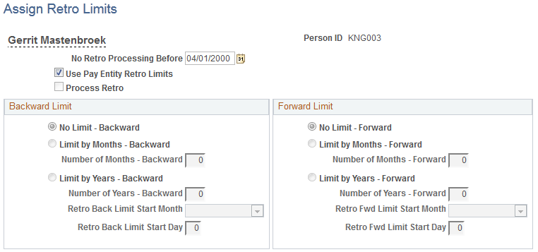

Use the Assign Retro Limits page (GP_PYE_RTO_LIM) to override, at the payee level, the backward and forward limits for retro processing that you established at the pay entity level on the Retro Limits page.
Navigation
Image: Assign Retro Limits page
This example illustrates the fields and controls on the Assign Retro Limits page.
Note: The fields on this page are almost identical to those on the Retro Limits page. To view definitions of the shared fields, return to the section on the Retro Limits page. In this topic we discuss only the fields that are unique to the Retro Limits Assignment page.
| No Retro Processing Before | This date is the date when Absence Management begins processing a payee. It is set by the system, but you can override it. The system cannot process retroactivity for a payee prior to this date. If a payee has multiple jobs, be sure that this date is correct, to support all jobs. |
| Use Pay Entity Retro Limits | Select to use the retro limits that are defined for the pay entity to which the payee belongs. When this check box is selected, the system uses the values from the pay entity definition, and all other fields on this page, other than No Retro Processing Before, are unavailable for entry. When this check box is cleared, the Process Retro check box becomes available for entry, and the system uses the values that were entered at the payee level, rather than those that were entered at the pay entity level. |
| Process Retro | Select if you want retroactivity to be processed. If you select this check box, the fields in the Backward Limit and Forward Limit group boxes become available for data entry. |
